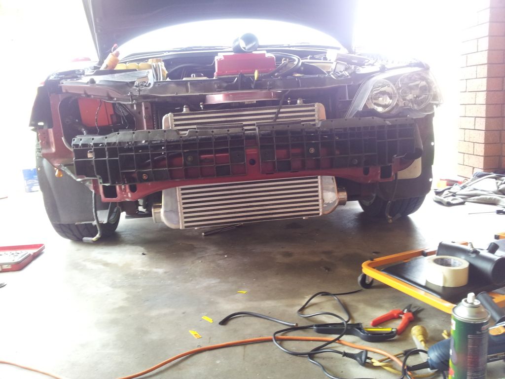

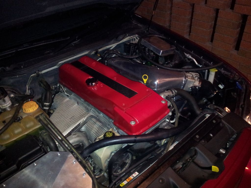

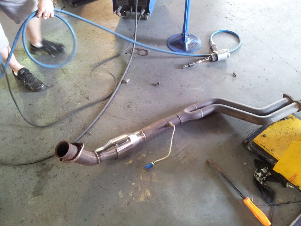

Stazza_Brendan Donating Members 686 Member For: 15y 8m 15d Gender: Male Location: Mackay QLD Posted 01/11/11 10:12 PM Share Posted 01/11/11 10:12 PM After what seems like forever waiting to get a tune as I was waiting for ZF tune to be complete I finally got my ute done. Ran 315kw on 12psi which im definatly impressed with.Engine mods-Stock 07 BF2 motor-100cell cat welded in stock dump-Twin 2.5 redback catback with 3inch tips-Saber intercooler kit that included hotside piping-Rapidsystems coldside piping and UB intake-Bosch 968 42lb injectors-Xcal3Still using standard actuator, standard valvesprings, wastegate flapper and standard fuel pump which seems to be the main limiting factor, But all I wanted was 300kw. Unfortunatly I couldnt get ZF tune done as my box isnt on the supported list yet.Other non engine mods are-Tein coilovers in front-1inch blocks in rear-30mm swaybar up front-18x 8.5 front and 18x 9.5 rear RS-D dished wheels-DBA front slotted rotors and Bendix pads-Ipod video kit on standard premo ICC screen-DashDAQ OBD2 gaugesStandard dump with 3in 3out 100cell cat welded in place. Stock heatsheild on dump was reattached before install. heat sheild is facing that way to sheild gearbox.Pic showing intercooler and CAI. Not your usual setup but only lost 2hp between back to back runs on humid QLD day.Another pic showing piping.Intercooler setup. Made to use standard crossover and intake. But ive since changed it to setup posted up higher. Piping is probably same length or a bit shorter then stock hotside piping. Cooler is twice size of stock cooler.Tein coilovers and 30mm swaybar up front.How it sits now. Just have to drop the back another 15mm which ill be doing soon. Link to comment https://www.fordxr6turbo.com/forum/topic/77619-315kw-bf2-ute/ Share on other sites More sharing options...

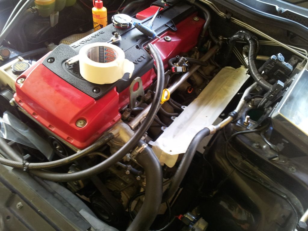

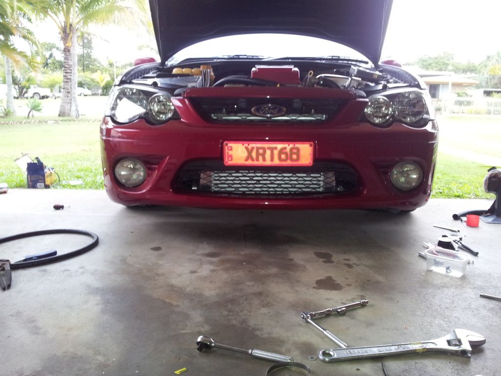

Stazza_Brendan Donating Members 686 Member For: 15y 8m 15d Gender: Male Location: Mackay QLD Posted 06/07/12 09:47 AM Author Share Posted 06/07/12 09:47 AM Things have changed a bit..Rapids V4.5 kit.Still have to get a TPS loom as I got 2 motor looms instead. Hose up the brake booster and breater/catchcan. Also have to sit the nizpro cover down properly.Other mods will be bigger injectors, surge tank (easier then changing utes intank pump) and a 4inch dump. 1 Link to comment https://www.fordxr6turbo.com/forum/topic/77619-315kw-bf2-ute/#findComment-1263856 Share on other sites More sharing options...
