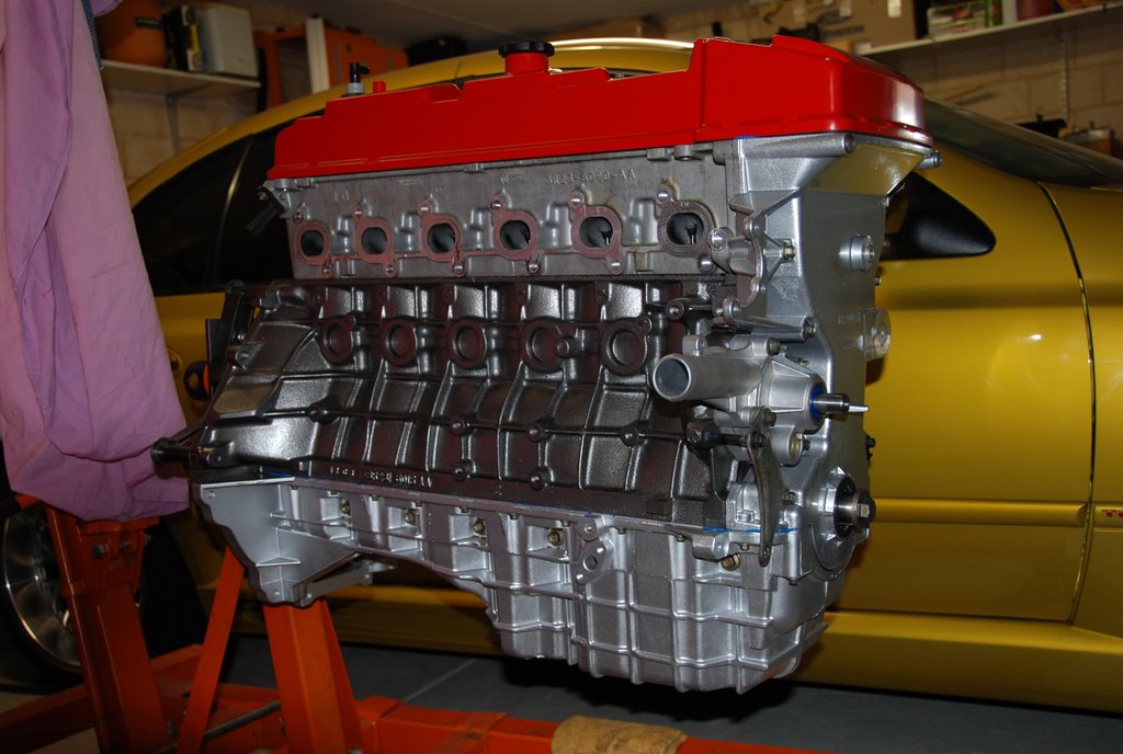

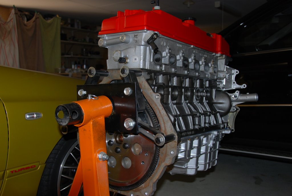

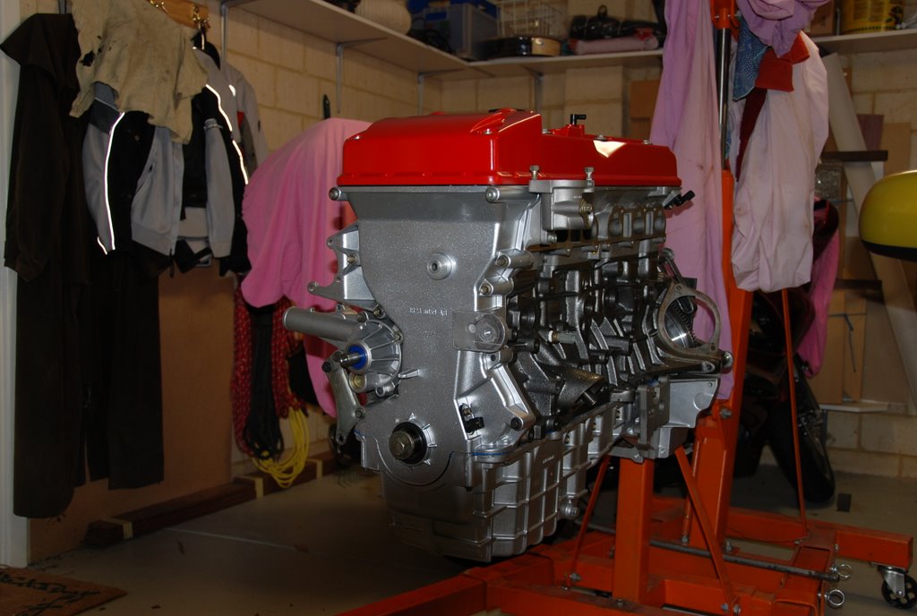

Ninka Donating Members 1,850 Member For: 22y 3m 28d Gender: Male Location: Perth, WA Posted 18/10/11 06:35 AM Author Share Posted 18/10/11 06:35 AM Well, as I have been posting retrospectively to the actual engine build, here are pictures of the finished engine on my engine stand.On the last picture, the heavier flexplate can be seen, well not really a flexplate, more like a flywheel for the auto, as it's so much thicker than the flimsy factory unit.Just need to find the time to do the changeover with engine currently in my car, and then start thinking about what to do with that, as it has a lot of goodies in it as well.Them projects keep being dreamt up Link to comment https://www.fordxr6turbo.com/forum/topic/77388-my-new-engine-build/page/2/#findComment-1150799 Share on other sites More sharing options...
