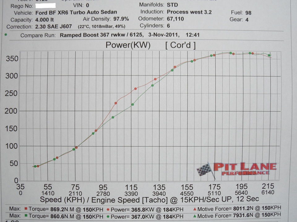

webby324 Donating Members 313 Member For: 14y 8m 10d Gender: Male Location: Yarra Valley Posted 04/11/11 06:40 AM Author Share Posted 04/11/11 06:40 AM Second round of mods just done are:- In tank Walbro Fuel Pump- Process West 3.2 Kit (Stage 3 cooler, piping, battery relo. Turbo side intake).- Process West Surge Tank + 044- Stronger Actuator and Turbo Port- Also got a service and gave the ZF a service as well as replacing new coils at the same time.- Custom TuneAnd the final result was 365rwkw on 16psi and 870nm of torque. I’ve got 2 tunes, one ramping the boost on and the other coming on hard. So far just loving the noise of the intake and havn’t really booted it that much. Spent the whole way home being a Expensive Daewoo driver , haha.Mick from Pitlane – thanks heaps, you’re a legend and great bloke to deal with. Also need to thank Bel for doing all the HARD work ofcourse Now I'm going out for a drive. I'll post pics and dyno sheet in next couple of days. Link to comment Share on other sites More sharing options...

webby324 Donating Members 313 Member For: 14y 8m 10d Gender: Male Location: Yarra Valley Posted 05/11/11 09:20 AM Author Share Posted 05/11/11 09:20 AM (edited) Heres the dyno of both tunes overlapping. Doesn't look like much but theres about 40rwkw in the midrange.Will add pictures of the car when I get a chance to take some. Edited 05/11/11 09:21 AM by webby324 Link to comment Share on other sites More sharing options...
