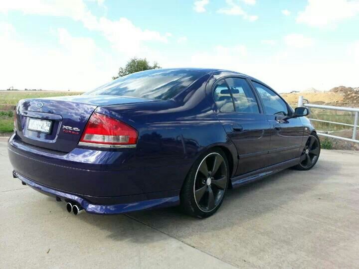

SassizXRTurbo New Member 23 Member For: 10y 11m 15d Gender: Female Location: Horsham Victoria Posted 03/05/14 10:06 PM Share Posted 03/05/14 10:06 PM my 370kw XR6 TurboSent from my GT-I9505 using Tapatalk Link to comment https://www.fordxr6turbo.com/forum/topic/76044-modding-your-fg-xr6-turbo/page/30/#findComment-1469228 Share on other sites More sharing options...
Rab WOT? Moderating Team 10,981 Member For: 12y 1m 24d Gender: Male Location: Frankston, 3199 Posted 03/05/14 11:25 PM Share Posted 03/05/14 11:25 PM Looks good.What works been done?Any further plans? Link to comment https://www.fordxr6turbo.com/forum/topic/76044-modding-your-fg-xr6-turbo/page/30/#findComment-1469245 Share on other sites More sharing options...
