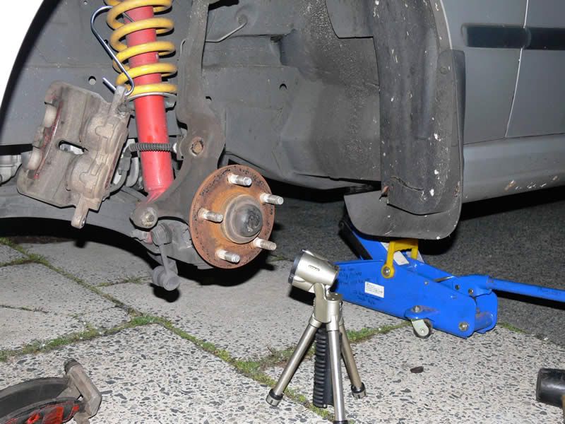

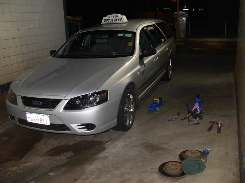

As is the usual situation, I did the changeover in my front yard at night. At least this time it was relatively early (7pm to 10pm) instead of the midnight to 4am jobs that I've done lately. A workshop would be nice, but enough light to see what I'm doing would be enough of a luxury. I've just checked, and the temperature was a lovely 10 degrees Celcius for most of the three hours that it took me to do this job. Oh, and I never wear long pants or a jacket, everything I do is in shorts and t-shirt. Basically, it was bloody cold.

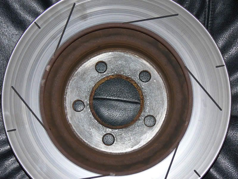

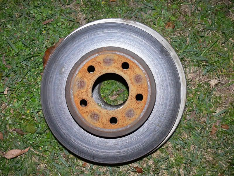

Here is the standard disc rotor (298mm diameter) sitting on the XR6T rotor (322mm). Not a huge difference in size, but every little bit helps. You can see the colouring on the standard disc - a result of how much heat it's copping. I'm tough on brakes, hence my awareness that I need something better than the standard system.

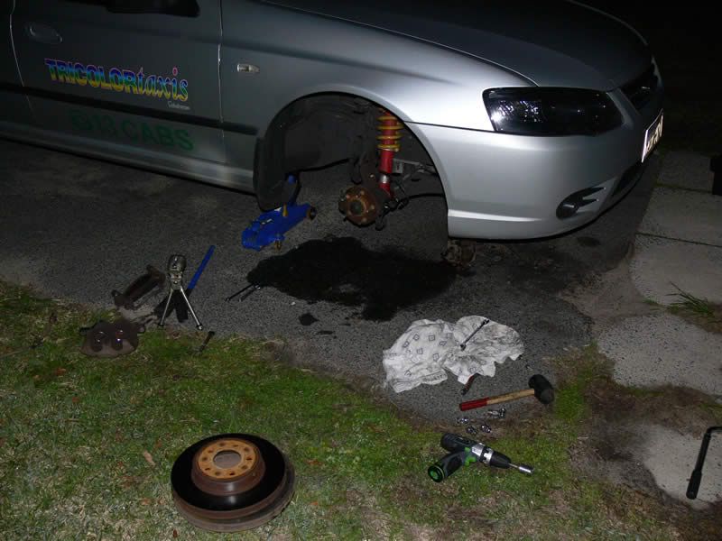

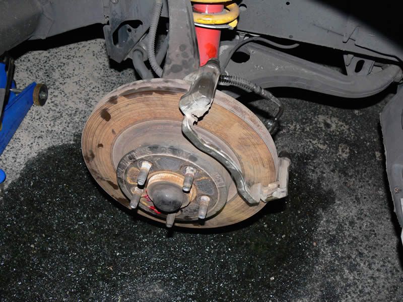

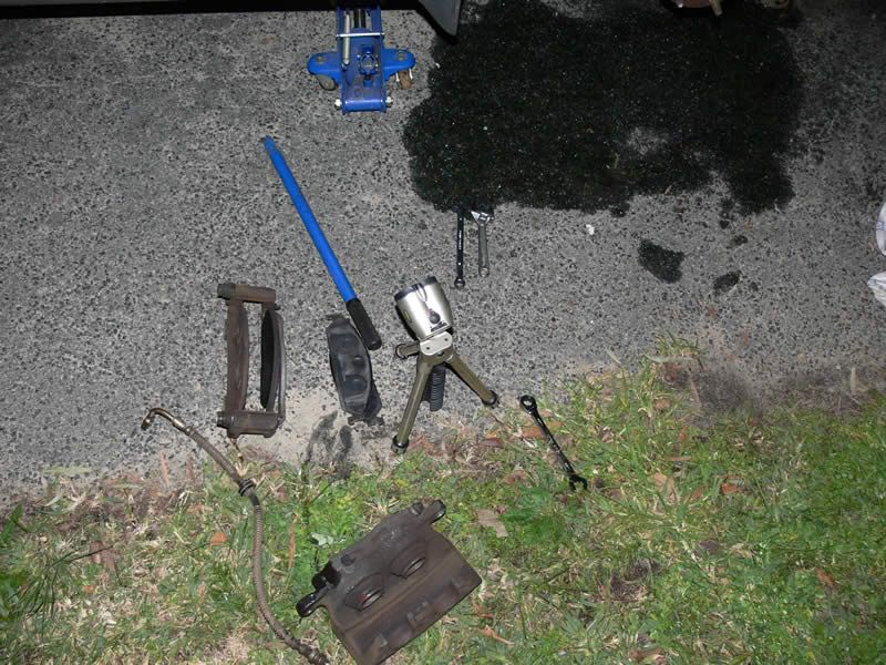

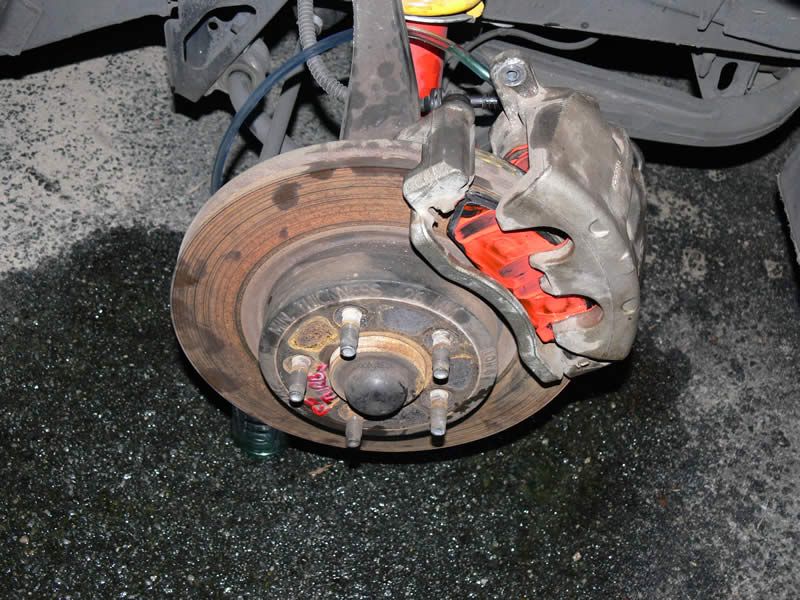

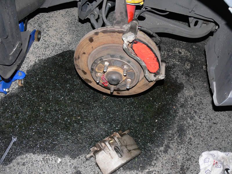

Got it all apart fairly easily but made one huge stuff-up. I didn't think to put anything under the brake hose to catch the fluid. Stupid, stupid, stupid mistake. Naturally, when I did the other side later, I put an oil drain pan under it all and didn't make a mess.
This is how I am often getting things done. Not a good environment for working on a car, but that's what I've got. The electric drill is very useful for getting wheel nuts off quickly - loosen them with a wheel brace and then use the drill and 19mm socket to get the nuts off. You can see the small tripod light that I use to work with. Yep, that's what I do.
I have a bit of an obsession about keeping wheels clean. I clean them regularly on the car, but when they're off the car it is an opportunity to do a thorough job without having to bend down all over the place. I use CT18 degreaser in a weed sprayer bottle and a brush that I bought at Bunnings. Then hose it all off. My interest in keeping my wheels clean is substantially higher than my interest in gardening and lawn maintenance, but CT18 doesn't cause any harm. I've lived in this house for almost 12 years now, and the lawn should by now be completely used to the fact that my care factor for it is extremely low.
The battle scene. Tools and brake parts all over the place.

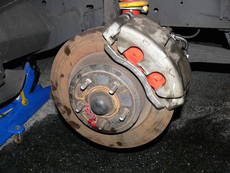

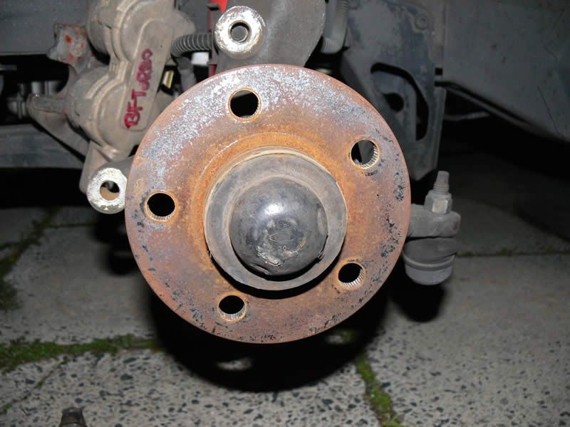

I put the bracket on. That was easy. Then I realised why it was so easy - I'd forgotten to put the disc rotor on first. Idiot. Remove bracket, put rotor on and re-fit bracket. It is possible to fit the entire caliper assembly in one go but its a lot easier to do it piece by piece.

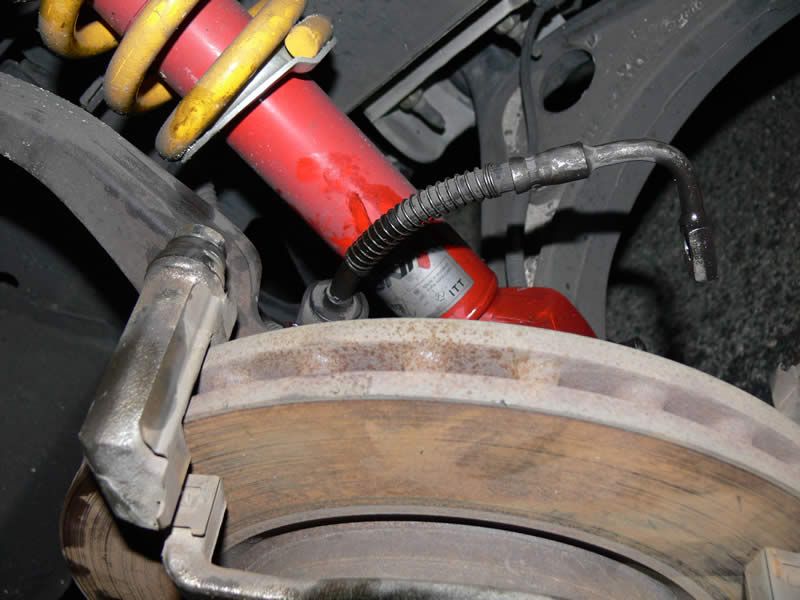

Another photo of the bracket in place, also making sure that the brake hose is in it's holder. Whenever I removed the hose from the holder for something (ie putting the banjo bolt back in) I made sure that I put it back in the holder straight away so that I wouldn't forget later.
I chose to try the Bendix pads that came with the calipers. Before putting the pads in, I coated the back of them with CRC Disc Brake Quiet to reduce the possibility of noise later on. I use a rubber glove for this part, so that I can just peel the glove off and get back to the job once I've applied this stuff.
Got the pads in place, in the bracket. Ready to put the caliper on.

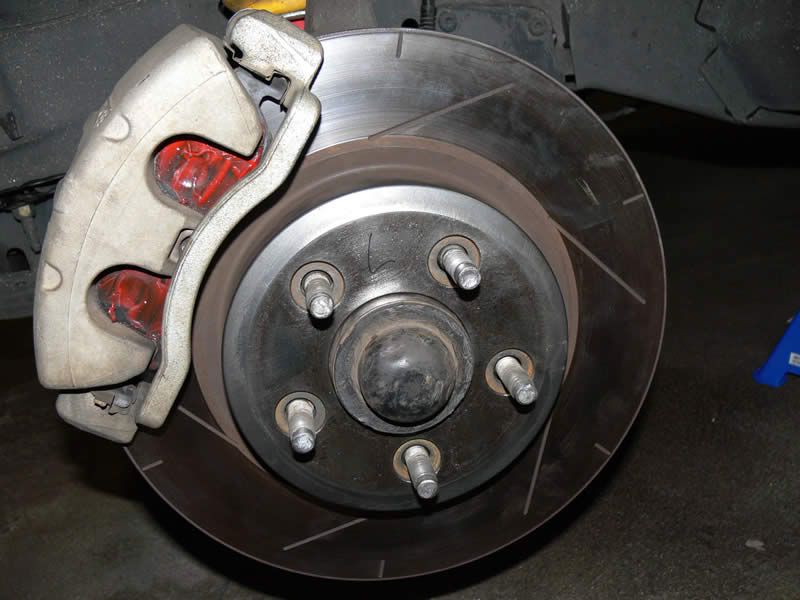

Got the caliper on, and the brake hose bolted back on. My major stuff-up with not catching the brake fluid at the start meant that I was leaving brake fluid marks on things that I touched. I cleaned everything up with an aerosol degreaser before putting the wheel back on.
Thanks to the speed bleeders that I got last week, bleeding the brakes was a simple one-person process. I undid the top bolt on the caliper, so that I could lever it away and make sure that the nipple was at the highest point (so that no air bubbles were left anywhere in the caliper).

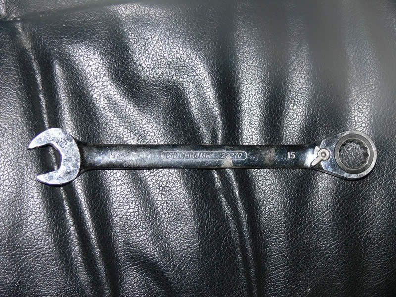

If you're ever going to work on a BA or BF Falcon you are going to need one of these - a 15mm ratchet spanner. The bolts that hold the caliper bracket to the car are a 15mm head, and this spanner makes it easy to undo and do them up. Much easier than messing around trying to fit a ratchet and socket in there. I also use this on the engine oil drain bolt (ie also a 15mm head).

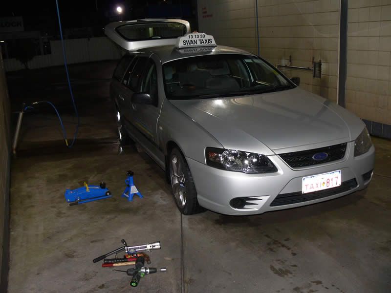

Well done. Thanx for the info.
(Don't take this the wrong way, just me being me. Can't see an axle stand supporting your car. Having had a hydraulic jack 'let go' when I was jacking a car up and seeing more than a tonne of steel smash onto the driveway in a split second is a constant reminder not to put anything under a car that isn't supported on stands - particularly anything made of meat and bone...)
Yep, lessons have learned for next time (as pointed out to me on one of the other forums):
- don’t let any brake fluid leak onto the ground
- put an axle stand under the chassis rail whilst the car is jacked up.
- a turtle jaw clamp could be used on a rubber hose (but not braided), but a rubber cap on the end of the brake line would probably do the job. If nothing else is available, put a small plastic bag over the end and use a small zip tie to hold it on.
- important - spend the time preparing the mating surfaces before putting the disc rotor on.

When I changed the calipers and discs over last week I didn’t clean the hub backing back and disc rotors. There’s been a bit of brake shudder that could be because of this. I also bought some secondhand DBA4000 disc rotors over the weekend, which are slotted and a much higher quality disc. So, tonight I had a go at doing the things that I didn't do last week and fit the DBA rotors at the same time.
I chose to try cleaning the relevant surfaces with an electric drill and wire brush instead of the usual emery cloth sandpaper. I already had the electric drill (Ozito LIR-012 which cost $90 from Bunnings) and bought a set of wire brushes for the job. After trying out different ones I found that one brush did pretty much everything.

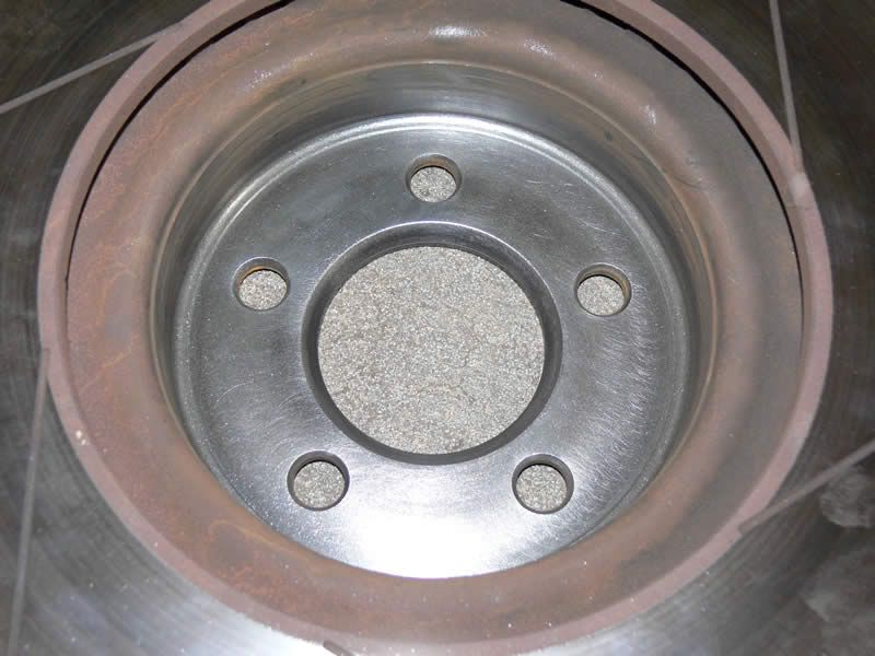

The first task was to clean the inside of the disc rotors. It didn't look particularly bad on this one but I had a go anyway.
The wire brush made a huge difference, resulting in the inside of the rotor hat being spotless. I made sure that the inner ring was also clean, and this is what centres on the spigot (ie middle of the hub).

I knocked the studs out with a hammer. Rather than stuff around getting around the studs, I wanted full access to the backing plate.
It was starting to look a lot better, then my organised night suddenly became very disorganised. The battery in the drill went flat, so I went and got the spare. Which also turned out to be flat. Oh dear. Lots of cursing ensued as I realised that I would have to leave one of the batteries on charge for at least a couple of hours before I could resume. When I did get back to it almost three hours later, it was drizzling rain. The best laid plans of mice and men…
When I finally did get back to it the night had gotten very cold. This meant that the backing plate had shrunk a bit and I couldn't get the wheel studs back in. I didn't have anything suitable to heat the backing plate up enough so that the studs would knock back in properly (a butane lighter didn't help). I even tried putting the wheel studs in the freezer for half an hour, hoping that they would shrink enough to fit back in. Nup, that failed to.
By now I was starting to panic. I had a car in pieces in my front yard and possibly couldn't get it back together again. The only option was to get the studs in as far as I could and put the wheel back on. Hopefully tightening the wheel nuts up would pull the studs through. By now I had given up on fitting the DBA4000 rotors and the priority became getting the car mobile again.

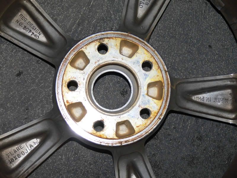

The inside of the wheel before cleaning.
The electric drill and wire brush did a very good job.

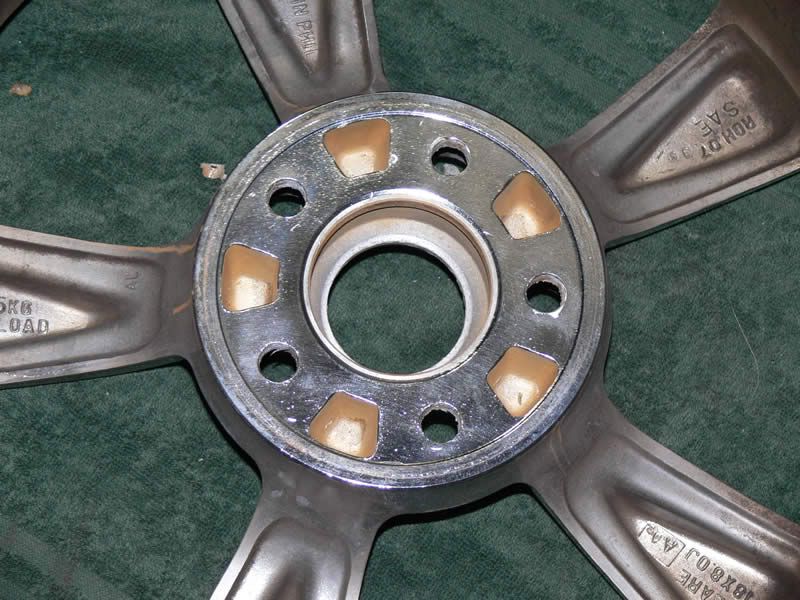

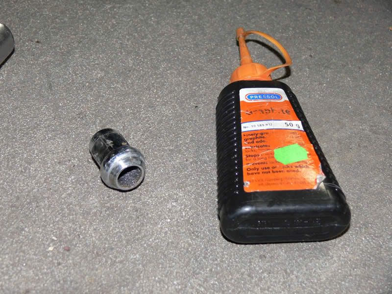

While I was doing this I figured I might as well put some graphite power in each of the wheel nuts. This is a dry lubricant and will help the wheel nuts to rotate on and off when the time comes to change a flat tyre on the side of the road somewhere. I recently found a screw stuck in one of my new tyres and to prevent damaging the tyre I fitted the spare. From start to finish, I did it in just under six minutes, which I thought wasn't bad for a roadside tyre change.

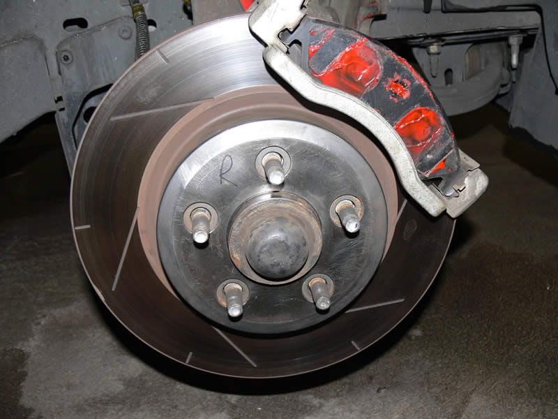

This is the left side back in one piece. You can see that I had done my homework earlier and marked on each disc which side it was for. You can also see that I cleaned the outside of the rotor hat to ensure that there was nothing to put the wheel off centre.
The right side ready to have the wheel put back on.
The wheel back in place. The slots can be seen.
