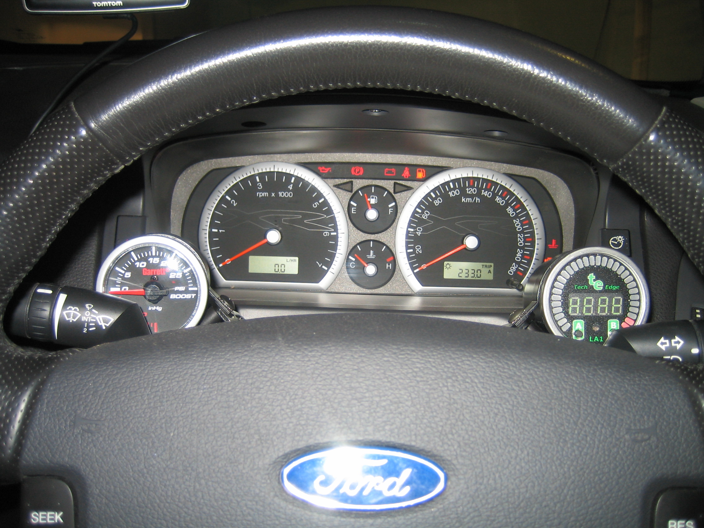

Ralph Wiggum Moar Powar Babeh Lifetime Members 19,332 Member For: 19y 8m 15d Gender: Male Location: Perth Posted 21/06/11 06:19 AM Share Posted 21/06/11 06:19 AM I used to have my eboost mounted down there. found it very distracting and the time it took to glance down and back up at the road was long enough to be a concern. I've not seen any ready made gauge holders that would fit there either.Have you thought about 2 gauge cup on top of the steering column? Very easy too see and very easy to install. I currently have my boost and Wideband gauges mounted there Link to comment https://www.fordxr6turbo.com/forum/topic/75433-tissue-tray-gauge-pod/#findComment-1116088 Share on other sites More sharing options...

Ralph Wiggum Moar Powar Babeh Lifetime Members 19,332 Member For: 19y 8m 15d Gender: Male Location: Perth Posted 21/06/11 11:44 AM Share Posted 21/06/11 11:44 AM As mentioned my gauge set up currently Link to comment https://www.fordxr6turbo.com/forum/topic/75433-tissue-tray-gauge-pod/#findComment-1116230 Share on other sites More sharing options...

Ralph Wiggum Moar Powar Babeh Lifetime Members 19,332 Member For: 19y 8m 15d Gender: Male Location: Perth Posted 22/06/11 07:46 AM Share Posted 22/06/11 07:46 AM On 22/06/2011 at 6:22 AM, osonvs said: Where did you did the steering column gauge holder from?????They are just regular Autometer Rollcage mounting Cups. Two screws and a bit of foam to stop any squeaks. The roll cage mounts have a small groove pressed into them to help align them with the tube, this sits very nicely on the corner radius of the top steering column shroud Link to comment https://www.fordxr6turbo.com/forum/topic/75433-tissue-tray-gauge-pod/#findComment-1116410 Share on other sites More sharing options...
