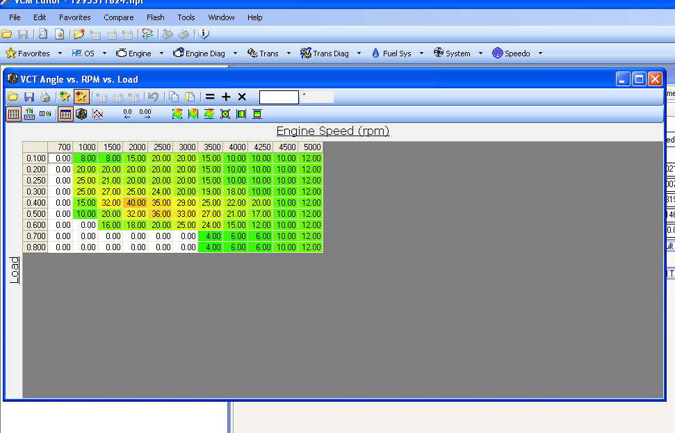

Ralph Wiggum Moar Powar Babeh Lifetime Members 19,331 Member For: 19y 6m 20d Gender: Male Location: Perth Posted 21/06/11 10:11 AM Share Posted 21/06/11 10:11 AM Actually goes the other way mate starts retarded down low and advances up high. The cam timing is worth the effort. A bit of tweaking can improve spool rpm and also boost torque in the midrange.What haltec do you have? are you sure it cant support VCT? Dont just look for VCT look for Aux outputs that can support PWM.Personally I would just run a ford PCM as this has all the flexibility you'l need(screeb shot from a BF F6 tune)Edit:MR 4.0 is correct, its advancded down low and retarded up high! Link to comment https://www.fordxr6turbo.com/forum/topic/75415-unplugging-the-vct-result/page/2/#findComment-1116183 Share on other sites More sharing options...

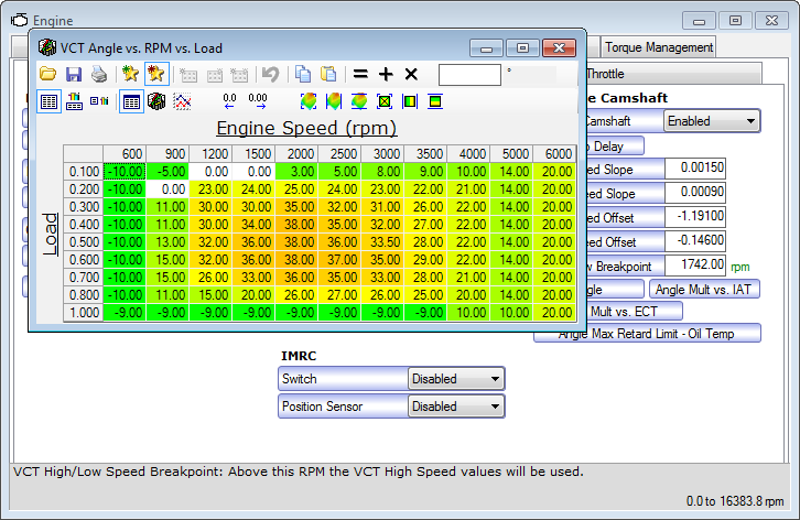

4LEDboy Member 11 Member For: 14y 8m 22d Posted 21/06/11 12:43 PM Author Share Posted 21/06/11 12:43 PM (edited) Its an E8, it has PWM outputs that are available for the VCT, I was going to leave them out but if it will make a noticable difference then we can give it a shot Heres a screenshot of the VCT settings. Edited 21/06/11 12:45 PM by 4LEDboy Link to comment https://www.fordxr6turbo.com/forum/topic/75415-unplugging-the-vct-result/page/2/#findComment-1116250 Share on other sites More sharing options...
Ralph Wiggum Moar Powar Babeh Lifetime Members 19,331 Member For: 19y 6m 20d Gender: Male Location: Perth Posted 21/06/11 01:29 PM Share Posted 21/06/11 01:29 PM Looks like you have everything you need there mate! I can't log cam solenoid Duty Cycle. If SCT can you could get some good info from somebody running anX-Cal 2. Otherwise just play with it.If you want any other info from HPT's cams tables pm me an email address Link to comment https://www.fordxr6turbo.com/forum/topic/75415-unplugging-the-vct-result/page/2/#findComment-1116262 Share on other sites More sharing options...
Mr_4.0 Member 1,096 Member For: 14y 2m 24d Posted 21/06/11 04:59 PM Share Posted 21/06/11 04:59 PM Retarding down low and advancing up high makes no sense!If anyone has ever played with cam timing in a car they would understand that advancing gives better low end performance and retarding moves the power band up. Link to comment https://www.fordxr6turbo.com/forum/topic/75415-unplugging-the-vct-result/page/2/#findComment-1116272 Share on other sites More sharing options...
Ralph Wiggum Moar Powar Babeh Lifetime Members 19,331 Member For: 19y 6m 20d Gender: Male Location: Perth Posted 21/06/11 09:41 PM Share Posted 21/06/11 09:41 PM Best ring Ford and let them know that mate as that's a factory BF table. I can tell you from my own experience that more retard down low = more boost soonerMR 4.0 is on the money! -ve #'s are advance not retard....... Link to comment https://www.fordxr6turbo.com/forum/topic/75415-unplugging-the-vct-result/page/2/#findComment-1116290 Share on other sites More sharing options...

Ralph Wiggum Moar Powar Babeh Lifetime Members 19,331 Member For: 19y 6m 20d Gender: Male Location: Perth Posted 22/06/11 04:47 AM Share Posted 22/06/11 04:47 AM Base cam timing table from an NA 5.4 ltr V8 Link to comment https://www.fordxr6turbo.com/forum/topic/75415-unplugging-the-vct-result/page/2/#findComment-1116358 Share on other sites More sharing options...

Mr_4.0 Member 1,096 Member For: 14y 2m 24d Posted 22/06/11 01:11 PM Share Posted 22/06/11 01:11 PM are those figures degrees? or angle? or what?Speaking from my own experience with NA 6 cyl falcons, retarding the cam pushes the power band higher in rev range, and advancing bring the power band down.Surely those figures are not the amount of degrees the cam varies? 10 degrees is enough in some cars to bring on bad P/V clearance issues. Link to comment https://www.fordxr6turbo.com/forum/topic/75415-unplugging-the-vct-result/page/2/#findComment-1116562 Share on other sites More sharing options...
