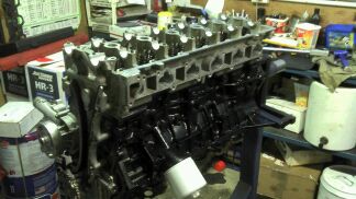

qik1 Silver Donating Members 2,720 Member For: 17y 1m 13d Gender: Male Location: Loitering in SEQ Posted 11/10/13 12:49 PM Author Share Posted 11/10/13 12:49 PM (edited) We had a little accident that caused it too drop a couple of valves, nothing major. We weren't far off removing the head anyway to do the same work that we've just done to it. While the head was off to repair what we had to we thought we'd just do the right thing & check everything over & freshen it up before it copped a hiding with the haltech fitted & because as ya know once the heads off it's buggar all to pull the short out. When it got stripped down we found what we found. And yes Tony is/has built the new engine. The only parts we retained were the rods, girdle, headstuds & oil pump everything was a right off or not fit for purpose. We finally have some major progress with it all. The head is all bar complete, the porting is all done & most parts are here but we've decided on some anti pump lifters cause of the setup we now have but that wont put us too far behind. We also recieved the long awaited throttle controller so it's full steam ahead with everything. Edited 11/10/13 12:50 PM by qik1 1 Link to comment https://www.fordxr6turbo.com/forum/topic/75138-fpt-6boost-go-735-plus-kw-still-climbing/page/68/#findComment-1432318 Share on other sites More sharing options...
2MUCHKW Member 350 Member For: 19y 2m 5d Posted 12/10/13 04:56 AM Share Posted 12/10/13 04:56 AM On 11/10/2013 at 12:49 PM, qik1 said: We had a little accident that caused it too drop a couple of valves, nothing major. We weren't far off removing the head anyway to do the same work that we've just done to it. While the head was off to repair what we had to we thought we'd just do the right thing & check everything over & freshen it up before it copped a hiding with the haltech fitted & because as ya know once the heads off it's buggar all to pull the short out. When it got stripped down we found what we found. And yes Tony is/has built the new engine. The only parts we retained were the rods, girdle, headstuds & oil pump everything was a right off or not fit for purpose.new eng.jpgWe finally have some major progress with it all. The head is all bar complete, the porting is all done & most parts are here but we've decided on some anti pump lifters cause of the setup we now have but that wont put us too far behind. We also recieved the long awaited throttle controller so it's full steam ahead with everything. Why the change to CP pistons?Are they a better design compared to the Atomic Cosworth pistons for your application? 1 Link to comment https://www.fordxr6turbo.com/forum/topic/75138-fpt-6boost-go-735-plus-kw-still-climbing/page/68/#findComment-1432436 Share on other sites More sharing options...
qik1 Silver Donating Members 2,720 Member For: 17y 1m 13d Gender: Male Location: Loitering in SEQ Posted 12/10/13 07:43 AM Author Share Posted 12/10/13 07:43 AM (edited) Absolutely, with a larger skirt it'll help with better cylinder wall load distribution under high load, they have valve reliefs, we could customise the tops to gain some comp back. There a specifally designed high boost piston and to top it off we chose our own over size which is very minimal and there a fraction of the cost of the cosworths. Edited 12/10/13 07:44 AM by qik1 Link to comment https://www.fordxr6turbo.com/forum/topic/75138-fpt-6boost-go-735-plus-kw-still-climbing/page/68/#findComment-1432467 Share on other sites More sharing options...

2MUCHKW Member 350 Member For: 19y 2m 5d Posted 13/10/13 04:42 AM Share Posted 13/10/13 04:42 AM (edited) On 12/10/2013 at 7:43 AM, qik1 said: Absolutely, with a larger skirt it'll help with better cylinder wall load distribution under high load, they have valve reliefs, we could customise the tops to gain some comp back. There a specifally designed high boost piston and to top it off we chose our own over size which is very minimal and there a fraction of the cost of the cosworths.Thanks for the info regarding your decision to use CP Pistons in your new engine.What do you mean when you say "we found what we found"??????Did you discover oiling issues in your old bottom end as well???? Edited 13/10/13 04:45 AM by 2MUCHKW Link to comment https://www.fordxr6turbo.com/forum/topic/75138-fpt-6boost-go-735-plus-kw-still-climbing/page/68/#findComment-1432694 Share on other sites More sharing options...
qik1 Silver Donating Members 2,720 Member For: 17y 1m 13d Gender: Male Location: Loitering in SEQ Posted 13/10/13 06:23 AM Author Share Posted 13/10/13 06:23 AM Sorry mate due to potential action we're taking I can't discuss that side of things. Anything about the new build or the car in general im more than happy to talk about it and divulge what we're up to. Link to comment https://www.fordxr6turbo.com/forum/topic/75138-fpt-6boost-go-735-plus-kw-still-climbing/page/68/#findComment-1432720 Share on other sites More sharing options...
