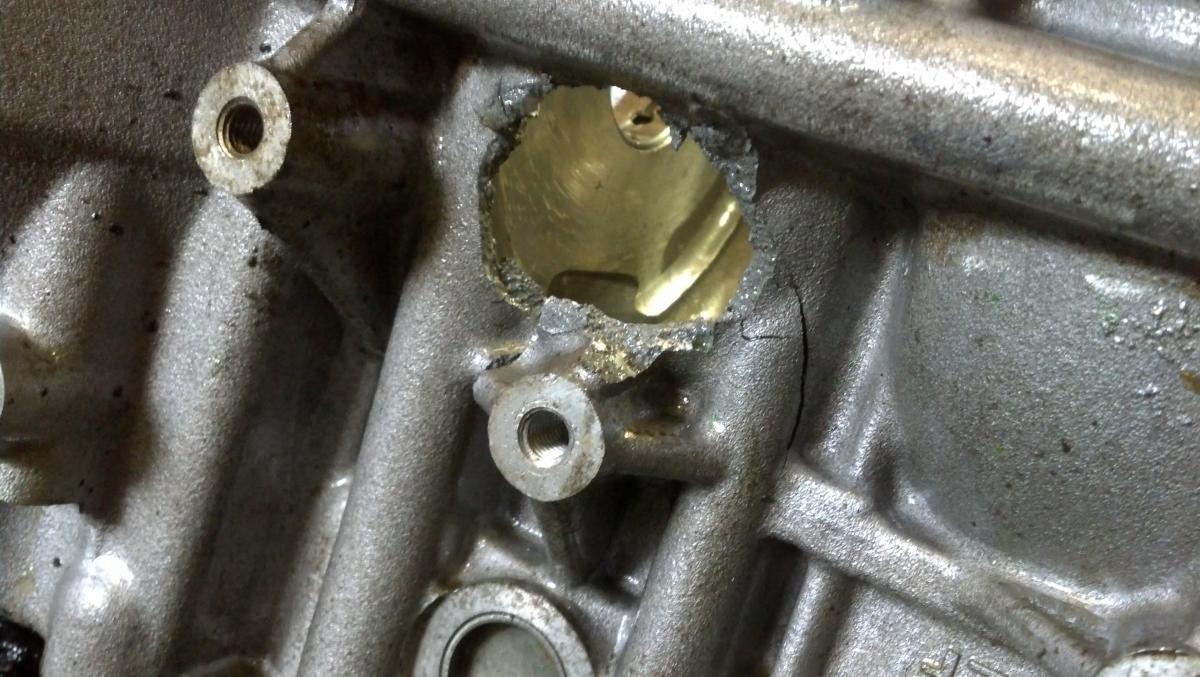

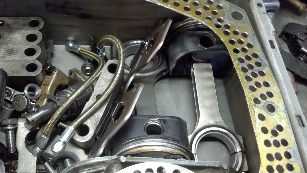

SLY6T Donating Members 585 Member For: 17y 10m 11d Gender: Male Location: vic , melb SE Posted 19/10/12 05:31 AM Author Share Posted 19/10/12 05:31 AM The aftermath. Cause = a cross drilled gallery crank pin fell out then went though evering thing. Then port holes. Def not as big as the last one. Link to comment https://www.fordxr6turbo.com/forum/topic/74423-sr20broken-rod-bolt-fail/page/3/#findComment-1311429 Share on other sites More sharing options...

SLY6T Donating Members 585 Member For: 17y 10m 11d Gender: Male Location: vic , melb SE Posted 19/10/12 05:50 AM Author Share Posted 19/10/12 05:50 AM Oh lol if any wants to know were the big end is. It went through the sump and is sum where around phillip il. Link to comment https://www.fordxr6turbo.com/forum/topic/74423-sr20broken-rod-bolt-fail/page/3/#findComment-1311435 Share on other sites More sharing options...
