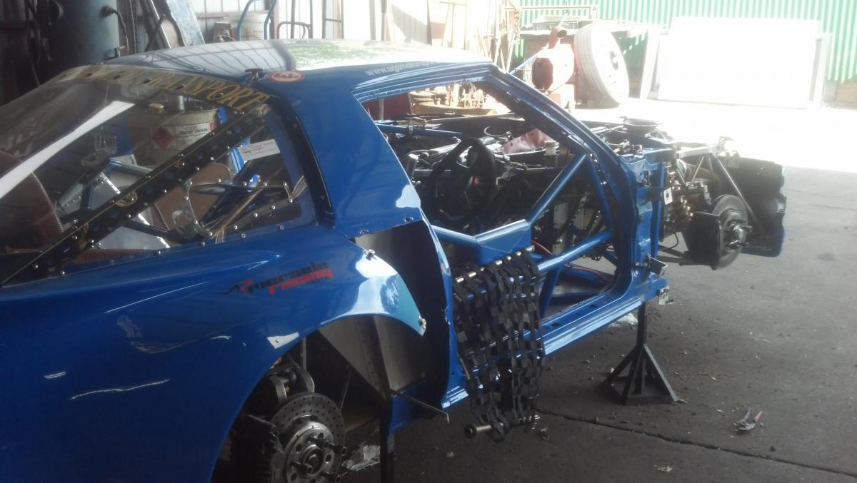

SLY6T Donating Members 585 Member For: 17y 10m 11d Gender: Male Location: vic , melb SE Posted 15/10/12 07:14 PM Author Share Posted 15/10/12 07:14 PM Basically it happened again last sunday at the island. A big let go. Port hole in block and smashed the dry sump. Just took a few pics yesty . Motor comes out this week and pulled apart. Il take more pics of the bloodbath. Gunna be bad.might get another display av outof it . Link to comment https://www.fordxr6turbo.com/forum/topic/74423-sr20broken-rod-bolt-fail/page/2/#findComment-1309846 Share on other sites More sharing options...

rbjet Skid Machine Donating Members 1,640 Member For: 14y 18d Gender: Male Posted 15/10/12 09:51 PM Share Posted 15/10/12 09:51 PM Seems like you haven't had any luck this year. Have you gotten any closer to working out what the cause is.Weird that it happened twice. What did you change between the two builds? Link to comment https://www.fordxr6turbo.com/forum/topic/74423-sr20broken-rod-bolt-fail/page/2/#findComment-1309886 Share on other sites More sharing options...
senna_T Forged Member Lifetime Members 15,818 Member For: 18y 4m 4d Gender: Male Location: SW Sydney Posted 15/10/12 10:16 PM Share Posted 15/10/12 10:16 PM Phillip Island has a lot of high speed corners, what sort of dry sump setup are you running? Could be an oil distribution issue... Link to comment https://www.fordxr6turbo.com/forum/topic/74423-sr20broken-rod-bolt-fail/page/2/#findComment-1309894 Share on other sites More sharing options...
SLY6T Donating Members 585 Member For: 17y 10m 11d Gender: Male Location: vic , melb SE Posted 15/10/12 10:20 PM Author Share Posted 15/10/12 10:20 PM Was not a rod bolt this time. Sorry should have cleared it up. Race one saturday we did a main bearing. My dad took the route then of rebuilding the engine at the track ready for Sunday. New rods, pistons ect. All good did race 2 no probs then went out in the 3rd did 1 lap and bang!!!. Might be a piston or rod problem. One of the probs is the motors worked to the hills of a na sr20. Chit happens I guess doing massive revs for ling times. Ant no drag car. Link to comment https://www.fordxr6turbo.com/forum/topic/74423-sr20broken-rod-bolt-fail/page/2/#findComment-1309895 Share on other sites More sharing options...
SLY6T Donating Members 585 Member For: 17y 10m 11d Gender: Male Location: vic , melb SE Posted 16/10/12 12:04 AM Author Share Posted 16/10/12 12:04 AM Senna. One of those 5-6 stage billet jobbies. Dunno the brand my old man and bro sort that out but its top if the range with a massive nascar oiltank with a in built heater. Its trick as. Link to comment https://www.fordxr6turbo.com/forum/topic/74423-sr20broken-rod-bolt-fail/page/2/#findComment-1309925 Share on other sites More sharing options...
