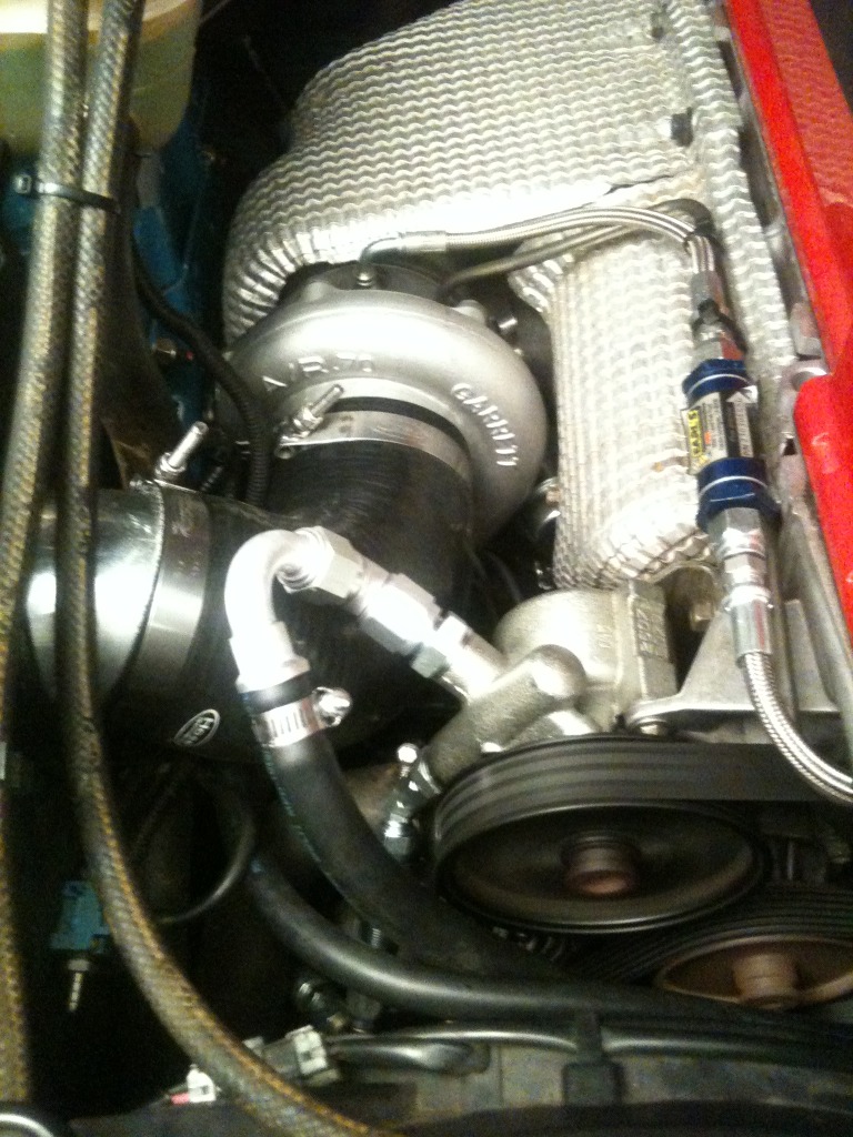

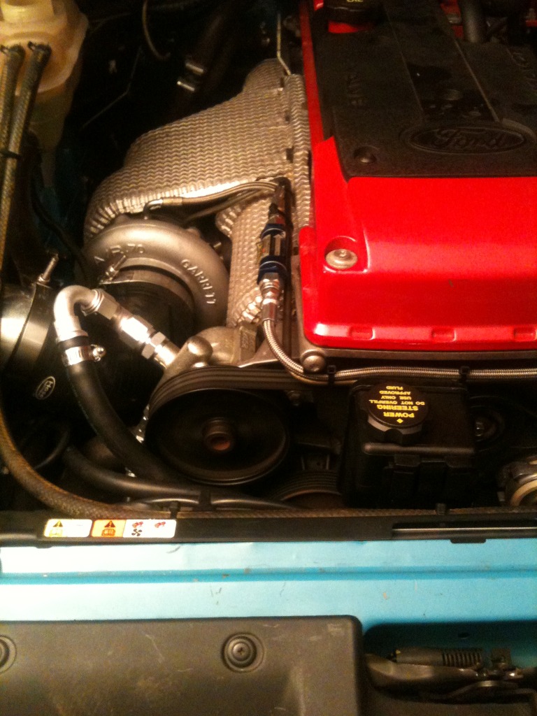

Ralph Wiggum Moar Powar Babeh Lifetime Members 19,331 Member For: 19y 6m 23d Gender: Male Location: Perth Posted 18/04/11 10:35 AM Share Posted 18/04/11 10:35 AM While they say its a straight fit, too get it too fit properly(well what i consider properly) without the intake rubbing on the back of the power steering reservoir is a little more complex. Especialy if you want too run a Nizpro or similar AirboxI wound up relocating the power steering tank, modifying the power steering, supply, return and pressure lines and modded the pump too suit the extended inlet hose.Im very happy with the setup on my car. I can happily see 18psi @ 3k in 4th gear, and its taken alot of work too get the gate too flow enough and too get the Eboost im using setup right, otherwise instantaneous 24psi is on the cards. Link to comment https://www.fordxr6turbo.com/forum/topic/74360-gcg-turbo-upgrade/#findComment-1097896 Share on other sites More sharing options...

Anthony Member 49 Member For: 17y 3m 30d Posted 19/04/11 03:08 AM Author Share Posted 19/04/11 03:08 AM On 18/04/2011 at 10:35 AM, hiddeous said: While they say its a straight fit, too get it too fit properly(well what I consider properly) without the intake rubbing on the back of the power steering reservoir is a little more complex. Especialy if you want too run a Nizpro or similar AirboxI wound up relocating the power steering tank, modifying the power steering, supply, return and pressure lines and modded the pump too suit the extended inlet hose.Im very happy with the setup on my car. I can happily see 18psi @ 3k in 4th gear, and its taken alot of work too get the gate too flow enough and too get the Eboost im using setup right, otherwise instantaneous 24psi is on the cards.Hello Hiddeous,It seems your turbo is modded more than what GCG do as you have a .70 comp housing. who done your turbo mod. im leaning toward the .70 comp housing way even though things need modding. Link to comment https://www.fordxr6turbo.com/forum/topic/74360-gcg-turbo-upgrade/#findComment-1098050 Share on other sites More sharing options...
