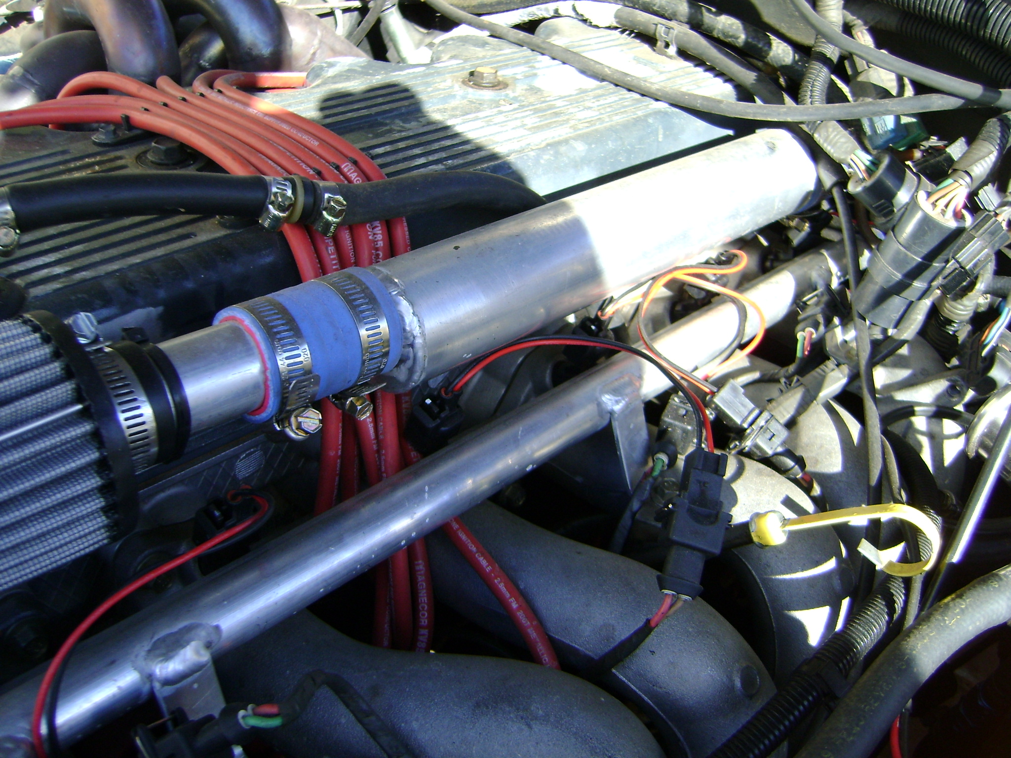

turbotrana Member 2,586 Member For: 22y 2m 27d Gender: Male Posted 17/02/11 09:11 AM Share Posted 17/02/11 09:11 AM The holes vary from engine to engine. In the N/a six as shown in your pic its the middle one that leads to the inlet that is the one you would need to enlarge. Sorry, I thought that might throw you off after I posted but did not have time to correct. At least it shows you read the post. I can show you a picture on a E series engine and the principle is the same on all engines.To explain, there is a 1 inch tube welded to the rear of the rocker cover. This then leads to an oil catch can. In this case that long tube has baffles,tubes and stainless steel mesh to catch blowby oil under load. On the end of it is a filter but you can have a hose leading back to the inlet to comply with emissions. The tube is located where it is so that upon shutdown the oil collected drains back into the engine.Also on the PVC side I have another metal catchcan located under the manifold to catch any oil when cruising. This is all done to keep oil out of the inlet track and minimise any detonation on high boost.In your case you are worried about the dipstick blowing out so you need to address the nonpcv side if you want it to stop blowing. It also helps minimise engine oil leaks also. Link to comment https://www.fordxr6turbo.com/forum/topic/73308-pvc-valve-too-much-pressure-in-crankcase/page/2/#findComment-1081866 Share on other sites More sharing options...
zayd687 Member 74 Member For: 15y 5m 15d Posted 17/02/11 09:35 AM Author Share Posted 17/02/11 09:35 AM (edited) On 17/02/2011 at 6:02 AM, PHANTMXR6 said: Mate, no offence, but it doesn't sound like you're too mechanically savy.You should take it to a mechanic and fill them in on the details and get it diagnosed properly.well its definitely learning curve, this was my first turbo conversion in my backyard. for a 22 year old that works as an office bitch I reckon I did orite installing a turbo/stage 2 cams on my falcon. yet the simplest things always confuse me sigh*who knows if it'll blow up but that's what u guys are here for ! =)Hawlass - have checked all hoses for blockage and nothing returned it to stock got some blow by in it a little bit only but the intake was very oily most likely from the vapors itself.ian -im in nsw/sydney.Turbotran - ahhh now I understand completely thanks for taking the time to clarify it further for me. I'll just use your idea and weld up a larger pipe on it and hose it to the catch can with baffle then back to the inlet. so im just really increasing the diametre of the pipe so it releases more pressure. thinks I got it... not sure how ill go with welding a pipe there.. im useful with a mig as far as fences go but ill give it a shot.... thanks for the explanation. if I had no ideas I was going to stick a 12v electric crankcase pump or something from the us and use that to vacumn the fumes and then vent it. stupid idea but luckily this one came up... once again thanksshould I still check the compression of the vehicle and do leak down tests ? Edited 17/02/11 09:46 AM by zayd687 Link to comment https://www.fordxr6turbo.com/forum/topic/73308-pvc-valve-too-much-pressure-in-crankcase/page/2/#findComment-1081881 Share on other sites More sharing options...
