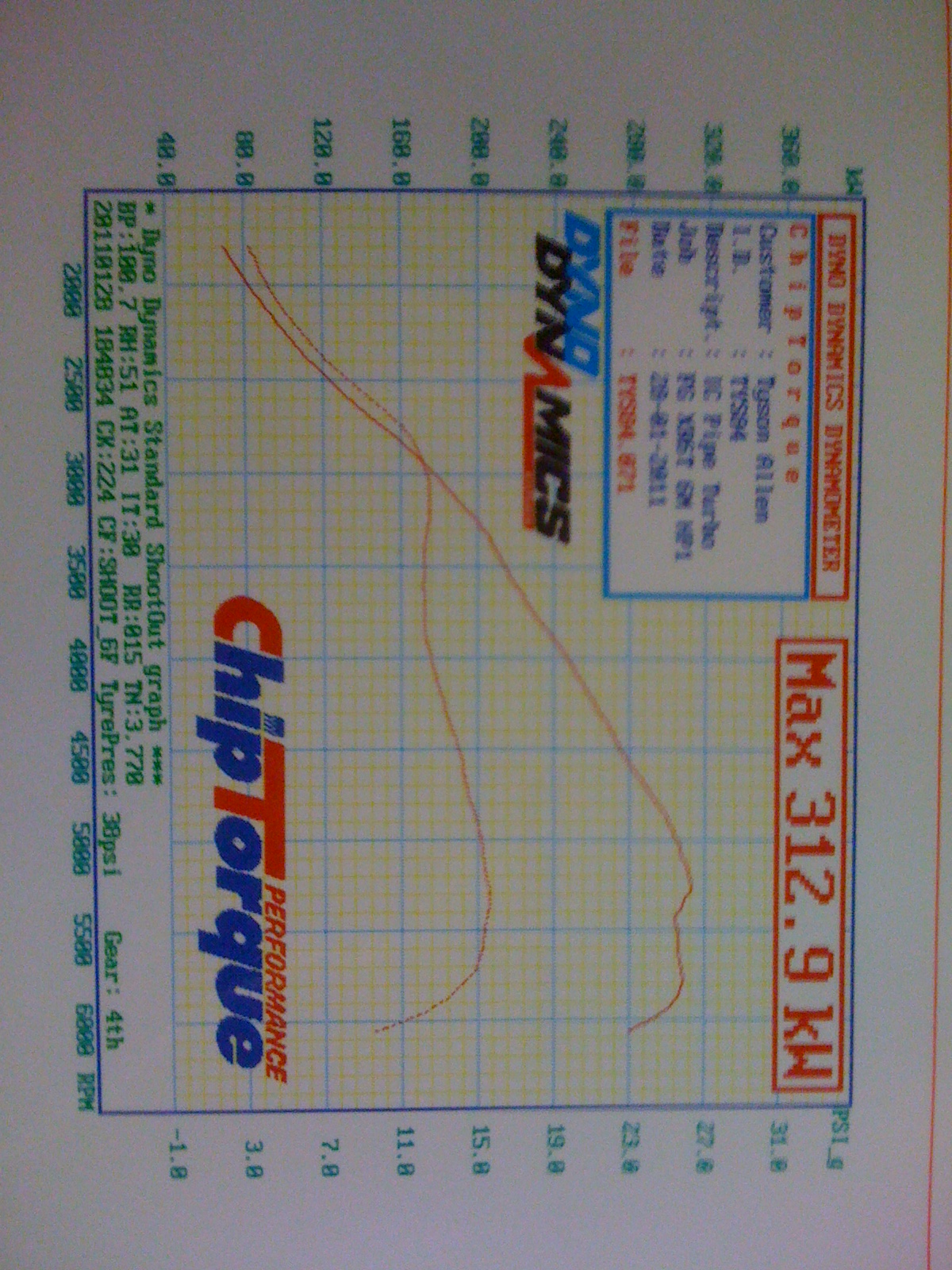

TYS84 Member 57 Member For: 16y 22d Gender: Male Location: Brisbane Posted 31/01/11 11:04 AM Author Share Posted 31/01/11 11:04 AM Hi kvbabyTo be honest if I had the chance to do this Mod again I would have gone about it a little differently.Chiptourqe have done all the work to my car. I changed from my stock turbo as the waste gate flapper was catching and not closing properly. I tried to have this fixed yet it keep doing it. So with time restraints I opted for the bigger turbo, however this all happened when the guy I deal with reguarly was on holidays, hence with my lack of knowledge and him not being there the upgraded actuator was not installed.The list of Mods you mentioned I know I need to do. I was going to do the intercooler before the turbo but it but this happened.Attached is the dyno graph that shows you the Boost levels up to about 5500RMP. You can see after 5000RPM the difference.Thank youSorry kvbaby the write grpah is below.Thanks Link to comment Share on other sites More sharing options...
Kv! Donating Members 1,132 Member For: 14y 11m 25d Gender: Male Location: Eastern Suburbs, Melbourne Posted 31/01/11 12:03 PM Share Posted 31/01/11 12:03 PM That makes sense mate, but yeh get all the things listed, the car will be much better off.Is it just me or is that a fk load of boost for the stock 35/40? Link to comment Share on other sites More sharing options...
