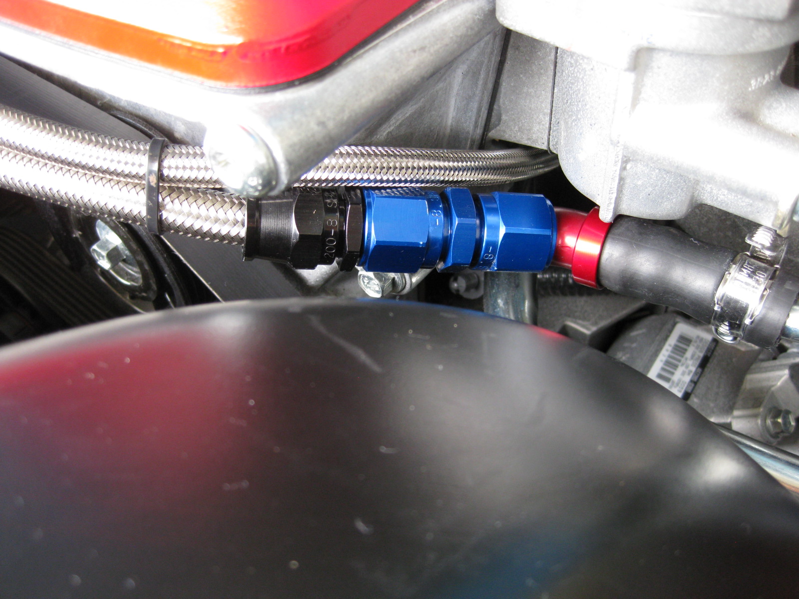

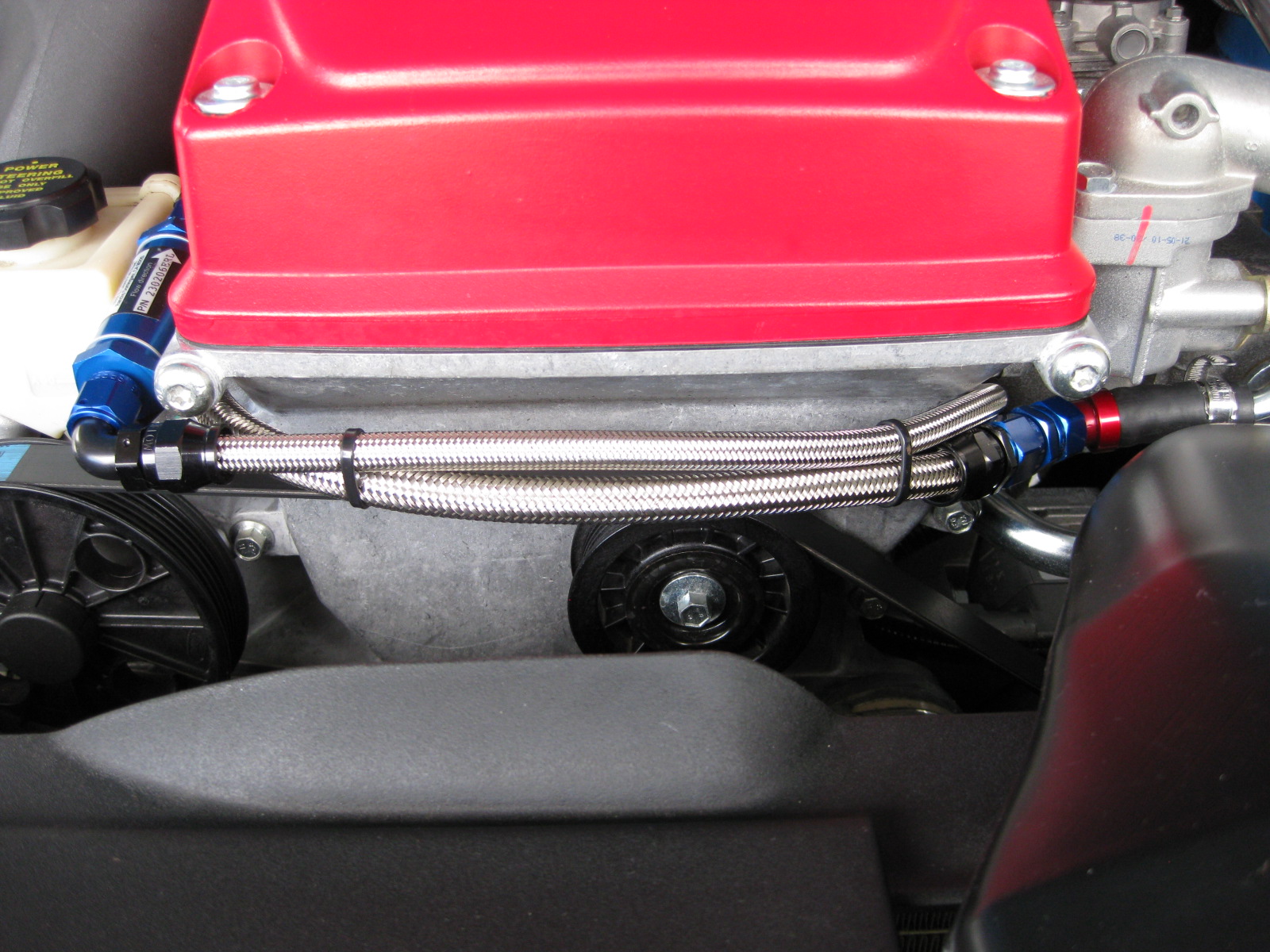

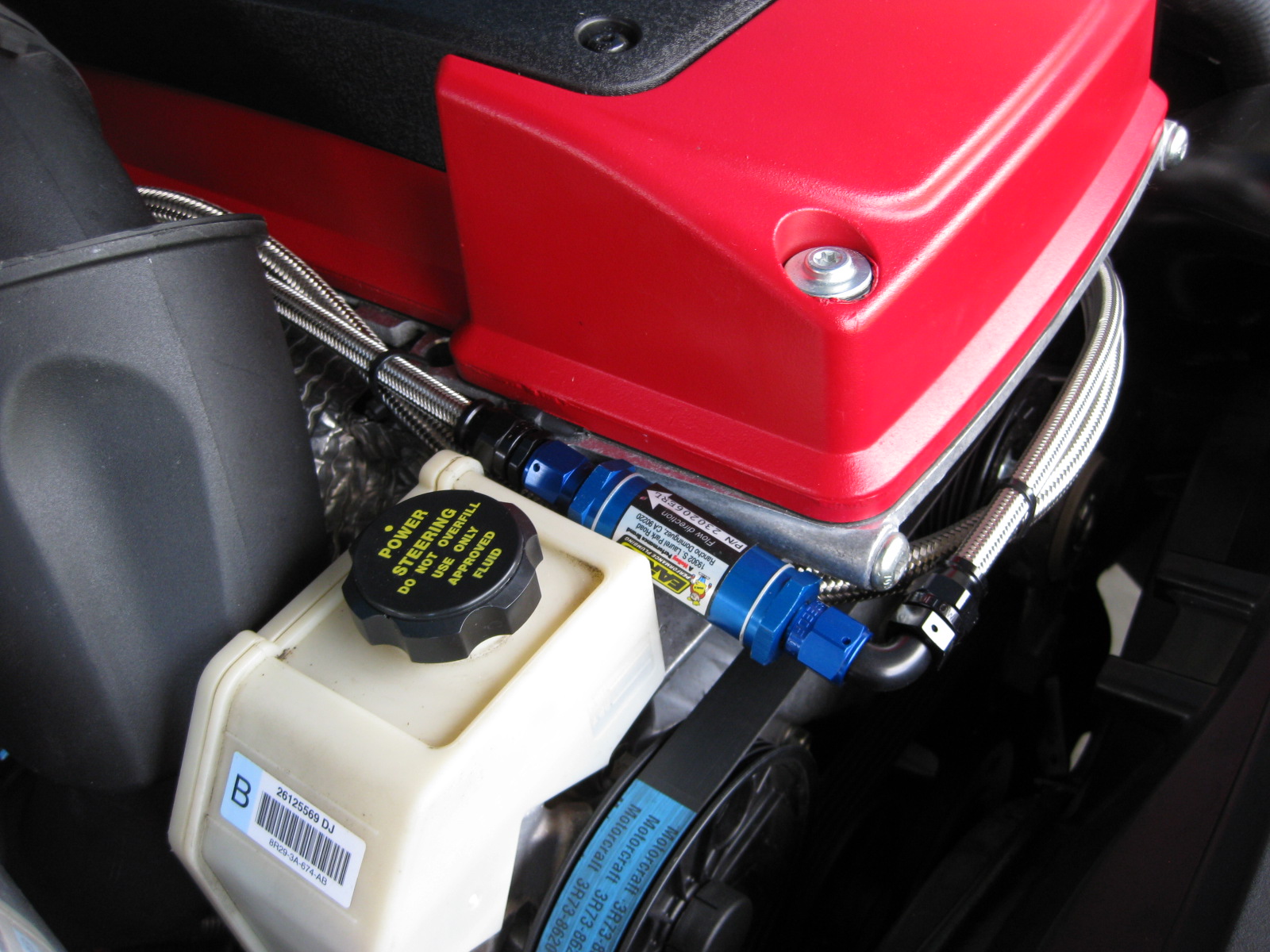

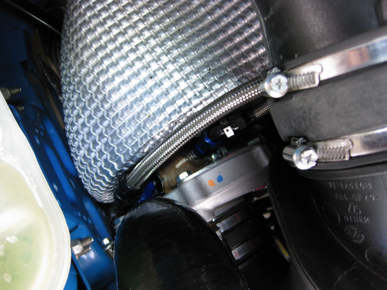

CHLAXN Donating Members 932 Member For: 16y 10m 26d Gender: Male Location: north QLD Posted 06/01/11 05:00 AM Share Posted 06/01/11 05:00 AM just thought I would put some pics up of my new water and oil feed lines for the turbo that I made up yesterday.. having the remote oil line filter is alot easier to keep maintance up now.. practly same as the ETM oil line but is -6 all the way not -6 then to -4.. also dresses up the engine bay a bit now too.. cheers Link to comment https://www.fordxr6turbo.com/forum/topic/72535-new-turbo-oil-and-water-lines-fon-my-fg/ Share on other sites More sharing options...

Wenier Donating Members 1,736 Member For: 15y 2m 30d Gender: Male Location: Christchurch, New Zealand Posted 06/01/11 05:56 AM Share Posted 06/01/11 05:56 AM Very nice, looks good. Just need some p clips to hold the lines rather than cable ties. Link to comment https://www.fordxr6turbo.com/forum/topic/72535-new-turbo-oil-and-water-lines-fon-my-fg/#findComment-1069542 Share on other sites More sharing options...
CHLAXN Donating Members 932 Member For: 16y 10m 26d Gender: Male Location: north QLD Posted 06/01/11 06:23 AM Author Share Posted 06/01/11 06:23 AM On 06/01/2011 at 5:51 AM, Rusty XR6T said: any chance of you wanting to make me one? it looks fantastic! I'll pay of course!all up cost me over 500 bucks to do both lines bloody speedflow 200 series fittings arent cheap I tell you, plus you have to but the proper spanners so you dont mark the fittngs and that's another 150.. not real keen to make another sorry mate lol On 06/01/2011 at 5:56 AM, Wenier said: Very nice, looks good. Just need some p clips to hold the lines rather than cable ties.yeah I brought some p clips when I got the stuff online but they were the wrong size will get some more next week when I get back from work cheers Link to comment https://www.fordxr6turbo.com/forum/topic/72535-new-turbo-oil-and-water-lines-fon-my-fg/#findComment-1069546 Share on other sites More sharing options...
bjc Donating Members 2,823 Member For: 21y 7m 13d Gender: Male Location: Townsville Posted 06/01/11 11:17 AM Share Posted 06/01/11 11:17 AM Could you have just used some cloth between the spanner as to not mark them if that's what you were worried about? Clean and dag free spanners should have been ok anyway but suppose if you want it shiny that's the price you pay I suppose. Link to comment https://www.fordxr6turbo.com/forum/topic/72535-new-turbo-oil-and-water-lines-fon-my-fg/#findComment-1069692 Share on other sites More sharing options...
CHLAXN Donating Members 932 Member For: 16y 10m 26d Gender: Male Location: north QLD Posted 06/01/11 01:16 PM Author Share Posted 06/01/11 01:16 PM yeah probably could of mate but my last etm oil line I had on my f6 had marks on it from doing it that way so that's why I brought the proper tools this time.. when some of the fittings are 65 each you try to be careful.. Link to comment https://www.fordxr6turbo.com/forum/topic/72535-new-turbo-oil-and-water-lines-fon-my-fg/#findComment-1069735 Share on other sites More sharing options...
