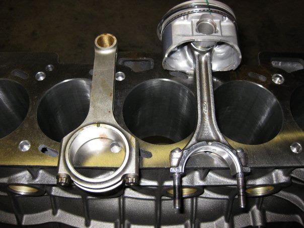

Stazza_Brendan Donating Members 686 Member For: 15y 6m 10d Gender: Male Location: Mackay QLD Posted 28/12/10 11:55 PM Share Posted 28/12/10 11:55 PM Can anyone confirm FG F6 rods are better then the BA/F F6 and 06/06+ rods?Pictures of side by side would be great Link to comment https://www.fordxr6turbo.com/forum/topic/72067-fg-f6-bottem-end-and-450rwkw/page/3/#findComment-1067362 Share on other sites More sharing options...
NVYDF6 Built F6 & VE SS-V Donating Members 582 Member For: 17y 8m 29d Gender: Male Location: Melb Posted 29/12/10 01:13 AM Share Posted 29/12/10 01:13 AM They are exactly the same BF - FG rods...Here is a pic of a set of FG F6 rods that I removed from the FG F6 short motor I bought, they were exactly the same as the BF rods we removed from my BF F6 motor. You can see they are quite skinny in comparrison to a set of H beam forged rods. Link to comment https://www.fordxr6turbo.com/forum/topic/72067-fg-f6-bottem-end-and-450rwkw/page/3/#findComment-1067377 Share on other sites More sharing options...
