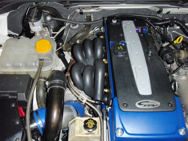

XYZ Donating Members 1,171 Member For: 15y 7m 7d Posted 30/11/10 09:25 PM Share Posted 30/11/10 09:25 PM do you have some pics of customers cars with these manifolds on that you could put in this thread? it seems a few ppl are interested in these manifolds.Have a look at the pictures of RIP85 for the BF set up and mine for the FG.here are a couple more pictures of the FG Manifold. Link to comment https://www.fordxr6turbo.com/forum/topic/71895-aftermarket-exhaust-manifold/page/3/#findComment-1059831 Share on other sites More sharing options...

Adrian_F6 Large Member Member 551 Member For: 16y 7m 18d Gender: Male Location: In The Sticks Posted 01/12/10 01:27 AM Author Share Posted 01/12/10 01:27 AM xyz does that heatshield come with it or did you make that yourself. looks really neat also, do you find there is too much heat on the side of your rocca cover or bonnet or even the overflow? Link to comment https://www.fordxr6turbo.com/forum/topic/71895-aftermarket-exhaust-manifold/page/3/#findComment-1059878 Share on other sites More sharing options...

XYZ Donating Members 1,171 Member For: 15y 7m 7d Posted 01/12/10 04:00 AM Share Posted 01/12/10 04:00 AM (edited) xyz does that heatshield come with it or did you make that yourself. looks really neat also, do you find there is too much heat on the side of your rocca cover or bonnet or even the overflow?Hey Mate,My tuner made the heat shielding for me, it is the same material that is on the standard manifold. you can buy it in sheets from places like repco etc...Yes the manifold does create a bit of heat, however the heat shielding we made up does a great job protecting to coil cover and overflow. Took a bit of fiddling around making up different stencils, however the end result was great and even has a factory appearance.CheersBen Edited 01/12/10 04:03 AM by XYZ Link to comment https://www.fordxr6turbo.com/forum/topic/71895-aftermarket-exhaust-manifold/page/3/#findComment-1059897 Share on other sites More sharing options...
