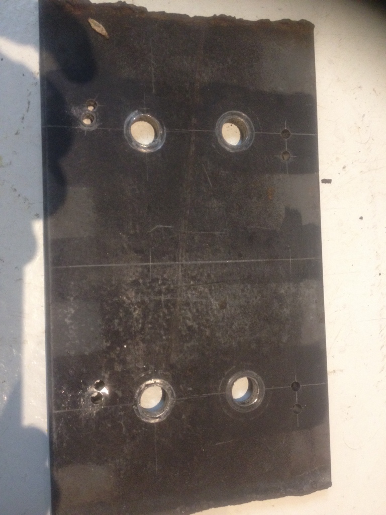

"Captain Retard" Member 1,417 Member For: 10y 11m 12d Gender: Male Location: Shellharbour NSW Posted 05/09/14 04:54 AM Share Posted 05/09/14 04:54 AM Hmmmm , holes in the arms???Maybe they drilled new upper arm location holes in the body to lower the upper arms?It's an old trick that can get great results.I actually did this on my 73 XA HARDTOP and it made a huge difference on corner turn in.It's quiet easy to do once you know the exact measurements.I just made up a jig out of 6mm flat plate which then bolted to the original holes and then drilled through the new holes in the plate and into the body.Generally the new holes are lower and moved back just a bit.But you really only get 1 shot at it so it would be interesting to know the measurements. Link to comment https://www.fordxr6turbo.com/forum/topic/71675-fg-front-camber-kit/#findComment-1497332 Share on other sites More sharing options...

"Captain Retard" Member 1,417 Member For: 10y 11m 12d Gender: Male Location: Shellharbour NSW Posted 05/09/14 06:05 AM Share Posted 05/09/14 06:05 AM Good idea, I understand what you've done.But like you said it would be a pain with the standard spring shock arrangement .Here's some pics of my XA and jig to try and explain what I'm on about!The jig is simply turned over for the other side. Link to comment https://www.fordxr6turbo.com/forum/topic/71675-fg-front-camber-kit/#findComment-1497343 Share on other sites More sharing options...
