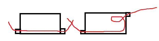

Dillz Three pedals are better then two.. Donating Members 15,637 Member For: 17y 11m 2d Gender: Male Location: Melbourne Posted 13/10/10 08:02 AM Share Posted 13/10/10 08:02 AM Whats the price of the full kit? Still not sure how the staggered inlet outlet works better then normal, wouldn't the air bottlneck in the cooler?Crappy pic. Link to comment https://www.fordxr6turbo.com/forum/topic/70963-which-cooler-to-get/page/3/#findComment-1047308 Share on other sites More sharing options...
Henz Tampon inserted, Auto Acquired, next purchase a new handbag Donating Members 9,946 Member For: 17y 1m 8d Gender: Male Location: Vic Posted 13/10/10 08:13 AM Share Posted 13/10/10 08:13 AM just over $2000 a mate paid with injectors, he might be on, if so he'll clear it up.Staggered end tanks use the hole core I guess?Xr6t_ute with the stageone style cooler(stock X-over, intake etc), did 11.2 on stock bottom end at Calder a few weeks ago. 317rwkw. Link to comment https://www.fordxr6turbo.com/forum/topic/70963-which-cooler-to-get/page/3/#findComment-1047314 Share on other sites More sharing options...
