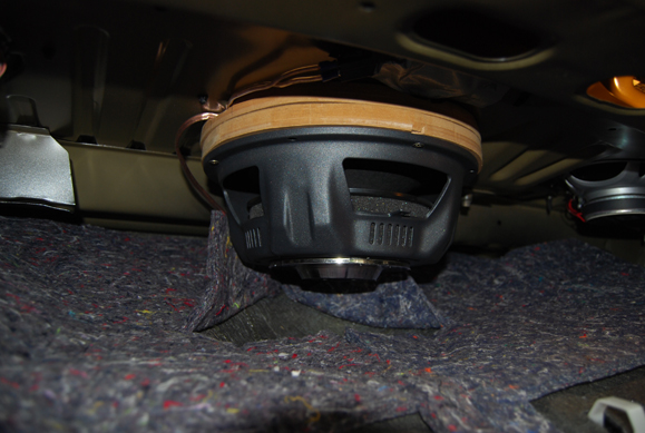

spook Donating Members 180 Member For: 17y 20d Gender: Male Posted 03/11/10 10:57 AM Share Posted 03/11/10 10:57 AM I replaced mine with a 10 inch from Jaycar and run it from the factory sub amp. Mounted it from underneath the parcel tray and the boot lining still fits fine. Huge improvement in bass and no distortion at high volume levels. Link to comment https://www.fordxr6turbo.com/forum/topic/70899-direct-replacement-aftermarket-subwoofer/page/2/#findComment-1052726 Share on other sites More sharing options...

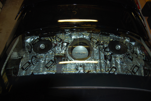

spook Donating Members 180 Member For: 17y 20d Gender: Male Posted 06/11/10 05:12 AM Share Posted 06/11/10 05:12 AM (edited) It was the previous brand(Venom) that Jaycar used to sell before updating to the Vifa range. The store I called into had one left, just wanted it gone and sold it to me for $30. Only thing I want to do now is Dynamat the parcel tray. I think it's ideally suited to an enclosure, however it's a huge improvement over the stock sub. It has a QTS of 0.63 (have no idea what that means) Edited 06/11/10 05:18 AM by spook Link to comment https://www.fordxr6turbo.com/forum/topic/70899-direct-replacement-aftermarket-subwoofer/page/2/#findComment-1053454 Share on other sites More sharing options...

Spoony Member 250 Member For: 14y 6m 13d Gender: Male Location: Brisbane Posted 14/11/10 09:04 PM Share Posted 14/11/10 09:04 PM I striped an old 10inch Kicker out of a box I've had for years (happy to see "Freeair" on the back of the thing lol). Made up some MDF spacers and mounted it. Works near as good as in the box in the boot. I'd imagine once I redo the mounting more solid and dynamat the shelf it should work even better. Due to the spacers and the size of the sub I had to remove the rear under carpet, but meh, can't see that anyways so doesn't really matter. Much better than having a box in the boot taking up space. Link to comment https://www.fordxr6turbo.com/forum/topic/70899-direct-replacement-aftermarket-subwoofer/page/2/#findComment-1055909 Share on other sites More sharing options...
spook Donating Members 180 Member For: 17y 20d Gender: Male Posted 15/11/10 11:36 AM Share Posted 15/11/10 11:36 AM Good stuff Spoony. I ran some dynamat (not that exact brand but similar) over the rear parcel tray and must say I'm impressed with the results with the bass now much cleaner. The factory sub amp seems up to the task so far - time will tell.Danny: yeah mate, just made up some mdf rings and mounted it underneath and runs off the factory sub plug. Dynamat is just a sound deadening material that sticks to almost anything. Good at getting rid of vibrations due to subs etc. Most car audio places should be able to get you some. Link to comment https://www.fordxr6turbo.com/forum/topic/70899-direct-replacement-aftermarket-subwoofer/page/2/#findComment-1056082 Share on other sites More sharing options...
