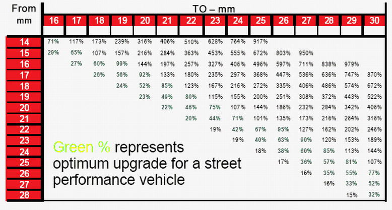

Smoke them tyres Member 557 Member For: 17y 3m 26d Gender: Male Location: Brisbane Posted 24/09/11 10:58 AM Share Posted 24/09/11 10:58 AM Swaybar stiffness table....... Link to comment https://www.fordxr6turbo.com/forum/topic/70286-massive-understeer-at-the-track-what-to-do/page/11/#findComment-1143659 Share on other sites More sharing options...
xr_velocity Donating Members 290 Member For: 18y 5m 17d Gender: Male Location: Sydney Posted 30/09/11 02:14 AM Author Share Posted 30/09/11 02:14 AM (edited) Two sessions without the rear sway bar on now, FMD what a massive improvement in front end grip. Chalk and cheese the rear bar will never be put back on!I can hit the apexes now! No loss of rear end stability or grip either, wouldn't say it's better, but wouldn't say it's worse either.The added front end grip really highlights that the street tyres are not up to it. Haven't run a decent time yet as still bedding in pads. A few sessions to go though. I am only 5 seconds off my best time with taking it very easy.I didn't get around to putting the king springs 520's in either. Still Lovells 410's.Happy days, now I need tyres. Edited 30/09/11 02:17 AM by xr_velocity Link to comment https://www.fordxr6turbo.com/forum/topic/70286-massive-understeer-at-the-track-what-to-do/page/11/#findComment-1145101 Share on other sites More sharing options...
