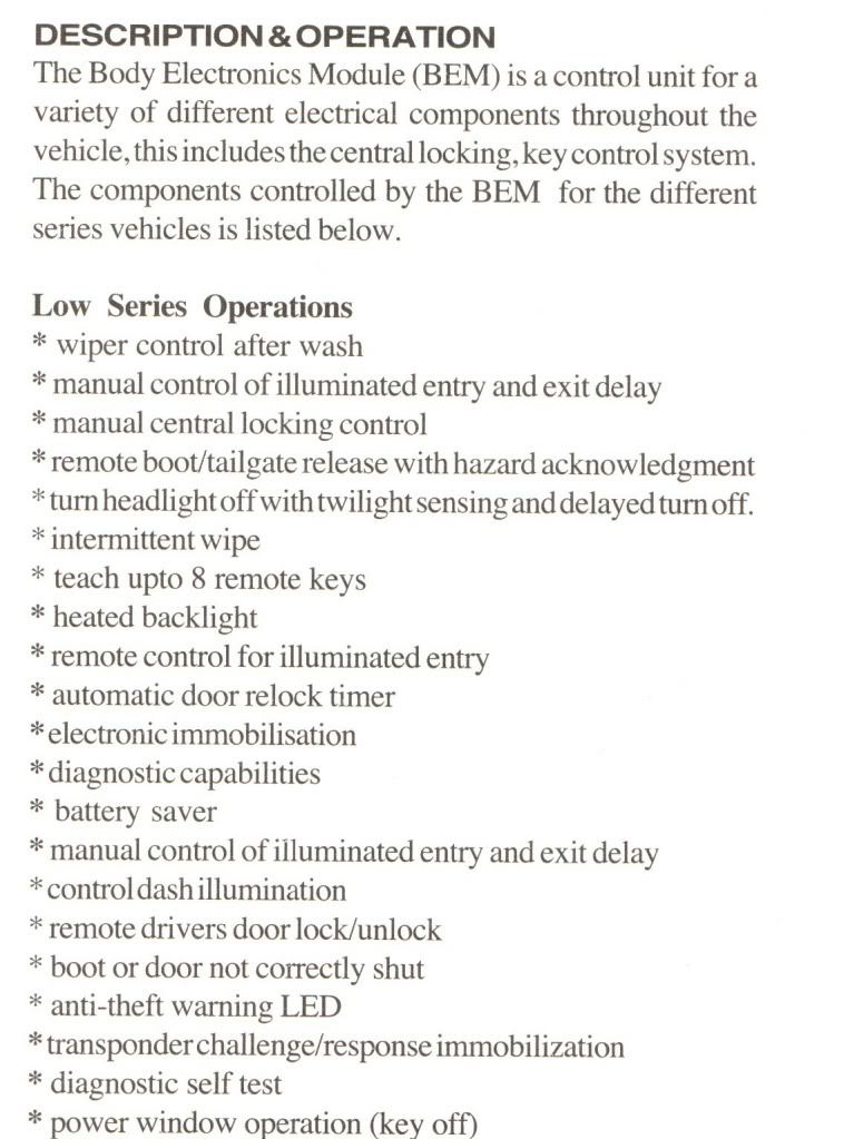

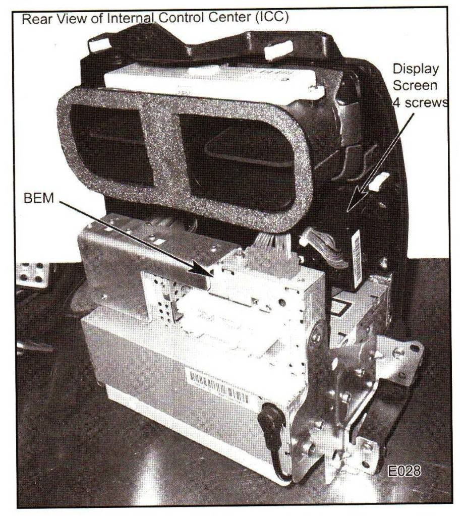

f-wolf Member 897 Member For: 18y 1m 28d Gender: Male Location: ACT Posted 12/08/10 12:14 PM Share Posted 12/08/10 12:14 PM (edited) I think this is the one you are looking for.http://i242.photobucket.com/albums/ff239/mypm/BEM.jpgAndhttp://i242.photobucket.com/albums/ff239/mypm/BEM2.jpg Edited 12/08/10 12:18 PM by f-wolf Link to comment https://www.fordxr6turbo.com/forum/topic/69435-door-ajar-light-stays-on-but-doors-shut/page/2/#findComment-1032153 Share on other sites More sharing options...
nzturbo Member 26 Member For: 15y 8m 15d Gender: Male Location: NZ Posted 12/08/10 06:46 PM Author Share Posted 12/08/10 06:46 PM thanks F-wolf , looks like a real bugger to get at to check connector !!Another question , are there plugs in the bottom of the A pillar behind those kick panels for the doors ????????thanks Link to comment https://www.fordxr6turbo.com/forum/topic/69435-door-ajar-light-stays-on-but-doors-shut/page/2/#findComment-1032193 Share on other sites More sharing options...
4DZILR Donating Members 713 Member For: 15y 4m 17d Gender: Male Location: Sydney - Brighton Le Sands Posted 13/08/10 03:15 AM Share Posted 13/08/10 03:15 AM (edited) It would be behind the dash. The BEM is behind the stereo so it would be just behind there.. and I would think it would run direct to the actuator.I reckon get yourself a tester. Then just start testing all the different points. From the actuator to the wiring within the door.. When you'd press the central lock button, it will send current to the actuator, if your tester shows this, then you know its not the power as the problem. But something to do with the actuator. etc etcStart ruling things out instead of just cleaning them champ coz you will clean for ages! loll Edited 13/08/10 03:16 AM by 4DZILR 1 Link to comment https://www.fordxr6turbo.com/forum/topic/69435-door-ajar-light-stays-on-but-doors-shut/page/2/#findComment-1032268 Share on other sites More sharing options...
