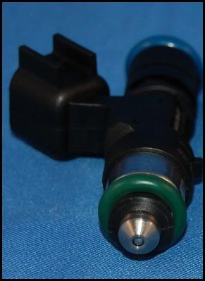

IH8TOADS Silver Donating Members 3,618 Member For: 19y 9m 13d Gender: Male Location: OZ Posted 29/10/10 03:29 AM Share Posted 29/10/10 03:29 AM ID1000 head. Can't remember where I got the pick from! Link to comment https://www.fordxr6turbo.com/forum/topic/69273-injectors-for-fg/page/8/#findComment-1051326 Share on other sites More sharing options...
