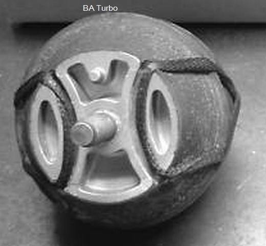

f-wolf Member 897 Member For: 17y 11m 26d Gender: Male Location: ACT Posted 30/06/10 12:09 PM Share Posted 30/06/10 12:09 PM ReWe changed my passenger side one using an NA mount. Just took the straps off my existing mount and put it onto the NA. Put it in and so far so good. ******************************** Link to comment https://www.fordxr6turbo.com/forum/topic/68630-constant-rough-idle-vibration/page/3/#findComment-1020303 Share on other sites More sharing options...
boost69 Donating Members 737 Member For: 19y 11m 1d Posted 30/06/10 11:12 PM Share Posted 30/06/10 11:12 PM Actually from memory I remember the NA mount was a fraction of the cost of the turbo one...im sure there is a reason why the turbos have a different mount and for the turbo side I would definately get the turbo mount as this is a mount you dont want to be changing all too often... Link to comment https://www.fordxr6turbo.com/forum/topic/68630-constant-rough-idle-vibration/page/3/#findComment-1020388 Share on other sites More sharing options...
Full Monty Member 513 Member For: 17y 9m 27d Gender: Male Location: Melbourne Posted 30/06/10 11:57 PM Share Posted 30/06/10 11:57 PM Interesting, I'd love to see side by side shots of the NA and Turbo mounts. If the only difference is the straps, which can be removed from the old mount and re-used, sh*t hot! that's a big saving! Link to comment https://www.fordxr6turbo.com/forum/topic/68630-constant-rough-idle-vibration/page/3/#findComment-1020397 Share on other sites More sharing options...
boost69 Donating Members 737 Member For: 19y 11m 1d Posted 01/07/10 01:20 AM Share Posted 01/07/10 01:20 AM Just from looking at the photo I think the turbo mount looked a bit different also aside from the straps...maybe someone else can enlighten us Link to comment https://www.fordxr6turbo.com/forum/topic/68630-constant-rough-idle-vibration/page/3/#findComment-1020411 Share on other sites More sharing options...
f-wolf Member 897 Member For: 17y 11m 26d Gender: Male Location: ACT Posted 01/07/10 02:06 AM Share Posted 01/07/10 02:06 AM BA-BF N/A Link to comment https://www.fordxr6turbo.com/forum/topic/68630-constant-rough-idle-vibration/page/3/#findComment-1020423 Share on other sites More sharing options...
f-wolf Member 897 Member For: 17y 11m 26d Gender: Male Location: ACT Posted 01/07/10 03:13 AM Share Posted 01/07/10 03:13 AM BA Turbo Link to comment https://www.fordxr6turbo.com/forum/topic/68630-constant-rough-idle-vibration/page/3/#findComment-1020434 Share on other sites More sharing options...
John_K Donating Members 438 Member For: 16y 4m 14d Gender: Male Location: Sydney Posted 01/07/10 10:43 AM Share Posted 01/07/10 10:43 AM OK, I got the aftermarket brand new mounts from Riverside Spares for $30ea (did I get ripped off?).Here you can see the 2 mounts side-by-side. The leaking one (yes they are oil filled) is my original Falcon turbo mount with the straps removed, the one on the right is the $30 aftermarket NA mount. Link to comment https://www.fordxr6turbo.com/forum/topic/68630-constant-rough-idle-vibration/page/3/#findComment-1020623 Share on other sites More sharing options...
Full Monty Member 513 Member For: 17y 9m 27d Gender: Male Location: Melbourne Posted 02/07/10 12:22 AM Share Posted 02/07/10 12:22 AM Outstanding work! they look identicle to me...Can you spot any obvious differences in person? Link to comment https://www.fordxr6turbo.com/forum/topic/68630-constant-rough-idle-vibration/page/3/#findComment-1020795 Share on other sites More sharing options...
Full Monty Member 513 Member For: 17y 9m 27d Gender: Male Location: Melbourne Posted 02/07/10 12:25 AM Share Posted 02/07/10 12:25 AM I wonder if they even come out of the same moulds? can you see if the numbers printed on their sides match up? Link to comment https://www.fordxr6turbo.com/forum/topic/68630-constant-rough-idle-vibration/page/3/#findComment-1020797 Share on other sites More sharing options...
