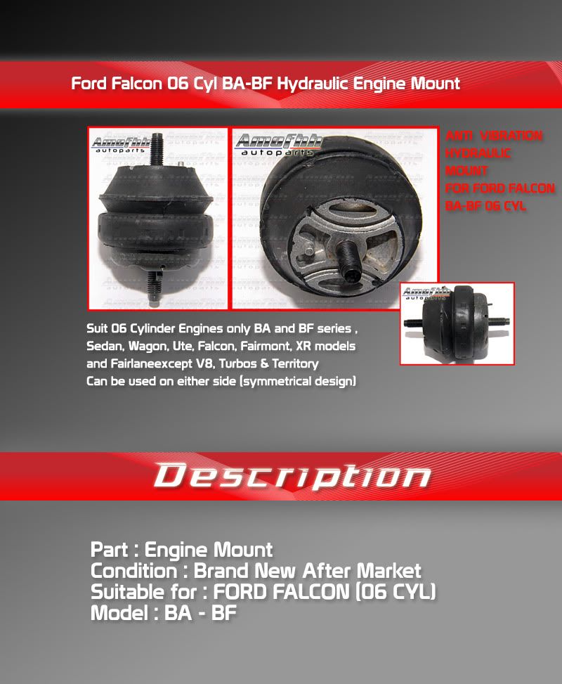

f-wolf Member 897 Member For: 18y 8d Gender: Male Location: ACT Posted 30/06/10 06:48 AM Share Posted 30/06/10 06:48 AM (edited) Ford Parts BA - BF 06 Cyl Falcon Engine MountFound at : Ford Parts BA - BF 06 Cyl Falcon Engine Mount - eBay, Other, Car Parts, Accessories, Cars, Bikes, Boats. (end time 19-Jul-10 19:51:44 AEST)http://i244.photobucket.com/albums/gg5/lightbeyondlight/Ford%20Parts/Mount.jpg Edited 30/06/10 06:49 AM by f-wolf Link to comment https://www.fordxr6turbo.com/forum/topic/68630-constant-rough-idle-vibration/page/2/#findComment-1020193 Share on other sites More sharing options...
Full Monty Member 513 Member For: 17y 10m 10d Gender: Male Location: Melbourne Posted 30/06/10 07:38 AM Share Posted 30/06/10 07:38 AM Dont use that mount, its designed for the NA / 6. Note it doesnt have the reinforcing straps, to hold the engine down when it breaks. Probably isnt engineered for the increased torque of the Turbo models. Link to comment https://www.fordxr6turbo.com/forum/topic/68630-constant-rough-idle-vibration/page/2/#findComment-1020209 Share on other sites More sharing options...
boost69 Donating Members 737 Member For: 19y 11m 14d Posted 30/06/10 09:07 AM Share Posted 30/06/10 09:07 AM Yes the turbo one has straps...there is a difference between NA and turbo mounts...I bought mine from Thomson Ford in Parramatta guys for under $300...I also got C&V to fit the mount and they did it without turbo removal...I also had previously confirmed it can be done without turbo removal as I asked a friend who works at a Ford dealership and who used to work on my car when it was under warranty and he also said it can be done without turbo removal...Like I said I asked around and some workshops said turbo needs to come off and wanted $500 labour plus perishebles to do it...and others can do it without turbo removal...which cost up to $150 labour... Link to comment https://www.fordxr6turbo.com/forum/topic/68630-constant-rough-idle-vibration/page/2/#findComment-1020240 Share on other sites More sharing options...
