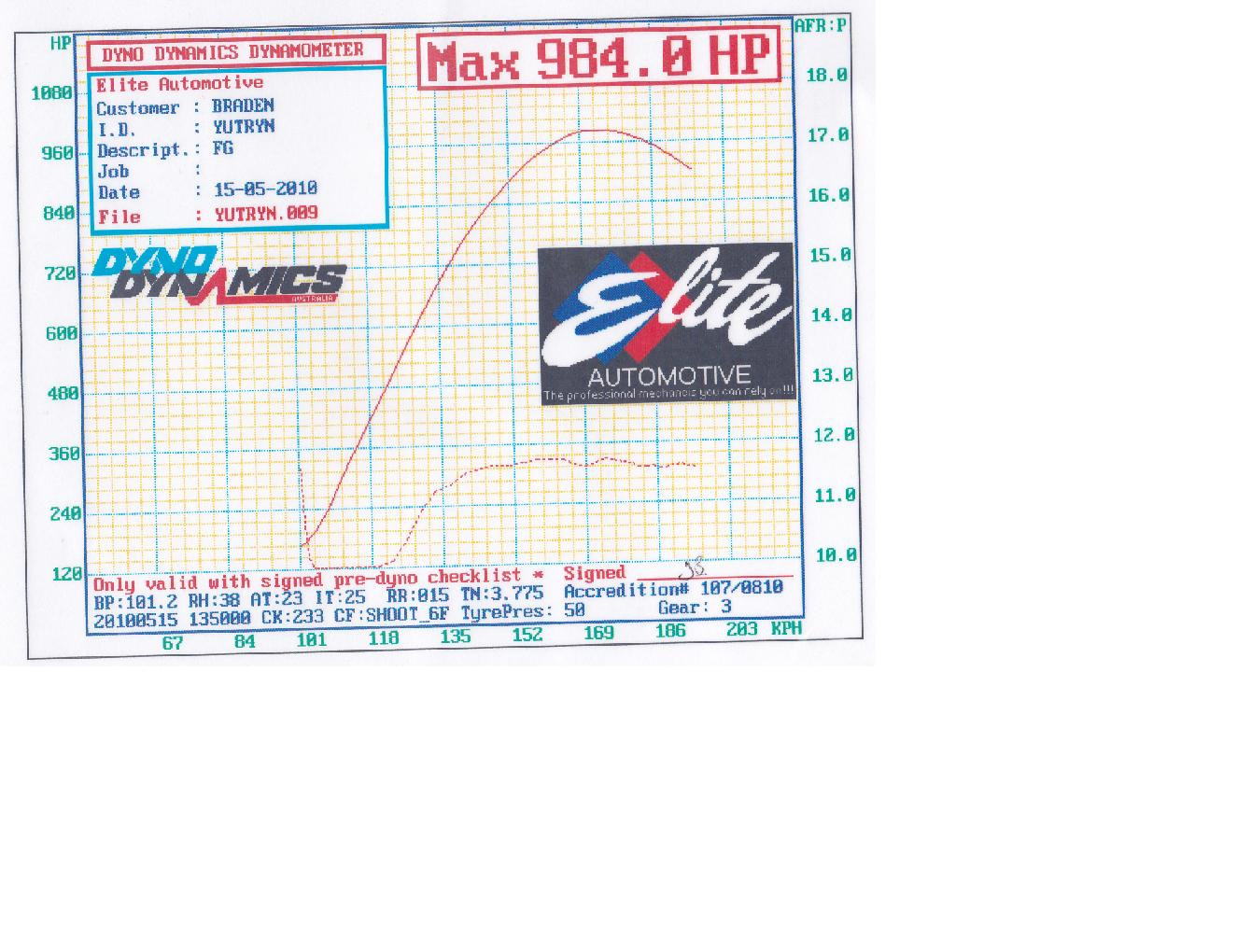

6BOOST Gold Donating Members 139 Member For: 17y 3m 28d Gender: Male Posted 18/05/10 12:22 PM Share Posted 18/05/10 12:22 PM For those that are interested I thought I'd post the dyno sheet. The reason it goes off the sheet rich and comes back very quick and is a near perfect AF curve is the factory computer only being able to be mapped to 27psi, and in this instance starting the ramp early, we load the car up so it comes straight off the converter when dynoing ourselves. Its not a prob on the road or track.6BOOST Link to comment https://www.fordxr6turbo.com/forum/topic/68157-new-fg-record-6boost-braidens-green-machine-runs-10086/page/5/#findComment-1008712 Share on other sites More sharing options...
