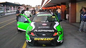

senna_T Forged Member Lifetime Members 15,818 Member For: 18y 2m 24d Gender: Male Location: SW Sydney Posted 23/05/10 09:59 AM Share Posted 23/05/10 09:59 AM I was watching this car as much as I could, also keeping an eye on Mal Rose's commo. Considering both of them are ex V8 supercar chassis, and engineered with slick tyres in mind I was not surprised when I could see they were both struggling for grip.Every time Jose was coming out of turn 10 (I think, down hill right hander) he was on and off the gas with wheel-spin. Good effort from the boys considering they had zero track time! Link to comment https://www.fordxr6turbo.com/forum/topic/67801-the-superlap-v8-supercar-with-xr6t-motor/page/5/#findComment-1009978 Share on other sites More sharing options...

plazmaman Member 43 Member For: 18y 8m 2d Posted 24/05/10 01:20 PM Share Posted 24/05/10 01:20 PM THERE WERE A LOT OF DOUBTERS WITH ONLY 10 WEEKS TO GET IT TOGETHER WITH ALL THE OTHER THINGS GOING ON AROUND US . THE CAR PERFORMED FLAWLESSLY WITH ABSOLUTELY NO PROBLEMS AND LEFT THE TRACK IN PERFECT CONDIDITON . ALL POWER AND TORQUE FIGURES WERE ACHIEVED FIRST GO . WE MADE A DIFF GEAR SWAP FRIDAY MORNING AS WE CALCULATED THAT WE WOULD RUN OUT OF RPMS HALF WAY DOWN THE MAIN STRAIGHT . 3.0 WENT IN THE ASS END , BUT WE NEEDED MORE LIKE A 2.6 - 1 RATIO . FIRST TEST SESSION SHOWED THAT THE CAR MADE WAY TOO MUCH TORQUE AND WAY TOO MUCH FRONT WHEEL CAMBER AS IT TORE THE INSIDE OF THE TIRES TO SHREDS . STILL A 1.41.50 LAP TIME WAS ACHIEVED AFTER 5 LAPS AFTER NO TESTING. SECOND SESSION - A ROLL CENTRE ADJUSTMENT WITH FRONT CAMBER PULLED OUT WE CHOPPED OFF 1.5 SECONDS AND NEARLY DIPPED INTO THE 1.39S . THE FINAL SESSION WE PULLED OUT SOME POWER IN THE MID CORNER AREAS TO DECREASE TORQUE AND SOME TIRE PRESSURE ADJUSTMENTS WERE MADE . WE SUCCESSFULLY PULLED OUT MORE PERFORMANCE EVEN THOUGH THE TRACK LOST SOME 2-3 SECONDS PER LAP DUE TO THE COLDER TRACK SURFACE , AND STILL MANAGED A 1.40 SECOND LAP . A VERY SUCCESSFUL OUTING WITH ONLY 15 LAPS . Link to comment https://www.fordxr6turbo.com/forum/topic/67801-the-superlap-v8-supercar-with-xr6t-motor/page/5/#findComment-1010387 Share on other sites More sharing options...

F6 UTE - Track Bound EVO III - Member 3,367 Member For: 20y 4m 16d Gender: Male Location: Strapped in and holding on Posted 24/05/10 03:03 PM Share Posted 24/05/10 03:03 PM Nice work Plazmaman, car is a credit to the ppl involved - no doubt.What times did that car run in V8 guise? Did it ever run at the creek? Seems everyone was up against it all weekend. The winning car posted only a handful of flying laps and replaced their engine in the pits. Sierra Sierra blew a head gasket and replaced it in the pits - Panspeed did a turbo, replaced, then did a gearbox.Berry blew a head gasket too.. And all for the top 10 shootoout to get quashed........ If the internationals back it up next year, I might make the trip over to watch.. btw - does no-one o-ring their blocks anymore? Link to comment https://www.fordxr6turbo.com/forum/topic/67801-the-superlap-v8-supercar-with-xr6t-motor/page/5/#findComment-1010407 Share on other sites More sharing options...
Rosie Member 361 Member For: 18y 23d Posted 24/05/10 08:35 PM Share Posted 24/05/10 08:35 PM Fantastic job Boys!I still find it interesting that we all have to drop Power/Torque to get these Cars to put the power down out of the Corners.Any kind of full Slick seems to make a big difference though!What negative Camber did you finish up with at the front? Link to comment https://www.fordxr6turbo.com/forum/topic/67801-the-superlap-v8-supercar-with-xr6t-motor/page/5/#findComment-1010420 Share on other sites More sharing options...

plazmaman Member 43 Member For: 18y 8m 2d Posted 31/05/10 10:10 AM Share Posted 31/05/10 10:10 AM V8 supercars run 5 -6 odd degrees depending on track . we started with 4.5 , but pulled it down to 3.5 and could have taken more out . We are going carbon brakes and carbon panels , trying to pull out 200 odd kgs as the car will not be used for V8 racing no more . An interesting fact from the saturday . We did x3 5 lap runs . Tyres had a 2-3 lap window due to the nature and moving around of the rubber . Jose was still trying to find his feet in the first x2 sessions and flat spotted x 4 of them - rubbish bin . x2 degregaded and were stuffed . All up out of the x12 tyres we saved x 6 used ones . But get this - we were lucky to have Dunlop sponsor us 20 tyres @ $740 each ( RRP we were told ) . total used $8880 for just 15 laps - ouchhhhhhh , imagine if we were there on friday and used all the alocated ones .... Any one can build a car , but to race and maintain it is another thing . Thank you for the support DUNLOP Motorsports . Link to comment https://www.fordxr6turbo.com/forum/topic/67801-the-superlap-v8-supercar-with-xr6t-motor/page/5/#findComment-1012204 Share on other sites More sharing options...
