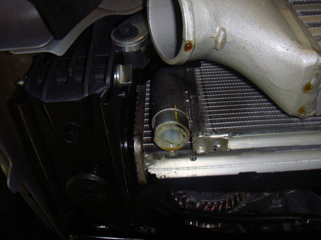

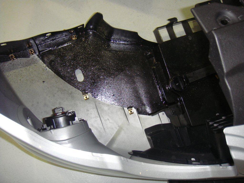

Sir20B Member 21 Member For: 15y 5m 8d Gender: Male Location: Brisbane Posted 13/03/10 07:47 AM Share Posted 13/03/10 07:47 AM (edited) Hi GuysLooking through the other threads I cant see anyone else making mention of a similar problem...Whilst fitting an after market PWR intercooler piping kit (that has just been released) to my otherwise stock 2010 FG Xr6T,I noticed some 10 drops of engine oil about to drop off my front bar under tray! After removal of the front bar it became obvious the oil was infact coming from the intercooler piping... the intercooler feed pipe tobe exact...It looks as though the intercooler feed pipe was a little loose from factory, and was leting boost to leak.. Though due to the exessive oil inside of the piping created a lovely mess of the inside of bar cover, under tray, part of the radiator and AC condensor...On closer inspection each of the intercooler pipes were coated in an impressively generous amount of engine oil! The final pipe leading upto the throttle body had the most of all,resutling in a puddle on the painted floor the size of a tea cup saucer (125mm across...!!)Further inspection it it became obvious the turbo charger compressor housing is where the oil enters the intake system.The air feed to the turbo is bone dry and proves the engine is not breathing a drop...I then proceeded to place the car back to stock, the now oil soaked pipes have popped off twice now. Ford look to be going to replace the turbo next week so all good. Next weekend ill be under the car with bucket and sponge cleaning up the mess.I guess its just one of those things... Anyone had similar experience? Edited 13/03/10 11:21 PM by Dagabond Link to comment https://www.fordxr6turbo.com/forum/topic/66876-2010-600km-old-fg-xr6t-turbo-oil-leak/ Share on other sites More sharing options...

Sir20B Member 21 Member For: 15y 5m 8d Gender: Male Location: Brisbane Posted 16/03/10 07:55 AM Author Share Posted 16/03/10 07:55 AM Mmmmmm Blood from stone being the appropriate description.... The after intercooler pipe leading to throttle body at anytime can be found to have 20cc of oil in it (at anytime even after being emptied the day prior... Not to mention the oil leaking from just about every hose join on the intake system)Ford today replaced all the clamps and pcv ((though the feed to the turbo (as mentioned above) is bone dry))Ford today confirm the Oil level on the dip stick was "down", yet untill the car is blowing smoke and/or the turbo compressor wheel is actually making contact with the compressor housing, the problem as far as Ford head Qtrs is concerned, isnt a warrantable issue. Little dissapointed really. 40k car that ive had 3weeks, with (now just over) 1000km on clock and ive still yet to even red-line it!! Link to comment https://www.fordxr6turbo.com/forum/topic/66876-2010-600km-old-fg-xr6t-turbo-oil-leak/#findComment-991540 Share on other sites More sharing options...
