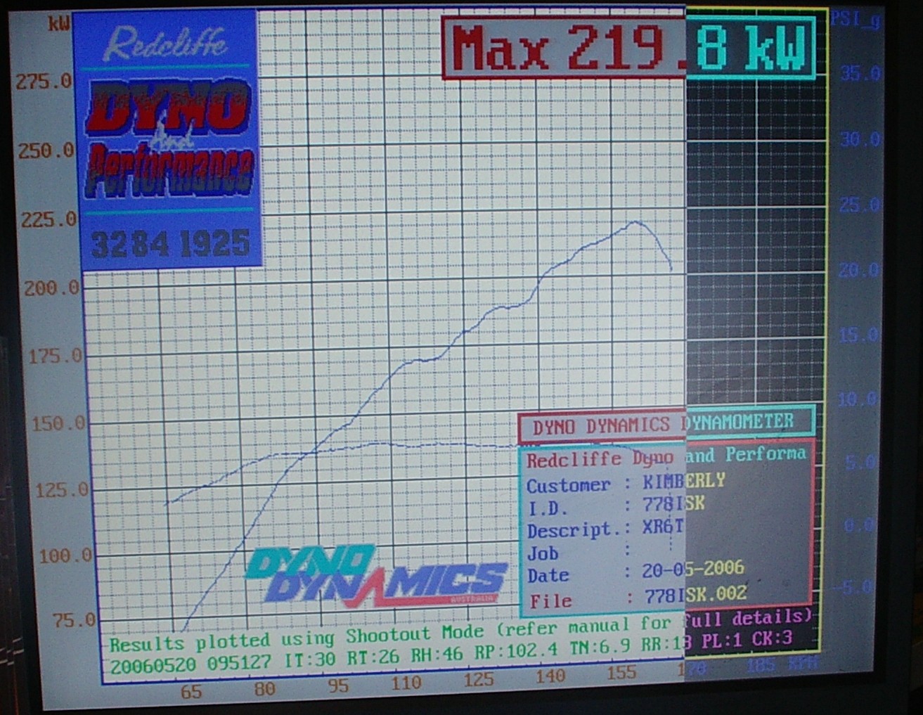

Kimberley Scott www.australianflag.org.au Donating Members 6,763 Member For: 19y 8m 30d Gender: Male Location: Brisbane Posted 25/10/06 10:15 AM Share Posted 25/10/06 10:15 AM turbotom said: That's an excellent post from Nizpro..... thanks.Could I get you to clarify whether 650 lbft peak torque is for stock rods, or for an aftermarket rod.I can see a lot of guys are going to be checking their dyno charts to see where they sit.....Here are some conversion factors which might help.....650 lbft equates to about 880 Nm, based on a conversion factor I found in a text.... 1 Nm = 0.73756 lbft. For those that want to get an indication of the torque from their power charts... Nm = (kW x 9549) / rpmso, if you have 220 kW at 3000 rpm, then that equates to 700 Nm @ 3000 rpmThat also equates to 516 lbft of torque in the old imperial measurements.But if you have 200 kW at 2000 rpm, then that's over 954 Nm @ 2000 rpmwhich is equivalent to 704 lbft of torque... As Nizpro have stated, it's all well and good to get a big kick in the pants with a huge torque peak at launch, but it's much safer to control the peak torque down low, and aim for a flatter torque curve across a wider bandwidth for good reliable street use.Some guys are finding their ET's at the track are better by early shifting to take advantage of the higher torque at lower rpm...... This is fine IF the motor and driveline can take up the stress due to the huge increase in peak torque.tom←Any chance you can help me out with the sums on mine?Scotty Link to comment https://www.fordxr6turbo.com/forum/topic/66619-atomic-motors-merged-topic/page/13/#findComment-454305 Share on other sites More sharing options...

Kimberley Scott www.australianflag.org.au Donating Members 6,763 Member For: 19y 8m 30d Gender: Male Location: Brisbane Posted 26/10/06 11:31 AM Share Posted 26/10/06 11:31 AM What Rpm is 160m kph in 4th, I am trying to work out the tourque.Scotty Link to comment https://www.fordxr6turbo.com/forum/topic/66619-atomic-motors-merged-topic/page/13/#findComment-454843 Share on other sites More sharing options...
SavageF6 Donating Members 1,622 Member For: 20y 11m 28d Gender: Male Location: Sydney Posted 26/10/06 12:32 PM Share Posted 26/10/06 12:32 PM As well as all the ratios, you'll need the diameter of the rollers on the dyno then. Link to comment https://www.fordxr6turbo.com/forum/topic/66619-atomic-motors-merged-topic/page/13/#findComment-454875 Share on other sites More sharing options...
