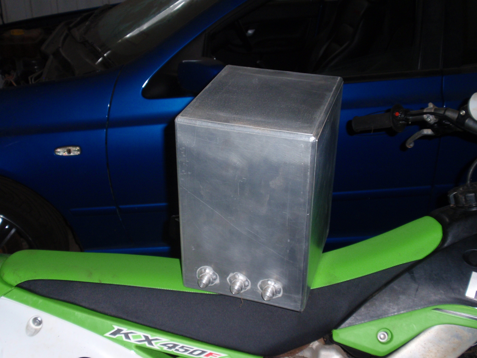

turbo ute79 Member 376 Member For: 16y 5m 13d Gender: Male Location: gladstone qld Posted 28/02/10 08:37 AM Author Share Posted 28/02/10 08:37 AM have some pics of my fuel pump and surge tank. pump is a magnafuel 525 pro tuner efi with a magnafuel fuel pressure regulator. surge tank is home made by a mate. also have a couple of pics of my ute but sadly it does not look like much at the moment. will post some more pics as I go along. most likely be getting a process west fuel rail next week as they look like a prety good thing Link to comment Share on other sites More sharing options...
