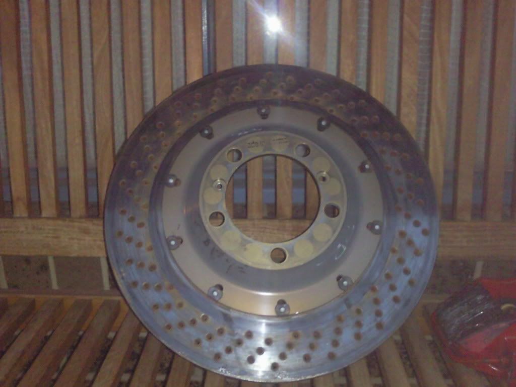

phatal Member 205 Member For: 17y 27d Gender: Male Location: Poxby Downs, SA Posted 18/01/10 08:59 AM Share Posted 18/01/10 08:59 AM Are those slots facing the wrong way or is it just me? Ie the right hand side rotors are on the left hand side? Link to comment Share on other sites More sharing options...

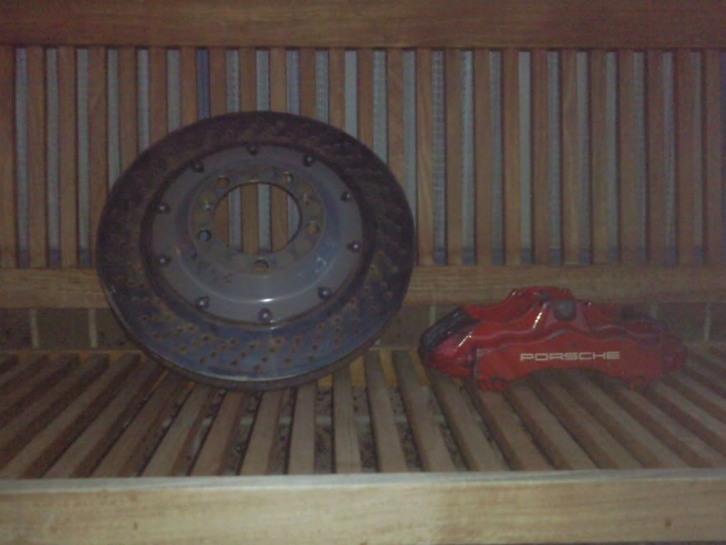

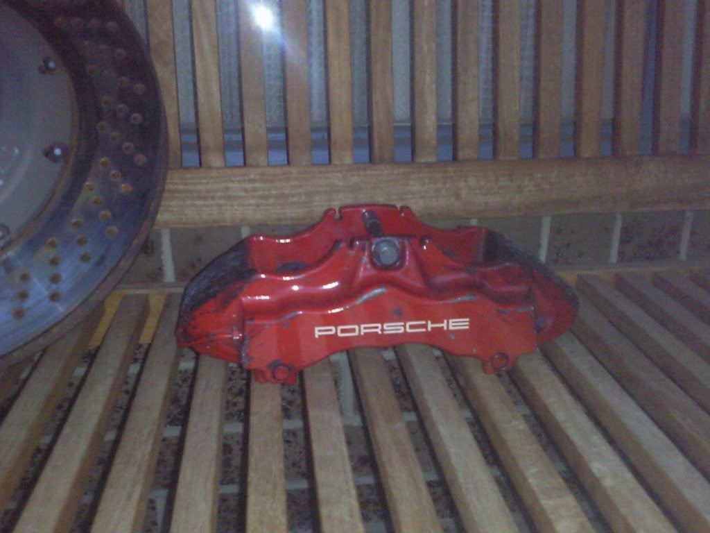

Sprjenkins Member 52 Member For: 16y 6m 22d Gender: Male Location: Melbourne Posted 19/01/10 10:04 AM Author Share Posted 19/01/10 10:04 AM These aren't the actual calipers, just some old ones I'm using to have the mounts made up, but you get the idea, look just like this but newerhttp://i150.photobucket.com/albums/s116/sprjenkins/Photo0029.jpghttp://i150.photobucket.com/albums/s116/sprjenkins/Photo0030.jpghttp://i150.photobucket.com/albums/s116/sprjenkins/Photo0031.jpg Link to comment Share on other sites More sharing options...
