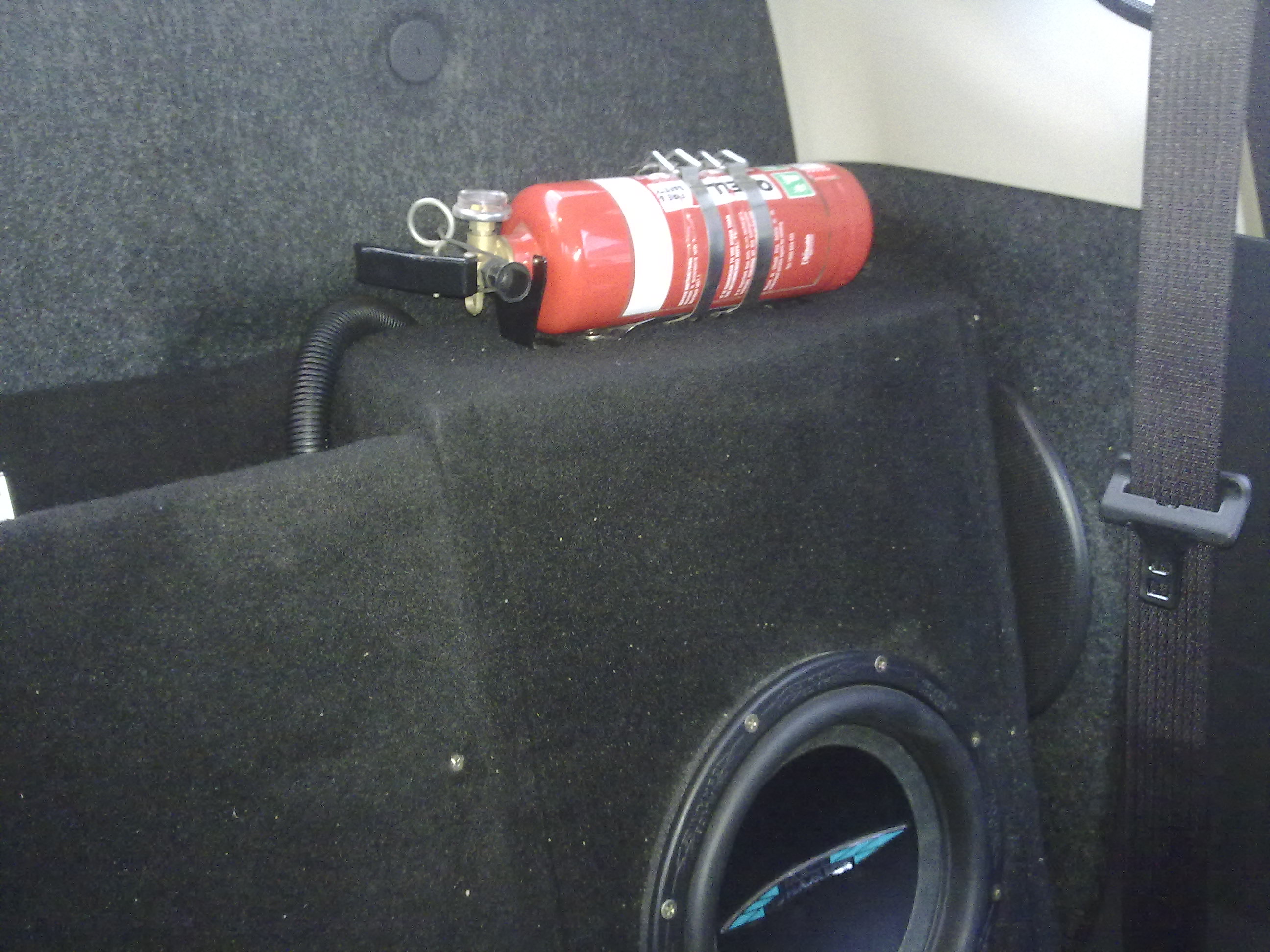

samhouston Donating Members 153 Member For: 15y 11m 20d Gender: Male Location: Brisbane Posted 03/12/09 08:04 PM Share Posted 03/12/09 08:04 PM Good luck actually finding something mate. You will be hard pressed to do that.It is something you have to make yourself. And there is not a lot of room in there.I havent even made a facia for mine yet, it is mounted just below the ICC.I havent had the time to do any more on it. I am going to finish it over the Christmas break.Here is a photo as it is now. Link to comment https://www.fordxr6turbo.com/forum/topic/63912-fg-ute-amp-install/page/3/#findComment-960156 Share on other sites More sharing options...
