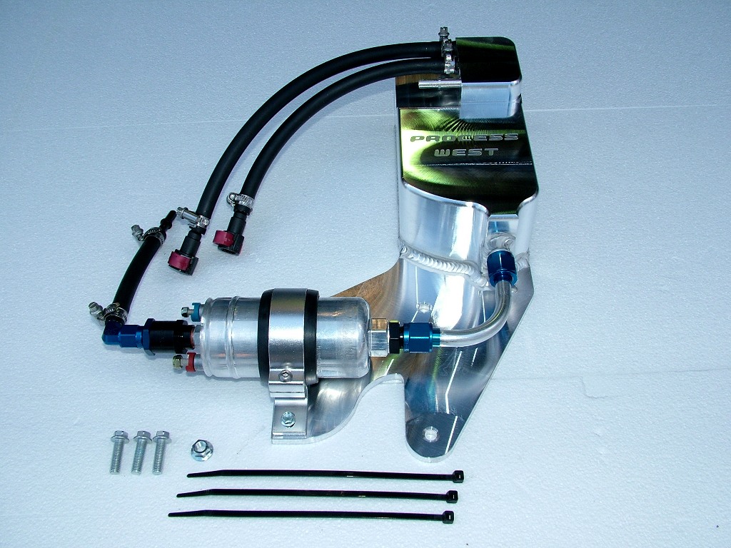

BAturb Member 521 Member For: 20y 4m 28d Gender: Male Location: Adelaide Posted 14/02/12 05:56 AM Share Posted 14/02/12 05:56 AM just out of curiosity, how do my stainless EFI hose clamps differ from these EFI hose clamps? Link to comment https://www.fordxr6turbo.com/forum/topic/63575-surge-tanks/page/16/#findComment-1196058 Share on other sites More sharing options...
Bigkeels Throbbing Member Donating Members 594 Member For: 16y 2m 6d Gender: Male Location: Victoria Posted 14/02/12 06:01 AM Share Posted 14/02/12 06:01 AM I don't understand why people try to get away with no surge tank. As others have said its piece of mine knowing that you don't have to always think "sh*t how much fuel have I got?" before giving it a poke. Stock or 400kw you can still get your car to surge if you boot it up a hill or around a corner, I know this for a fact.So if your spending money on mods and a tune, why not save a little more and just put one in for the insurance. Link to comment https://www.fordxr6turbo.com/forum/topic/63575-surge-tanks/page/16/#findComment-1196063 Share on other sites More sharing options...
Headsex Donating Members 2,528 Member For: 19y 8m Gender: Male Location: Melb Posted 14/02/12 06:06 AM Share Posted 14/02/12 06:06 AM On 14/02/2012 at 5:56 AM, BAturb said: just out of curiosity, how do my stainless EFI hose clamps differ from these EFI hose clamps?Firstly, yours are hose clamps, not efi clamps. The big difference is yours has holes where the thread of the screw pulls against. This will cut into the rubber over time.Secondly, Im sure those clamps were only for show when kev made the unit, but he ships his surge tanks with clamps where you need a special kind of pliers to lock. Although in saying that, those hose clamps are suitable and will not cut into the rubber as there is no holes for the thread. Link to comment https://www.fordxr6turbo.com/forum/topic/63575-surge-tanks/page/16/#findComment-1196066 Share on other sites More sharing options...
