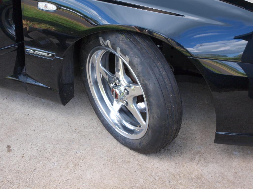

Worm A much better forum Silver Donating Members 3,808 Member For: 16y 8m 22d Gender: Male Location: Victoria Posted 24/06/12 08:40 PM Share Posted 24/06/12 08:40 PM Spiro... Those Tyres look like semis on the rear? Are they for the street?I assume you'll run full slicks? I'm guessing even semis would be pointless with this many ponies!!! Link to comment https://www.fordxr6turbo.com/forum/topic/63278-project-manual-typhoon-9-sec/page/216/#findComment-1258842 Share on other sites More sharing options...
DLM Dragons Lair Motorsport Member 29 Member For: 13y 8m 1d Gender: Male Posted 24/06/12 09:32 PM Share Posted 24/06/12 09:32 PM (edited) On 24/06/2012 at 8:40 PM, Worm said: Spiro... Those Tyres look like semis on the rear? Are they for the street?I assume you'll run full slicks? I'm guessing even semis would be pointless with this many ponies!!!I will be running both my friend, (it isn't pointless when you have the Motec set up this way, you can apply and remove power at will in half a second increments, that's how the boys in the US run 200mph on 28x9 tires Worm) I will dial the car in on semi's and low power, yes they are for the street & then bolt on the full slicks and go nanna's...LOL :sungum: Edited 24/06/12 09:48 PM by DLM 5 Link to comment https://www.fordxr6turbo.com/forum/topic/63278-project-manual-typhoon-9-sec/page/216/#findComment-1258849 Share on other sites More sharing options...

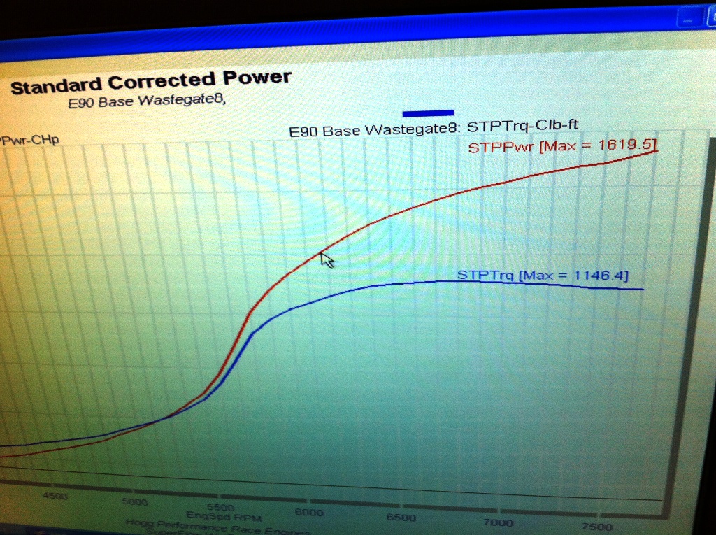

DLM Dragons Lair Motorsport Member 29 Member For: 13y 8m 1d Gender: Male Posted 28/08/12 09:44 PM Share Posted 28/08/12 09:44 PM (edited) The Dragon finally got to see some power runs on the engine dyno yesterday, to say we are pleased with 1600+HP on E90 is an understatement! Further testing today with methanol will be conducted, stay tuned on here and our Face Book wall for updates. Below is a little vid and dyno graph for your enjoyment. Almost forgot to mention that this result as far as we know makes us the most powerful Ford Inline 6 cylinder on the planet! Gotta be happy with that fella's.. This vid is a very early pull, probably the 3rd or 4th pull still sorting out plenty, I dont have footage of the 1600+ but we will take some more video today! Enjoy! Edited 28/08/12 10:13 PM by DLM 1 Link to comment https://www.fordxr6turbo.com/forum/topic/63278-project-manual-typhoon-9-sec/page/216/#findComment-1286664 Share on other sites More sharing options...
