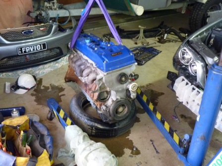

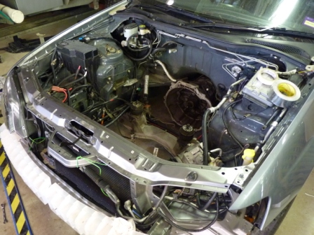

RUS531 RUS531 Donating Members 410 Member For: 18y 8m 1d Gender: Male Location: Emerald QLD Posted 13/11/09 03:00 PM Author Share Posted 13/11/09 03:00 PM Just an update....The engine is now out and dam it was a tight fit... I don't know if it was because of the twin plate clutch on the F6's but there is no room between the firewall and the the top radiator support. I think its gonna be harder to get back in.For those who have done this before is there any special way you found to remove/replace the engine.On inspection of the engine mounts I found one that looks a bit ratty on the top with cracks in the rubber. This one happened to be on the drivers side so I'm thinking that the heat had something to do with it. The opposite side looks perfect so I will just replace the one. Cameron Link to comment https://www.fordxr6turbo.com/forum/topic/62744-help-lost-all-oil-pressure/page/5/#findComment-953655 Share on other sites More sharing options...

RUS531 RUS531 Donating Members 410 Member For: 18y 8m 1d Gender: Male Location: Emerald QLD Posted 13/11/09 11:25 PM Author Share Posted 13/11/09 11:25 PM Brad,This being my first time pulling an engine out, I'm no expert, however these are some things I found.The top bell housing bolts can be a real pain to undo if your car is on the ground and stands. I had to use two extensions and a uni on my socket to get to them.When lifting your engine off the mounts mine wanted to lift from one side first but then the other side eventually came off. Once this happened I supported the gear box with a bottle jack and wiggled the engine forward. Once I got a bit of a gap between the bell housing and the motor I got a BIG flat screw driver (that's all I had at the time) and used it to lever the engine away from the gearbox. I think once it got free of the spigot bearing it became easier, just take your time.As I said it is a VERY tight fit when the motor is just about out of the engine bay. If you found a way that is better or gives you some more room please share. If not, be very mindful of those solid break lines running across the top at the back.No I wont be pulling it apart any further due to I don't have the time before I go back to work and I want it fixed ASAP (I miss cruising in her ) and I really couldn't be bothered lol.If anyone else could add to this for myself and BAF6 that would be awesome guys! Cameron Link to comment https://www.fordxr6turbo.com/forum/topic/62744-help-lost-all-oil-pressure/page/5/#findComment-953728 Share on other sites More sharing options...
blueprintbullet Donating Members 163 Member For: 17y 1m 18d Gender: Male Location: Wanneroo Posted 13/11/09 11:49 PM Share Posted 13/11/09 11:49 PM Try pulling off the hatrmonic balance first gives ya that bit more room Link to comment https://www.fordxr6turbo.com/forum/topic/62744-help-lost-all-oil-pressure/page/5/#findComment-953736 Share on other sites More sharing options...

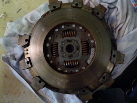

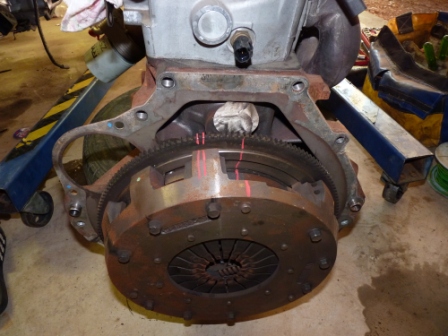

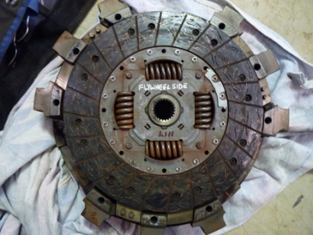

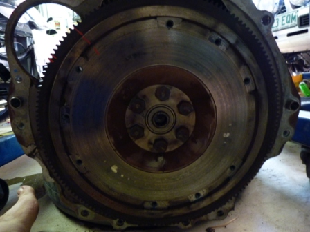

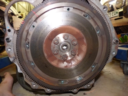

RUS531 RUS531 Donating Members 410 Member For: 18y 8m 1d Gender: Male Location: Emerald QLD Posted 14/11/09 02:50 AM Author Share Posted 14/11/09 02:50 AM (edited) Thanks for the suggestion Blueprintbullet Matt, that doesn't sound good mate. Does your starter motor try to engage? There isn't a safety feature that I know of. What sort of noise did you hear? P.S Here are some new pictures.The clutch. I don't what difference it will make but I marked the clutch assembly and fly wheel. with a paint pen so it can all go together the way it was. I also numbered all the bolts and holes. When lossening off I also did them bit by bit in a cross pattern.Here's a couple of pictures of the flywheel and the flywheel side friction plate and pressure plate.I wasn't going to bother taking it apart to look at the other plates.Tell me what you think cause I don't know much about clutches at all, however apart from the couple of bright spots I thought it looked pretty good. It has done 73000ks Edited 14/11/09 02:59 AM by RUS531 Link to comment https://www.fordxr6turbo.com/forum/topic/62744-help-lost-all-oil-pressure/page/5/#findComment-953784 Share on other sites More sharing options...
