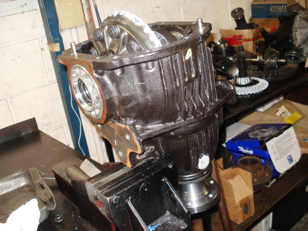

Johnny G Team Grandpa Qualified Donating Members 809 Member For: 19y 10m 21d Gender: Male Location: Brisbane North. Posted 20/10/09 09:33 AM Share Posted 20/10/09 09:33 AM (edited) Guys - my diff rebuild finished today, thanks to the guys at Haart Transmissions at Brendale.Opted for a factory Ford LSD and couldn't be happier with the result. No doubt about it - way, way improved over the diff in my BF2; backlash tollerances are spot on, absolutely no noise (let alone clunking) on roll on roll off, or at speed. Performance charactertistics of the car are changed completely - no issues powering out of corners; it does cross up a bit before intervention from software, but it's quite predictable. Wet weather next week so will let you know what happens after some judiscious gentle experimenting. If the dry is any indication, it will be perfect from the software perspective.Photographic series follows - cage in, cage out, rebuild, and then re-install. Will post more soon in a second post. Edited 20/10/09 09:40 AM by Johnny G Link to comment Share on other sites More sharing options...

G6ET8U Playing with Sports Bikes... Silver Donating Members 1,927 Member For: 19y 2m 5d Gender: Male Location: Whistling, GTX. Posted 20/10/09 10:18 AM Share Posted 20/10/09 10:18 AM What kind of $ did that set you back mate compared to the $2200 for the Trutrac?CheersJack Link to comment Share on other sites More sharing options...
Johnny G Team Grandpa Qualified Donating Members 809 Member For: 19y 10m 21d Gender: Male Location: Brisbane North. Posted 20/10/09 10:44 AM Share Posted 20/10/09 10:44 AM Day Jack,Retail would be about $700 to $900 less than that at a guess.... not absolutely sure, but that would be close.JG Link to comment Share on other sites More sharing options...
