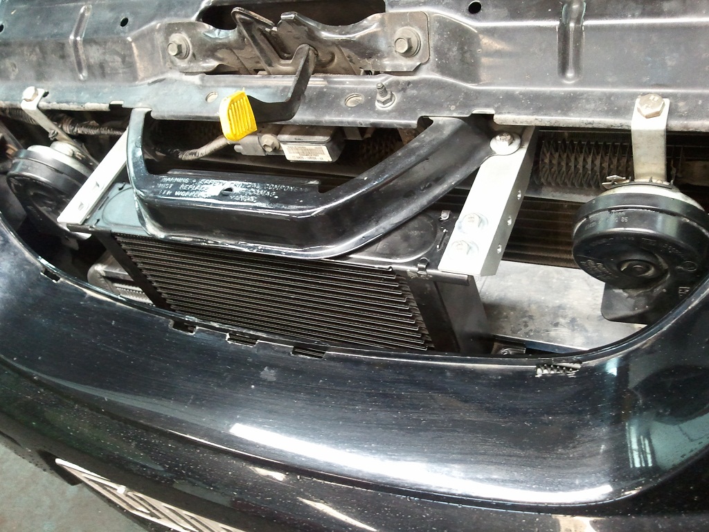

riptide Member 733 Member For: 14y 2m 28d Gender: Male Location: Auckland, New Zealand Posted 23/11/11 06:33 AM Share Posted 23/11/11 06:33 AM I will be fitting an oil cooler to my ZF trans replacing the heat exchanger in my BF and I have an HDi intercooler. Have bought a Setrab cooler std 619 http://alertmotorsport.com/Product/Oil+Coolers+600+Series/4134 which will sit above the intercooler quite nicely by the look of it. I think it would be as good as the one at the start of this thread because it's 50m/m thick and a similar width although it's a little shorter. I'm assuming the three dimensions multiplied together will give a fair idea of their cooling ability. Does anyone know if the LM2 can log auto temps?I will post some pics when I've finished the install. Link to comment https://www.fordxr6turbo.com/forum/topic/61088-trans-cooler-install/page/6/#findComment-1162291 Share on other sites More sharing options...
riptide Member 733 Member For: 14y 2m 28d Gender: Male Location: Auckland, New Zealand Posted 14/12/11 07:42 AM Share Posted 14/12/11 07:42 AM Have nearly finished the prep work for fitting the air/oil cooler tomorrow night.This is the joiner unit I made to replace the heat exchanger, retaining the trans pipe fittings so the hoses don't need changing. If I sell the car it will be easy to return to stock (not like the rest of it ) 1 Link to comment https://www.fordxr6turbo.com/forum/topic/61088-trans-cooler-install/page/6/#findComment-1169107 Share on other sites More sharing options...

riptide Member 733 Member For: 14y 2m 28d Gender: Male Location: Auckland, New Zealand Posted 15/12/11 08:37 AM Share Posted 15/12/11 08:37 AM Finished the installation tonight and have booked in for a trans service Saturday morning. It's a relief getting the heat exchanger out especially since one of the pipes was bent when the previous motor chopped the sump in half.Install went fairly smooth except for getting covered in coolant working under the hoist. Looks much neater from underneath and there is a lot more room. Link to comment https://www.fordxr6turbo.com/forum/topic/61088-trans-cooler-install/page/6/#findComment-1169491 Share on other sites More sharing options...
