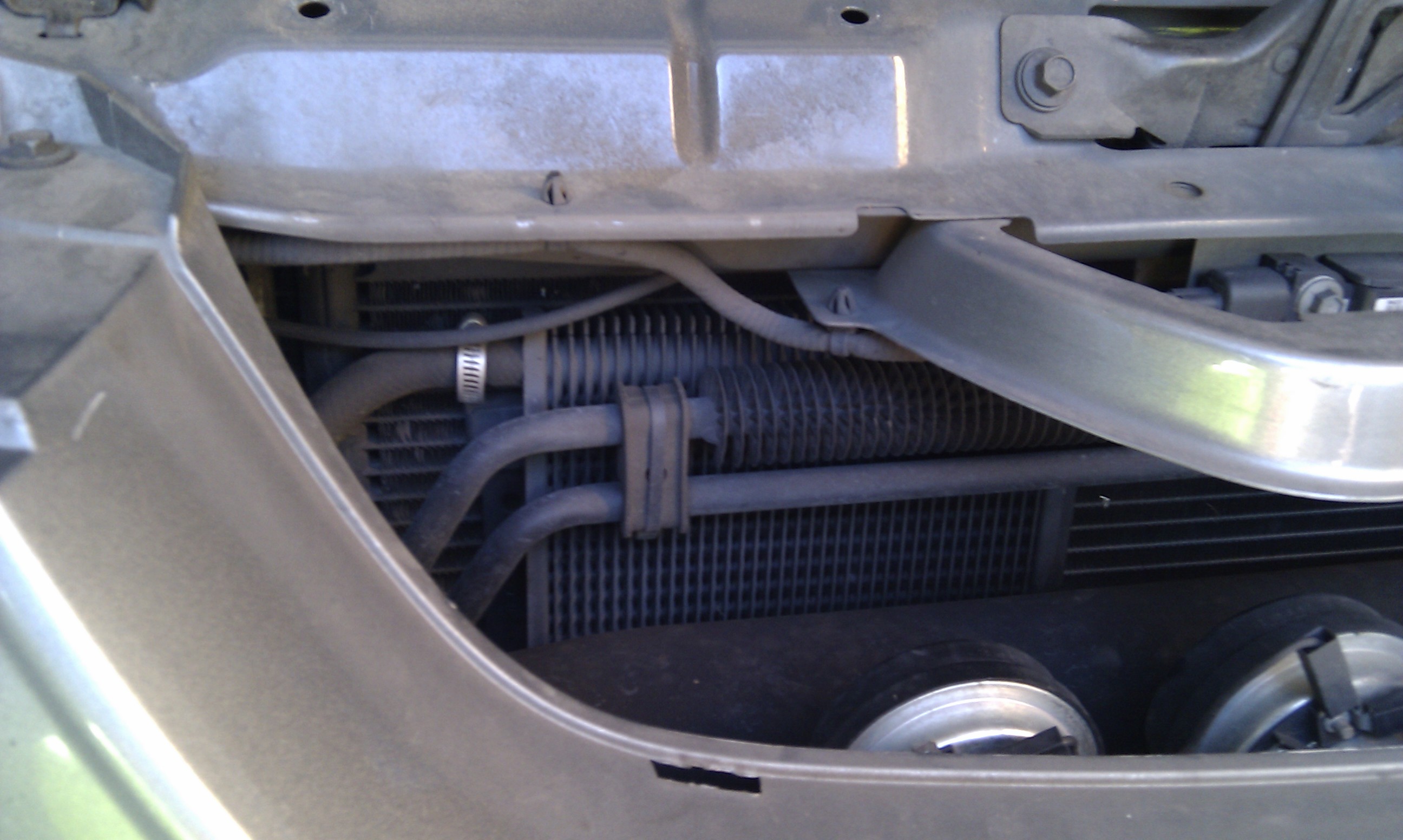

bjcrown Donating Members 182 Member For: 19y 5m 27d Posted 14/06/11 10:17 AM Share Posted 14/06/11 10:17 AM Guys,As per attached picture, I have a tranny cooler (for my 4sp) fitted to my car but is in series to the radiator.This "size" of this cooler is: 19cm x 25cm x 1.9cm.I'm now thinking of bypassing the radiator.Is this cooler large enough OR should I replace it?Thanks... Link to comment https://www.fordxr6turbo.com/forum/topic/61088-trans-cooler-install/page/5/#findComment-1114252 Share on other sites More sharing options...
Maximus Member 1,627 Member For: 18y 1m 4d Gender: Male Location: Slip Sliding Away Posted 14/06/11 11:06 AM Author Share Posted 14/06/11 11:06 AM I am not sure if it will cope with heavy duty towing or high load for long periods of time but betting the fluid out of the radiator loop can only be a good thing.Yours is installed right up high, where I should of put mine, and would get more air flow so it should be fine. Link to comment https://www.fordxr6turbo.com/forum/topic/61088-trans-cooler-install/page/5/#findComment-1114279 Share on other sites More sharing options...
