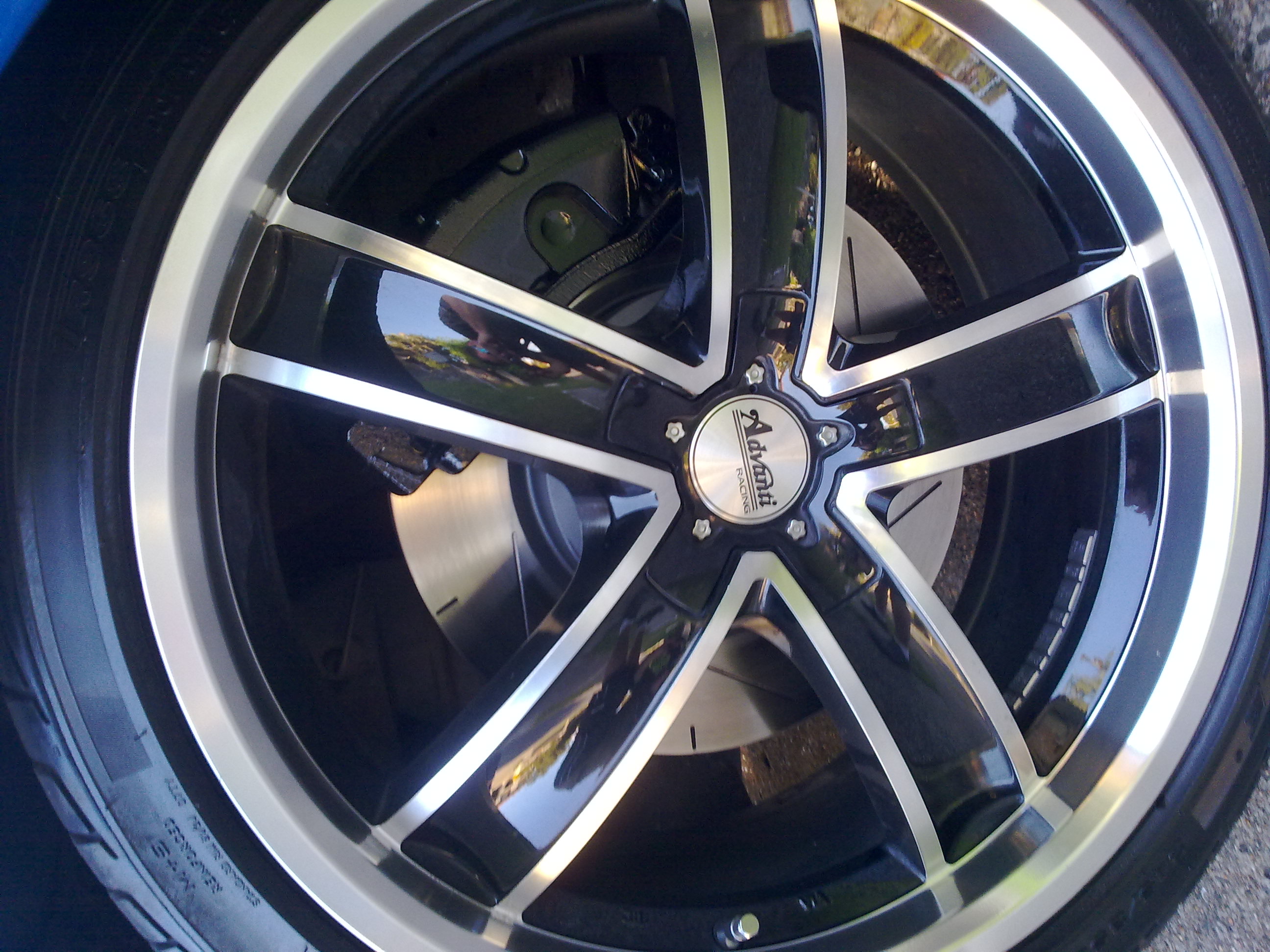

majin Member 40 Member For: 17y 10m 8d Gender: Male Location: BrisVegas Posted 30/07/09 07:19 AM Author Share Posted 30/07/09 07:19 AM Well, thanks Adam! Ford pretty much said the same thing. Its just a bit sad I think, to keep switching the brakes over. 328 Rears would of been good but I guess the fronts do most of the work anyhow!Sorry if I seemed to go off the wall....was just really surprised but I'm happy nowGot it done today, DBA Slotted in front, bendix ultimates front and rear and some decent fluid, left the rear discs alone.What can I say, whoever is thinking about doing this and isn't sure, let me tell you that it is a must for ALL XR6's turbo or non and XR8's! Lots more response, better feel, don't find yourself braking to hard and the harder you are, the better they get! Attached a photo to Link to comment https://www.fordxr6turbo.com/forum/topic/59988-303mm-rears-on-a-bfmkii-turbo/page/2/#findComment-914352 Share on other sites More sharing options...
