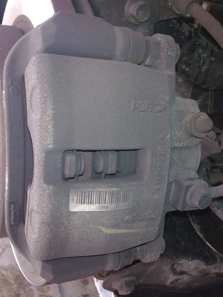

discostig Manual mode ________________________ All day, erryday Donating Members 13,798 Member For: 17y 6m 28d Gender: Male Location: Probably above atmospheric pressure Posted 26/07/09 05:58 AM Share Posted 26/07/09 05:58 AM (edited) Here's a pic of my back brakes...May 07 build.Solid as a rock hahaha.At least they are PBR calipers heh...how many piston are the rears? Just one yeah? Edited 26/07/09 05:59 AM by -SteveR- Link to comment https://www.fordxr6turbo.com/forum/topic/59988-303mm-rears-on-a-bfmkii-turbo/#findComment-912143 Share on other sites More sharing options...
