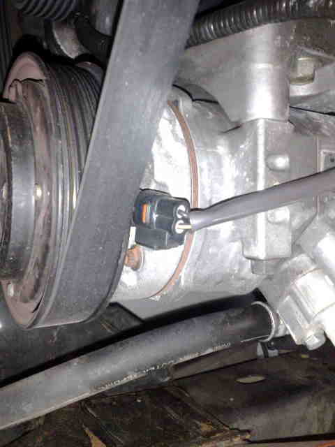

Tocchi Sandtrap Motorsport Donating Members 2,055 Member For: 16y 5m 17d Gender: Male Location: Perth Posted 22/07/09 08:28 AM Share Posted 22/07/09 08:28 AM Fly By wire?TPS right?are these for the aircon?ive connected everything else up (injectors, dvct, coilpacks, timing cover sensor, rear of head sensors, map sensor, tps, fbw, block sensors, oil pressure connecter) etc Link to comment https://www.fordxr6turbo.com/forum/topic/59869-urgent-6t-engine-loom-connectors-identification/ Share on other sites More sharing options...
ALF05T Member 453 Member For: 18y 3m 27d Gender: Male Location: Sydney Posted 22/07/09 09:08 PM Share Posted 22/07/09 09:08 PM Is it the oxygen sensor on the dump pipe behind the turbo? Link to comment https://www.fordxr6turbo.com/forum/topic/59869-urgent-6t-engine-loom-connectors-identification/#findComment-910625 Share on other sites More sharing options...

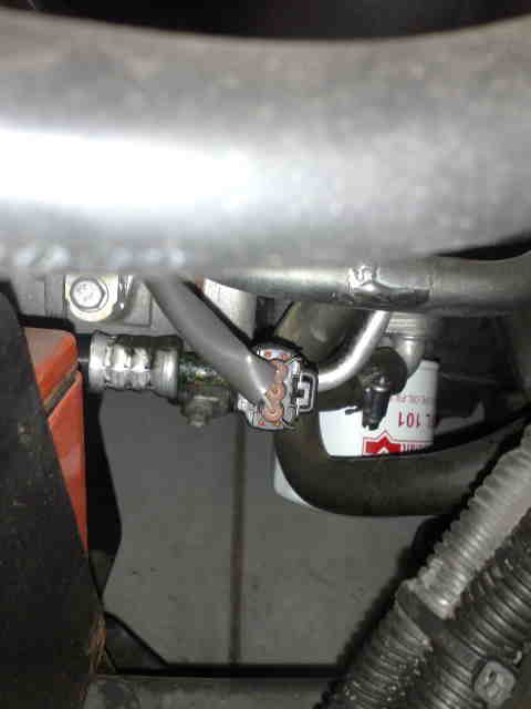

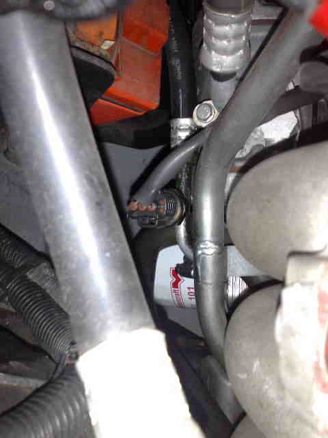

Tocchi Sandtrap Motorsport Donating Members 2,055 Member For: 16y 5m 17d Gender: Male Location: Perth Posted 23/07/09 01:22 AM Author Share Posted 23/07/09 01:22 AM (edited) nah, I should of actually given some more details, these are attached to the main engine loom, and outstretch to near where the aircon compressor would go.(note: dont have aircon compressor) Edited 23/07/09 01:23 AM by Tocchi Link to comment https://www.fordxr6turbo.com/forum/topic/59869-urgent-6t-engine-loom-connectors-identification/#findComment-910689 Share on other sites More sharing options...
Ralph Wiggum Moar Powar Babeh Lifetime Members 19,332 Member For: 19y 7m 18d Gender: Male Location: Perth Posted 23/07/09 02:02 AM Share Posted 23/07/09 02:02 AM Tocchi,The two pin plugs is A/C Clutch,3 wire (plug missing) is A/C Hi/Lo pressure switch Link to comment https://www.fordxr6turbo.com/forum/topic/59869-urgent-6t-engine-loom-connectors-identification/#findComment-910698 Share on other sites More sharing options...
Tocchi Sandtrap Motorsport Donating Members 2,055 Member For: 16y 5m 17d Gender: Male Location: Perth Posted 23/07/09 02:25 AM Author Share Posted 23/07/09 02:25 AM THANK YOU HEAPS !!!the engine loom & motec get wired up start of next week so it was good timing Link to comment https://www.fordxr6turbo.com/forum/topic/59869-urgent-6t-engine-loom-connectors-identification/#findComment-910703 Share on other sites More sharing options...
