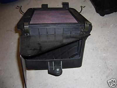

Redback Banned 236 Member For: 15y 3m 12d Gender: Male Location: Blacktown NSW Posted 22/07/09 10:11 PM Share Posted 22/07/09 10:11 PM Here is a mod you can do to your air box. Link to comment Share on other sites More sharing options...
stevet Member 85 Member For: 16y 5m 12d Posted 23/07/09 02:42 AM Share Posted 23/07/09 02:42 AM Im in the same situation lost my top snorkle when I upgraded my intercooler and I just cut a hole for the typhoon snorkle but never bought a snorkle. I have been wondering the same thing if there was any point getting the F6 snorkle and covering the old hole for the top snorkle? Looks like redbackalarms has a great setup. Link to comment Share on other sites More sharing options...
Redback Banned 236 Member For: 15y 3m 12d Gender: Male Location: Blacktown NSW Posted 23/07/09 05:21 AM Share Posted 23/07/09 05:21 AM (edited) I can't take credit for the photo. Someone was selling this setup on ebay so I saved the picture should I ever want to make one. I ended up finding an APS intake so I never got around to this. It does look like a simple mod using only a sheet of say 3mm alloy cut to size and riveted to the box. Keeps the hot air out and feeds from behind the headlight. Seems like a $20 job. Edited 23/07/09 06:50 AM by Adam Link to comment Share on other sites More sharing options...
Full Monty Member 513 Member For: 17y 3m Gender: Male Location: Melbourne Posted 23/07/09 05:56 AM Share Posted 23/07/09 05:56 AM I was thinking about running some 4" flexi hose I have made for auto/cooling/ducting and running it from the opening downward and attach it to the rear edge of the bumper wind tray thingie - maybee put some mesh over the end of the hose to stop it picking up leaves etc. Link to comment Share on other sites More sharing options...
