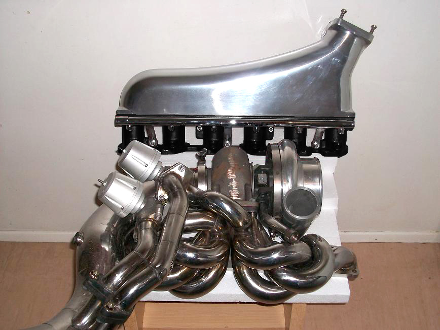

straughsberry Donating Members 1,846 Member For: 17y 8m 26d Gender: Male Location: Broady, Melbourne Posted 22/07/10 07:41 AM Author Share Posted 22/07/10 07:41 AM Finally the valves have arrived. We can now finish the head and begin engine assembly. Intake is 2mm larger and exhaust is .5mm larger in inconel and both are a single groove. I haven't weighed them yet but they seem very light.Also got a pic of completed turbo manifold, plenum and runners from Snort. They look awesome in the pic. Can't wait to see them in the flesh. The new 1200 plenum and runners have some neat features. Snort Iceman 1200 full replacement plenum to suit EA-AU and BA-BF 4.0 litre Falcons. Solid cast aluminum available polished, satin and powder coated. 2 Piece design, larger volume, 44-38mm tapered runners with shorter intake. Retail is $1299. Great price for this kind of setup with flexibility to custom port the runners as Geoff has told me he's designed them with plenty of meat. They will also suit throttle bodies from stock to 90mm. Link to comment https://www.fordxr6turbo.com/forum/topic/55789-the-build-has-begun/page/22/#findComment-1026635 Share on other sites More sharing options...
