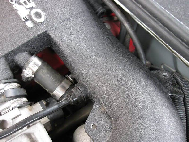

CarCycle Member 65 Member For: 16y 4m 27d Gender: Male Location: West Lakes, Adelaide Posted 10/02/09 12:26 PM Share Posted 10/02/09 12:26 PM (edited) Hi all,I have a bit of a question here... where the heck is my BOV!?I bought my xr6T as it is, and it does make a very loub BOV sound when its meant to but I dont know where it is... please see the photo below and any help/suggestions would be helpful... It resonates through the exhaust well and sounds great so there must be one somewhere?Reason I ask is im concerned that this setup is a bit dodgy??? and also I have to get the car inspected soon so if I find out if its obvious or not then I may or may not have to remove it....or its not dodgy and is a top setup!? can someone please explain to me why it would be this way Alex. Edited 10/02/09 12:27 PM by CarCycle Link to comment https://www.fordxr6turbo.com/forum/topic/54440-help-with-bov-location-please/ Share on other sites More sharing options...
senna_T Forged Member Lifetime Members 15,818 Member For: 18y 2m 25d Gender: Male Location: SW Sydney Posted 10/02/09 12:31 PM Share Posted 10/02/09 12:31 PM Looks like the previous owner has removed the Factory BOV mate. It should be at the back of the Crossover. As you can see there is a fitting left open there, I would be blockin that off as it will be sucking in un-filtered air.The arguement For and Against BOVs will rage on forever, but I would suggest you get one bud Link to comment https://www.fordxr6turbo.com/forum/topic/54440-help-with-bov-location-please/#findComment-820569 Share on other sites More sharing options...
CarCycle Member 65 Member For: 16y 4m 27d Gender: Male Location: West Lakes, Adelaide Posted 10/02/09 12:39 PM Author Share Posted 10/02/09 12:39 PM (edited) hey senna thanks for that...was just reading some of the other bov threads...so what youre saying is there is no Blow off valve at all? Is that "legal"?The bottome pipe on the photo is blocked off (in the end of that bit of hose) is that related?Sorry, trying not to sound too stupid! Just dont know anything about turbos and bov's etc! Hmm... so at this stage teh sugegstion is to block off that top fitting, but eventually getting a bov on it? Edited 10/02/09 12:40 PM by CarCycle Link to comment https://www.fordxr6turbo.com/forum/topic/54440-help-with-bov-location-please/#findComment-820573 Share on other sites More sharing options...
our06t Mmmmm......BOOST Member 3,135 Member For: 18y 4d Gender: Male Location: central coast Posted 10/02/09 08:17 PM Share Posted 10/02/09 08:17 PM (edited) block that open pipe NOW that is sucking unfiltered air straight into you turbo and engine ,whoever left that like that should be shotthis is my set up gfb after market valve ,you can get the turbo smart one that is a direct replacement for the factory one. Edited 10/02/09 08:20 PM by our06t Link to comment https://www.fordxr6turbo.com/forum/topic/54440-help-with-bov-location-please/#findComment-820639 Share on other sites More sharing options...
CarCycle Member 65 Member For: 16y 4m 27d Gender: Male Location: West Lakes, Adelaide Posted 11/02/09 12:15 AM Author Share Posted 11/02/09 12:15 AM so youve got the top whole blocked off and the bov attached to the bottom one? (does that make sense) ...mine has the bottom blocked off and the top open... im guessing now that the last owner nicked the bov off it and just left it? but the strange thing is it makes one hell of a bov type noise though... would it still do that if theres no bov anywhere? and what will happen if I block off that top one making both those wholes blocked?thanks all for your advise, trying to understand the whole concept before jumping in and ruinings something. Link to comment https://www.fordxr6turbo.com/forum/topic/54440-help-with-bov-location-please/#findComment-820705 Share on other sites More sharing options...
our06t Mmmmm......BOOST Member 3,135 Member For: 18y 4d Gender: Male Location: central coast Posted 11/02/09 01:11 AM Share Posted 11/02/09 01:11 AM (edited) that noise is compresser surge when the air is trying to get back passed the turbo,if you just block the other hole that sound will stay it will just stop crap getting into the engine , just buy some rubber chair leg ends 25mm from the hardware shop only a couple of bucks and clamp one on that open pipe asapif you fit a bov then you will get the air venting soundyou crossover hasn't been bolted back on properly either ,I think it might have had some after market bits on it that have removed before the sale? Edited 11/02/09 01:17 AM by our06t Link to comment https://www.fordxr6turbo.com/forum/topic/54440-help-with-bov-location-please/#findComment-820729 Share on other sites More sharing options...
Guest Guests Posted 11/02/09 01:18 AM Share Posted 11/02/09 01:18 AM Leave that hole open, buy thishttp://www.fordxr6turbo.com/forum/index.ph...c=54400&hl=Then fit an aftermarket BOV that is plumbed back into the intake through said open hole. That's a completely legal setup & as you are going for a pit inspection you'd wanna keep it legal Link to comment https://www.fordxr6turbo.com/forum/topic/54440-help-with-bov-location-please/#findComment-820732 Share on other sites More sharing options...
RSK Member 340 Member For: 17y 7m 19d Gender: Male Posted 11/02/09 01:25 AM Share Posted 11/02/09 01:25 AM Yeah, the top opening in the crossover needs to be blocked off. Headover to bunnings and find a chair stop to fit onto it and a washer to tighten it up.The lower one is as you've avised blocked off? Or is there a BOV attactched?There still however is the issue of the vaccum line, which is a thin hose attatched to the BOV which causeses it to open/close on/off throttle. This should also be blocked off, and with the pics can't tell. To locate it, look behind the crossover, and there should be gold/dark goldish metal pipe (maybe 3mm wide) that has a nipple comming off it. This should be blocked off, as it would be going to the top of the BOV (if there was one). Link to comment https://www.fordxr6turbo.com/forum/topic/54440-help-with-bov-location-please/#findComment-820740 Share on other sites More sharing options...
our06t Mmmmm......BOOST Member 3,135 Member For: 18y 4d Gender: Male Location: central coast Posted 11/02/09 01:26 AM Share Posted 11/02/09 01:26 AM (edited) I know some one is trying to sell this pipe , but that would be the last thing I would fit before going to the pit inspect it's not factory even if you do stuff around run a plumback hose for it ,it will give them something to lookat ,If you just left them both blocked the inspecters probably won't say anything ,I don't think it is illegal to have no bovit looks like it may have a boost gauge running off the vac line Edited 11/02/09 01:28 AM by our06t Link to comment https://www.fordxr6turbo.com/forum/topic/54440-help-with-bov-location-please/#findComment-820741 Share on other sites More sharing options...
RSK Member 340 Member For: 17y 7m 19d Gender: Male Posted 11/02/09 01:28 AM Share Posted 11/02/09 01:28 AM Actually, you can see where the vaccum lines goes in the first pic our06t posted Link to comment https://www.fordxr6turbo.com/forum/topic/54440-help-with-bov-location-please/#findComment-820742 Share on other sites More sharing options...
