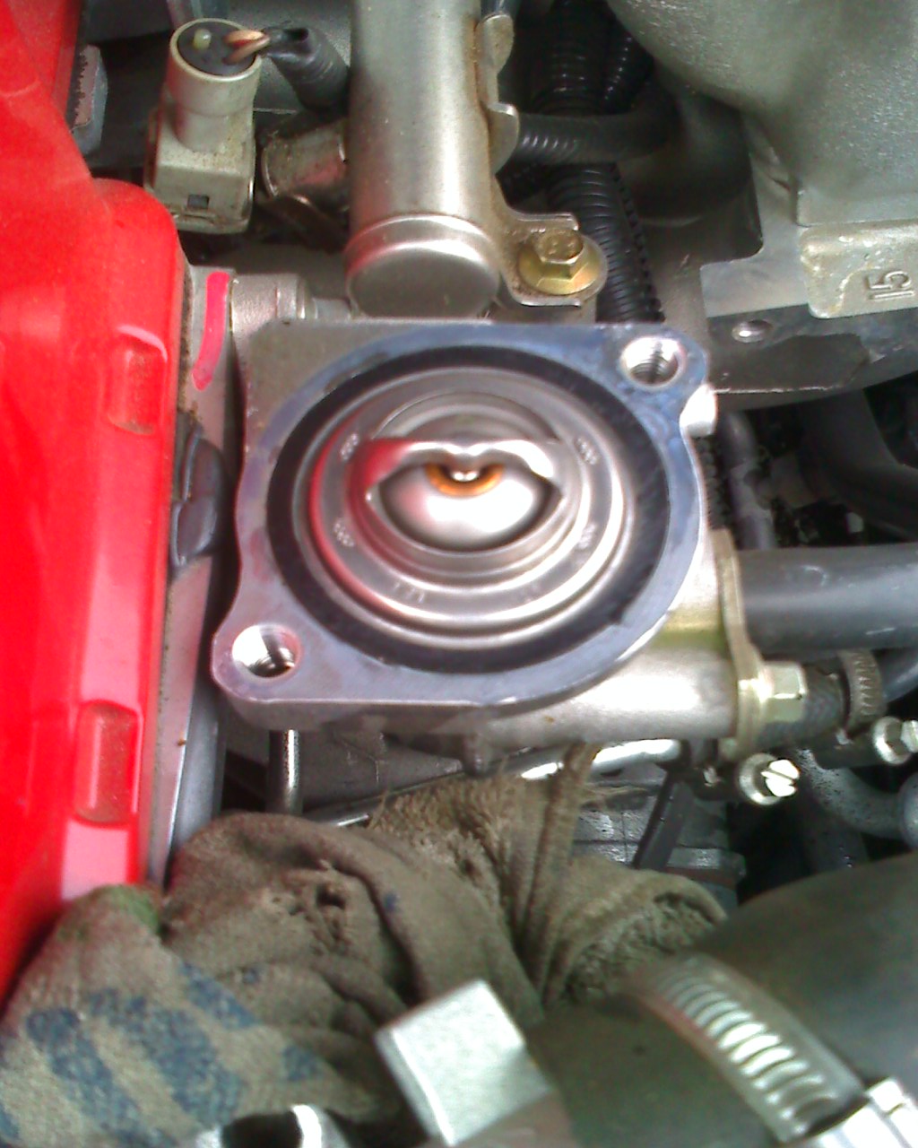

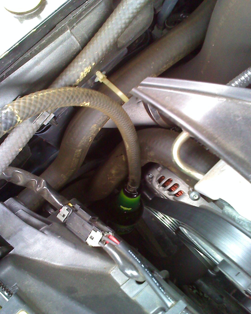

SAPNEN Donating Members 278 Member For: 17y 1m 2d Gender: Male Posted 10/02/09 08:26 AM Share Posted 10/02/09 08:26 AM waSAPNEN all? This next post will show you how bored I am (currently unemployed)Changing the thermostat from original '92degC' to a '82degC High Flow' will lower you running temperature... and this is cooooolyou will need: 13mm socket + extension arm Pliers 1lt De-mineralised water 54mm High Flow 82degC (180degF) Thermostat Rubber Gasket Beer bottle BeerThermostsat part numbers for TRIDEN TT2000-192 - 89°C High flow TT2000-190 - 88°C High flow TT2000-180 - 82°C High flow TT2000-170 - 77°C High flow This is the Thermostat I managed to find... MARKIV Automotive DT66A 82degC or 180degF = $29.00This is the gasket... DAYCO DTG11 Thermostat Gasket = $1.95Make sure your engine is cool for this!!! This is where the Thermostat is hiddenNow, release the expansion tank cap. Use your pliers to remove the clamp on the overflow hose and remove the hose. You will now know if you have left the engine too hot cause you'll be scoulded!Put the hose into your empty (clean) beer bottle to catch any overflowUse the power of gravity to fill your beer bottle... as shownRemove the 2 bolts holding the jigger onto the whatsit (13mm socket)Take out the old Thermostat (yes it will come straight out nice and easy). Now before putting in the new one put the gasket on!!!Put the new one in.Put the Jigger back onto the whatsit and put the 2 bolts back in... (13mm socket)Put the hose back onto the expansion tank, and put the clamp back on (with ya pliers)Now, depending on how much water you lost in the process of this depends on how much you will need to top up in your expansion tank, this is where the de-mineralised water will come in handy. Don't stress about coolant, its just a top up... DON'T mix different coolantsDON'T use tap water to top upDON'T overfill expansion tankHappy Boostn' Link to comment https://www.fordxr6turbo.com/forum/topic/54429-82degc-thermostat-install/ Share on other sites More sharing options...
