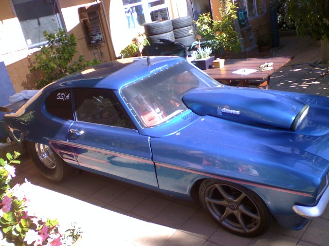

Tocchi Sandtrap Motorsport Donating Members 2,055 Member For: 16y 3m 12d Gender: Male Location: Perth Posted 04/02/09 02:09 AM Share Posted 04/02/09 02:09 AM this is my drag car. I bought it off Mike Naylor (trublugt) to do burnouts in quiet streets.I got mike to rip out the Clevo 383 and im putting in my spare Phoon motorif ive read correctly, I can get 450rwkw before the Std bottom end fails. and the turbo is good for nearly that too (with modifications to actuator and gate). so sticking with stock motor and GT3540, but ill need oil pump gears because stock ones fail at under 350rwkw or soI dont have the full mod list yet, getting that soon from Mike1971 full chassis CapriChassis: by pro built engineering and Bryne Race cars.Paint: 2 pac blueprint with phantom and pink graphics by Jim Negro.body: 1 Piece fibreglass front clip, bumpers and bootlid, Lexan windows, rear wing (adjustable)Suspension/Brakes: ladder bars, spax rears and strut front, discs all round, deist chuteDiff: 9inch nodular 35 spline full romac spool, 4.56 richmond gears, fresh. Moser 35 spline axles and final drive shaft. Fuel System: front mount fuel cell,Cooling system: alloy radiatorWheels: cragar superlites 15x12 and 15x3.5, mickey thompson 31x13's, goodyear frontsElectrical: autometer guages, dedenbear delaybox, odyssey batteryInterior: simpson camlock harness, hornet seat, left hand drive.Parts I have:Motec M800 ecuBA F6 motorBarra to Powerglide bellhousingNitto intake plenum (with billet fuel rail)Siemens Deka II 60Lb injectors6 Boost high mount manifold (ceramic coated)GT3540 (ported actuator)TO DO:cooling system→ Keep radiator→ electric water pump? runs in line... not direct replacementturbo stuff→ oil/water lines → custom SPEEDFLOW lines required→ intake plenum → Nitto → PURCHASED→ intercooler & piping→ GT3540 → PURCHASED→ 4" dump → purchase SMB or manufacture?→ exhaust→ BOV → SSQV ? (to piss off *beep*)→ Pod filter mounted/bolted in scoop with intake directed to itfuel system→ injectors → Siemens Deka II 60Lb injectors (run out at 350rwkw) → PURCHASED→ fuel pump → Aeromotive 'red' series 1100hp EFIengine→ motor should be fine to bolt up→ serpentine belt path / length (just harmonic balancer and alternator)→ bigger throttle body? 80mm? 3” = 76.2mm→ get oil sensor off Bainy !!!→ oil pump gearselectrical→ engine looms into cabin→ wire in Motec ecu→ purchase Motec SDL (dash)→ sensors!!!!!→ utilise the fly by wire electronic throttle option?driveline→ buy powerglide→ high stall→ bellhousing to suit motor → Dellow Automotive → PURCHASEDengine baythe carthe new motor to go incar ran 8s with the Clevo pumping out 650hp, ill be looking at 500+ with the phoon motor setup.once I get a handle on driving it, ill up the power/mods and the times should get better oh and big thanks to gerrin for 'finding' this for me appreciate it I got bored and put R34 GTR rims on it... well the front, cos the rear rims/tyres weigh as much as me... so just front were done Link to comment Share on other sites More sharing options...
XF Falcon <put funny sh*t here> Member 3,365 Member For: 18y 4m 1d Gender: Male Location: Perth, NOR Posted 04/02/09 02:28 AM Share Posted 04/02/09 02:28 AM (edited) hehe looks alright with those skyline rims on it Have fun at the Leedy tonight with Barry (if you're going), I can't make it tonight :( Edited 04/02/09 02:32 AM by XF Falcon Link to comment Share on other sites More sharing options...

Guest Guests Posted 04/02/09 05:44 AM Share Posted 04/02/09 05:44 AM Only Problem I can see Tocchi, the BA Phoon motor & turbo probably wont like 450rwkw depending on km's & how long it's been sitting idle. Even BF motors with lowish km's are hit & miss above 400...Also, Siemens are good for 450rwkw+ easy, not the 350 you've stated above.Can't wait to see this at the track though mate! Just keep it out of the snake pit cause I'd hate to see it in the wall Link to comment Share on other sites More sharing options...

Tocchi Sandtrap Motorsport Donating Members 2,055 Member For: 16y 3m 12d Gender: Male Location: Perth Posted 04/02/09 06:14 AM Author Share Posted 04/02/09 06:14 AM 03XR6T said: Only Problem I can see Tocchi, the BA Phoon motor & turbo probably wont like 450rwkw depending on km's & how long it's been sitting idle. Even BF motors with lowish km's are hit & miss above 400...Also, Siemens are good for 450rwkw+ easy, not the 350 you've stated above.Can't wait to see this at the track though mate! Just keep it out of the snake pit cause I'd hate to see it in the wall yeh true. its been sitting around in my shed (and in the ute) since late 2007 (LOL) .. its got 22,000km on it.the car weighs 2300Lb (with driver and 383, so it should be the same for the F6 and turbo), so its not going to take much power to run 9s for example.and 9s on a stock motor would be impressive ill definately have to keep an eye on the motor's condition as I bump up the power.oh awesome regarding the injectors :Dhaha shoosh regarding the pit :Pbtw, ive been quoted for Kosteki oil pump gears, $460is that good? Link to comment Share on other sites More sharing options...
