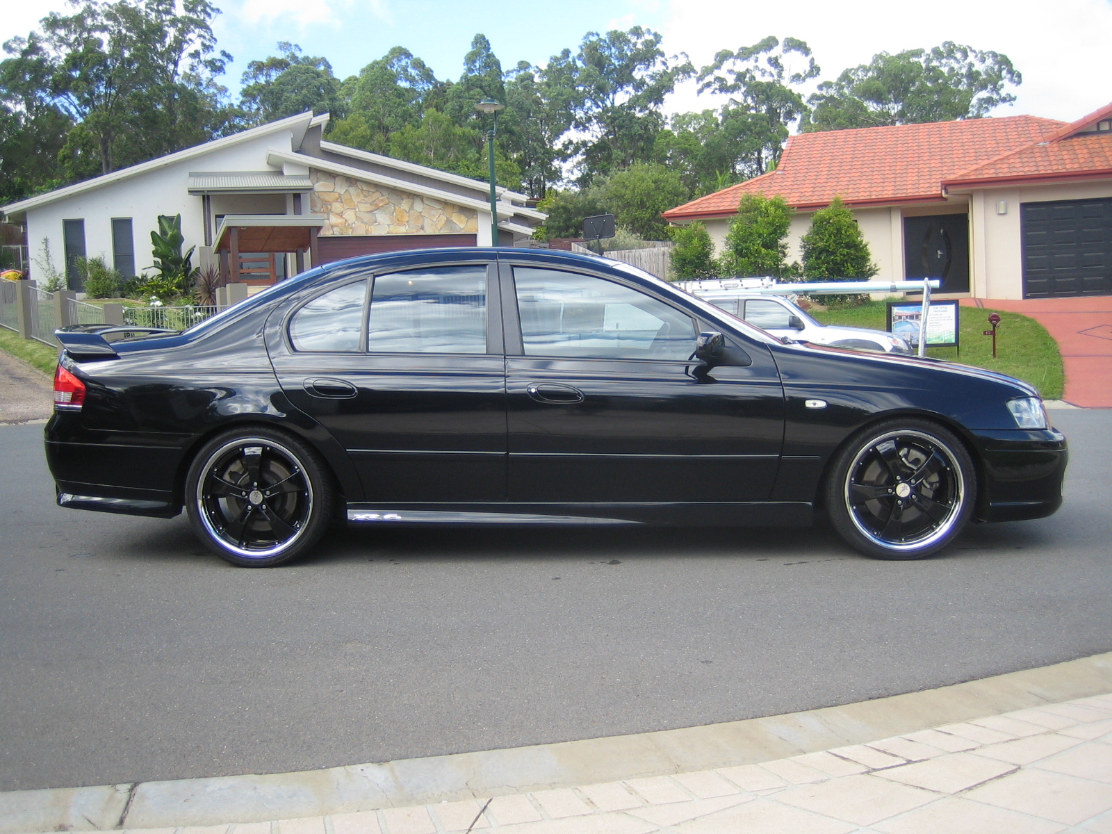

TCR Donating Members 138 Member For: 16y 6m 5d Gender: Male Location: Brisbane Posted 08/02/09 01:47 AM Author Share Posted 08/02/09 01:47 AM Here are the after photos as promised.After a couple of days the ride heights are 345mm on the front and 350mm on the rear. So it has dropped approx 20mm on thre front and 25mm on the rear. Not sure if they'll settle any more but pretty happy with how it sits now. Link to comment Share on other sites More sharing options...
EZ2CME Formerly XR6NA Member 3,512 Member For: 19y 2m 19d Gender: Male Location: Brisbane Posted 08/02/09 03:33 AM Share Posted 08/02/09 03:33 AM Looking very good now Link to comment Share on other sites More sharing options...
