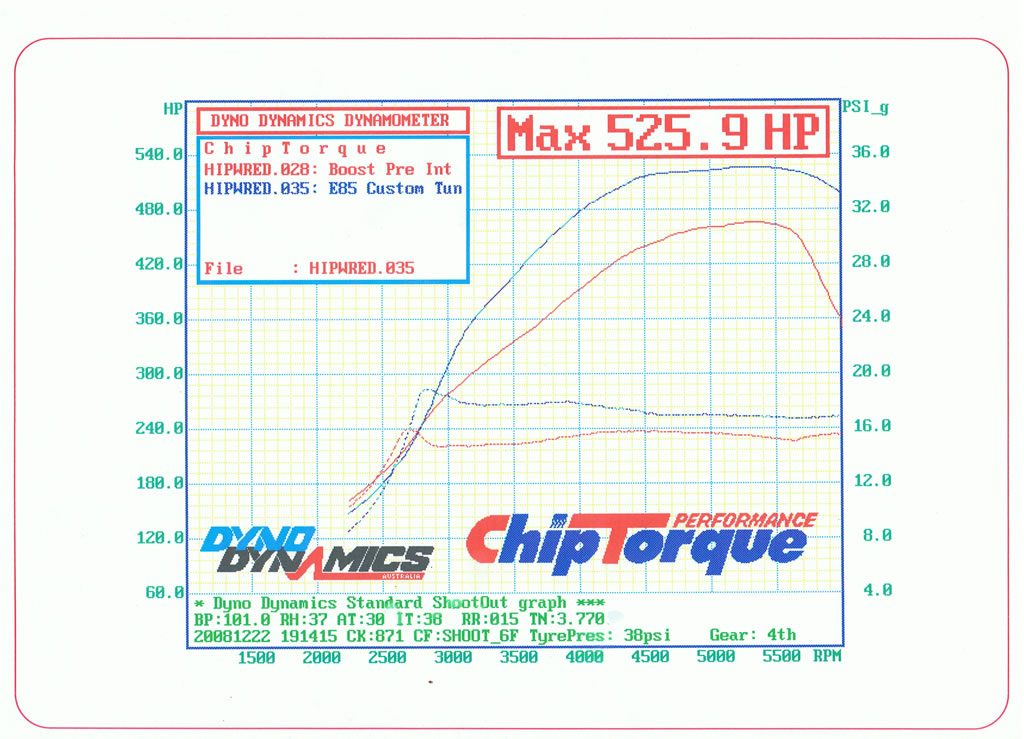

HIPWRED Member 68 Member For: 21y 6m 10d Gender: Male Location: Brisbane, Australia Posted 27/01/09 12:24 AM Share Posted 27/01/09 12:24 AM mercuryturbo said: Are you saying you got 20-25 % more power just by using E85 or was that with of combination of tune, injectors & E85.Cause I really couldnt see that much increase just by changing fuels.You have to change the tune - E85 has a different stoichiometric ratio (more fuel per litre of air). Hence the comments about upping jet size. In a carb you would need about 30-50% more jet AREA (not diameter) I would say.With no changes and a flat across the board 20% fuel increase on the maps, it made about 35 more rwkw. We added a little more fuel, boost and timing (about 4 degrees), and got great results. See attached dyno graphs. Whats important to note is in the top end we're running approx 2-3 more psi, and gain about 60-80 more rwhp. Note the torque increase in the 2nd graph (ignore the AFR we were still playing with that at the time).Leigh Link to comment https://www.fordxr6turbo.com/forum/topic/53877-ethanol-pros-cons/page/2/#findComment-810972 Share on other sites More sharing options...
