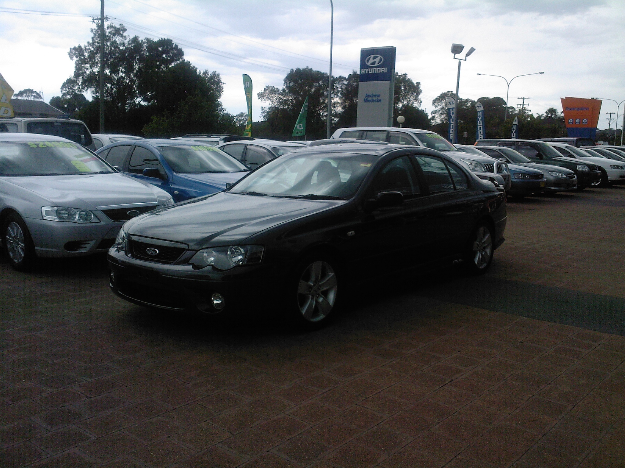

Jake27 Member 92 Member For: 16y 8m 26d Gender: Male Location: Port Macquarie Posted 18/12/08 01:25 PM Share Posted 18/12/08 01:25 PM (edited) Hello, I'm picking up my XR6 tomorrow and I'm trying to figure out a few things when it comes to mods.I'll be doing a dyno run from stock so we'll finally know what they produce standard.Then getting some PH4495 or 4490 (which one? I don't have plans to super/turbo this thing), a new exhaust system and some kind of CAI.What would you recommend for the CAI?I've read a bit on here that the F6 snorkel is good, are there any better options?Also I'll be getting a K&N filter and then running a dyno tune and we'll see how it's progressing The next plans will be fitting the push button start, GT wing, maybe the GT bonnet, cams and the underdrive. Edited 18/12/08 01:37 PM by Jake27 Link to comment https://www.fordxr6turbo.com/forum/topic/52665-2007-bf-mkii-xr6/ Share on other sites More sharing options...
