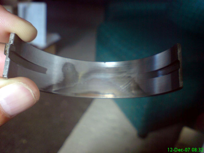

straughsberry Donating Members 1,846 Member For: 17y 10m 5d Gender: Male Location: Broady, Melbourne Posted 30/11/08 03:46 PM Share Posted 30/11/08 03:46 PM It was 30 mins with a generic tune. A back fire here and a back fire there, there a rod, here a rod, everywhere a rod rod...But it was not the generic that killed it. Check out this crank bearing from a 55k old motor.Every single bearing was similar with most down to the copper. There was no ping and that is not a ping pattern. And even if there was, there aint no way 30 mins of ping will do that to every single bearing. More likely it was a bad line bore. Now that is a pox build from Ford... Link to comment https://www.fordxr6turbo.com/forum/topic/52112-350-wheels-vs-320-wheels/#findComment-778174 Share on other sites More sharing options...
