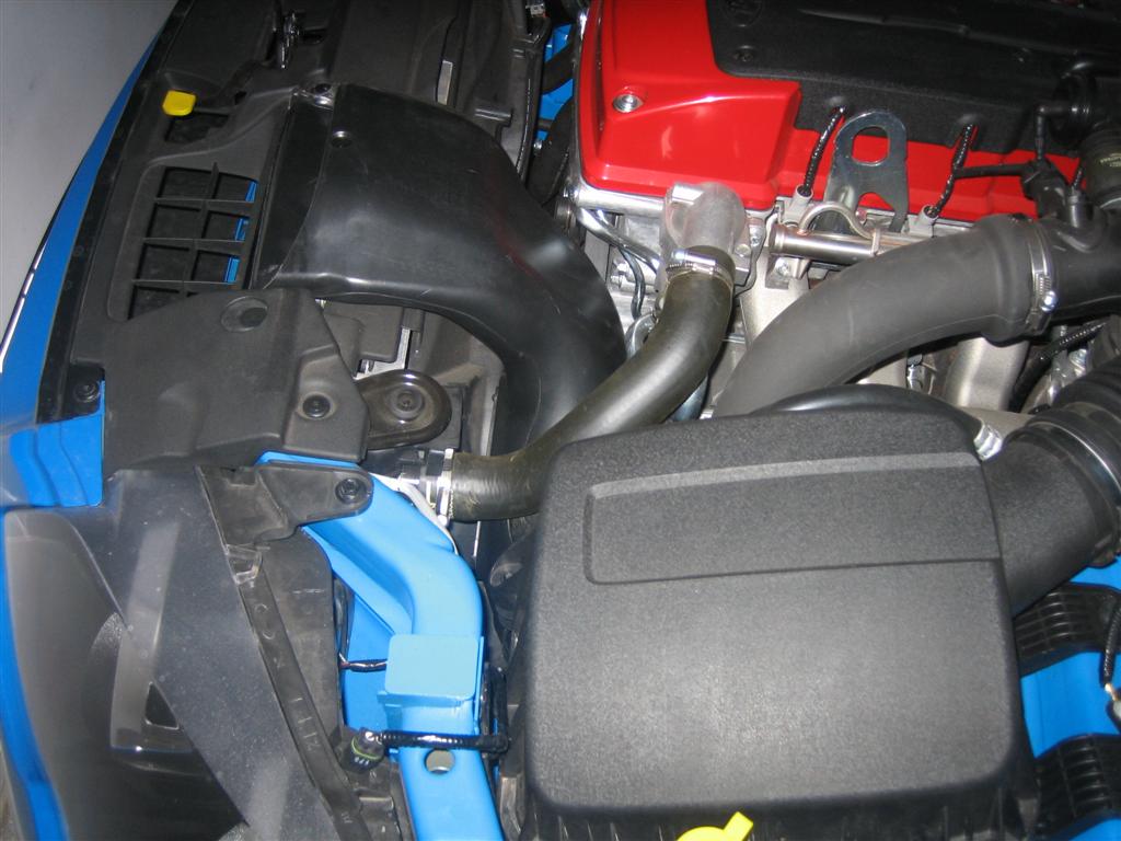

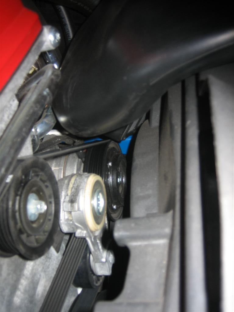

spic Donating Members 148 Member For: 17y 24d Gender: Male Posted 17/11/08 08:00 AM Share Posted 17/11/08 08:00 AM Thought I'd post some pictures up for the other members to see. Link to comment https://www.fordxr6turbo.com/forum/topic/51033-v8-airbox-lower-and-cai-pipe-fitted-into-f6/page/2/#findComment-769710 Share on other sites More sharing options...

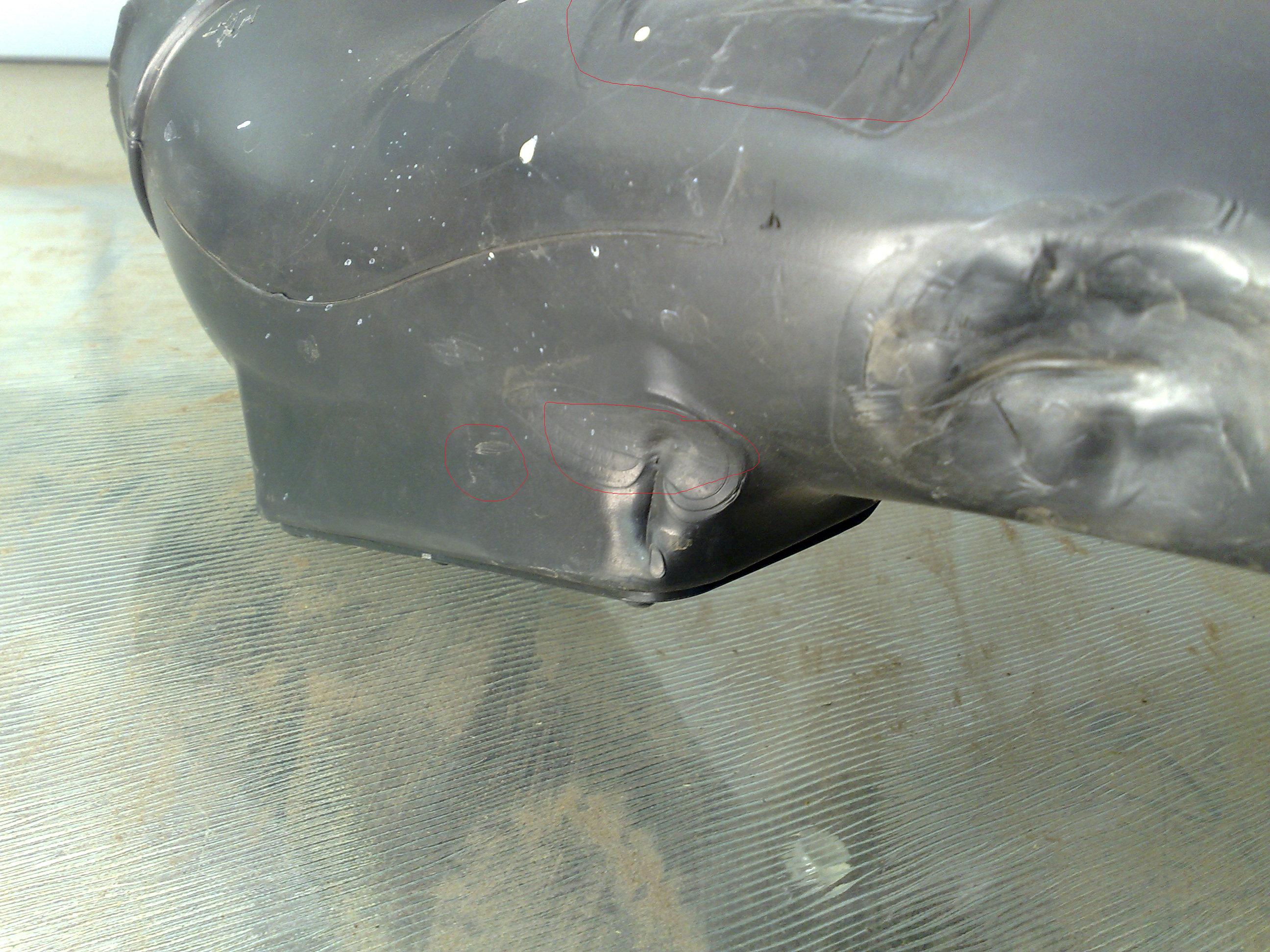

Benny Member 1,869 Member For: 21y 8m 29d Gender: Male Location: Newcastle Posted 18/11/08 01:19 AM Share Posted 18/11/08 01:19 AM Guys,What Phantmxr6 is saying about the belt chopping out the snorkle has happened on my car. I had to recently use a heat gun to re-mold the snorkle to make more clearance. I'll post some pics of the damage to the snorkle from the belt soon.Benny Link to comment https://www.fordxr6turbo.com/forum/topic/51033-v8-airbox-lower-and-cai-pipe-fitted-into-f6/page/2/#findComment-770049 Share on other sites More sharing options...

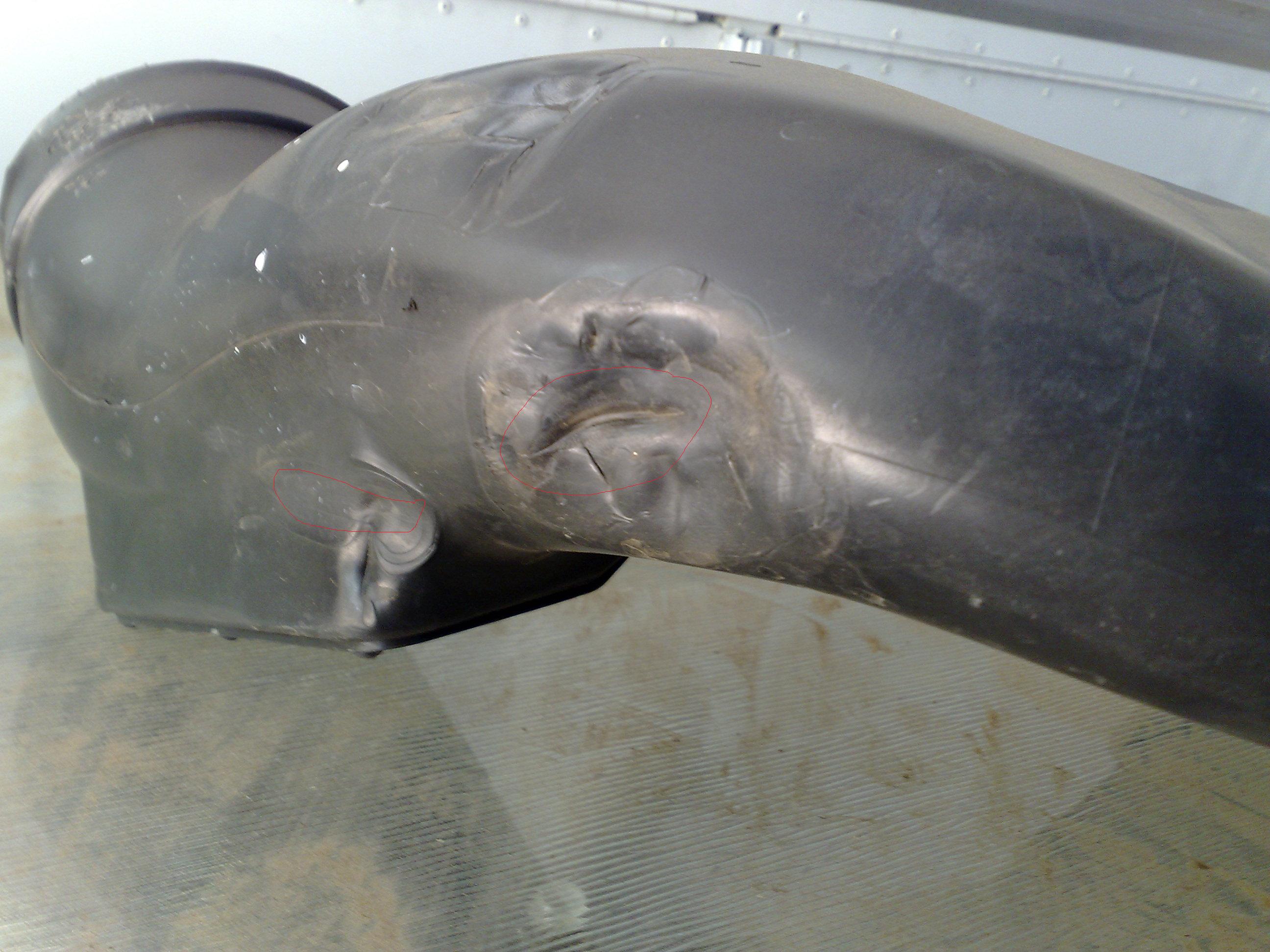

PHANTMXR6 It's not a MKI! Member 1,742 Member For: 16y 10m 16d Gender: Male Location: Earth Posted 18/11/08 04:46 AM Share Posted 18/11/08 04:46 AM Hey guys, here's a pic of mine.It looks ugly but it's functional and doesn't hit the belt any more.I've circled the positions on the snorkel that the belt has touched and are now clearanced.I've also circled a section at the top of the snorkel that needed doing as well. It was touching the heater pipe that came out of the thermostat housing. Link to comment https://www.fordxr6turbo.com/forum/topic/51033-v8-airbox-lower-and-cai-pipe-fitted-into-f6/page/2/#findComment-770120 Share on other sites More sharing options...
Benny Member 1,869 Member For: 21y 8m 29d Gender: Male Location: Newcastle Posted 18/11/08 09:18 AM Share Posted 18/11/08 09:18 AM Ok here are some pics. Not saying that this will happen to all cars with this snorkle but is definately something to keep a close eye on.Benny Link to comment https://www.fordxr6turbo.com/forum/topic/51033-v8-airbox-lower-and-cai-pipe-fitted-into-f6/page/2/#findComment-770384 Share on other sites More sharing options...
PHANTMXR6 It's not a MKI! Member 1,742 Member For: 16y 10m 16d Gender: Male Location: Earth Posted 18/11/08 09:46 AM Share Posted 18/11/08 09:46 AM Thanks Benny. I'm not going mad.Yours is in the exact same spot as mine. I think I might have caught mine a bit earlier than you though judging by your pics.Mine looks a bit ugly due to having to mould it back in slightly for clearance. It's not as pliable as it looks either.My only concern now is where it rubs on the cold side of the intercooler tube running up to the throttle body.I'm thinking of putting some soft foam or some other material in between the snorkel and the tube to try and minimise chaff. Link to comment https://www.fordxr6turbo.com/forum/topic/51033-v8-airbox-lower-and-cai-pipe-fitted-into-f6/page/2/#findComment-770408 Share on other sites More sharing options...
